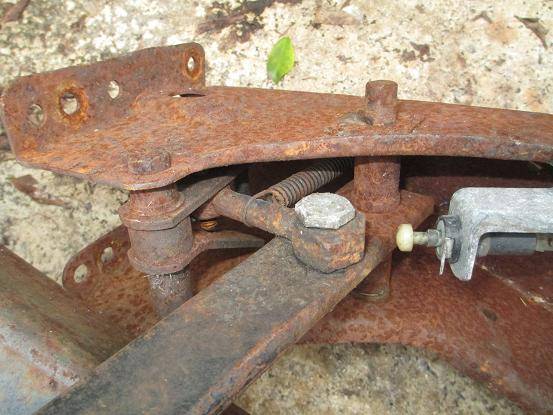

If it is the spring for the brake pedal linkage on a power brake application it clips onto the pedal linkage push rod on one end and to the top of the brake pedal metal bracket on the other end. As Leo mentioned a pic would be good so we know for sure.

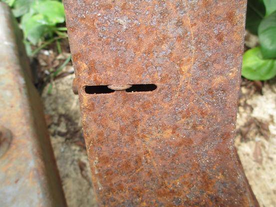

Here are 2 pics of what Moparts is explaining.

Thanks again for your help, I'll give this a try as per your pictures.
