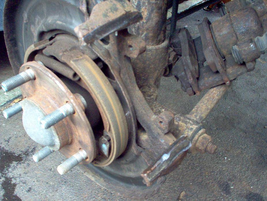

I'm posting a pic of the rear anchor on my wife's co-worker's car, all cleaned and lubed, ready to go back together, just for reference. It's the left rear of an '02 Intrepid, but pretty typical for any brake anchor:

You are correct in saying that all the contact points need to be cleaned. When I was a mechanic, I made sure to wire brush all the contact points when I had it appart. We never used a brake silicone but did use Antiseaze. I never had a comeback from using it. Once in a great while you would have someone come back with a brake issue but it was related to a colapsed brake hose. I've taken brakes appart years after replacing the pads and the Antiseaze is still in place. Some of it will rub off but a thin film will stay behind and keep the contact points from continuing to rust.

Glad you have good experience with anti-sieze. I never have. Working in upstate NY the road salt seems to do a number. I think you'll agree with the point I was trying to make: keep everything clean, keep everything lubed, and keep good brakes.
