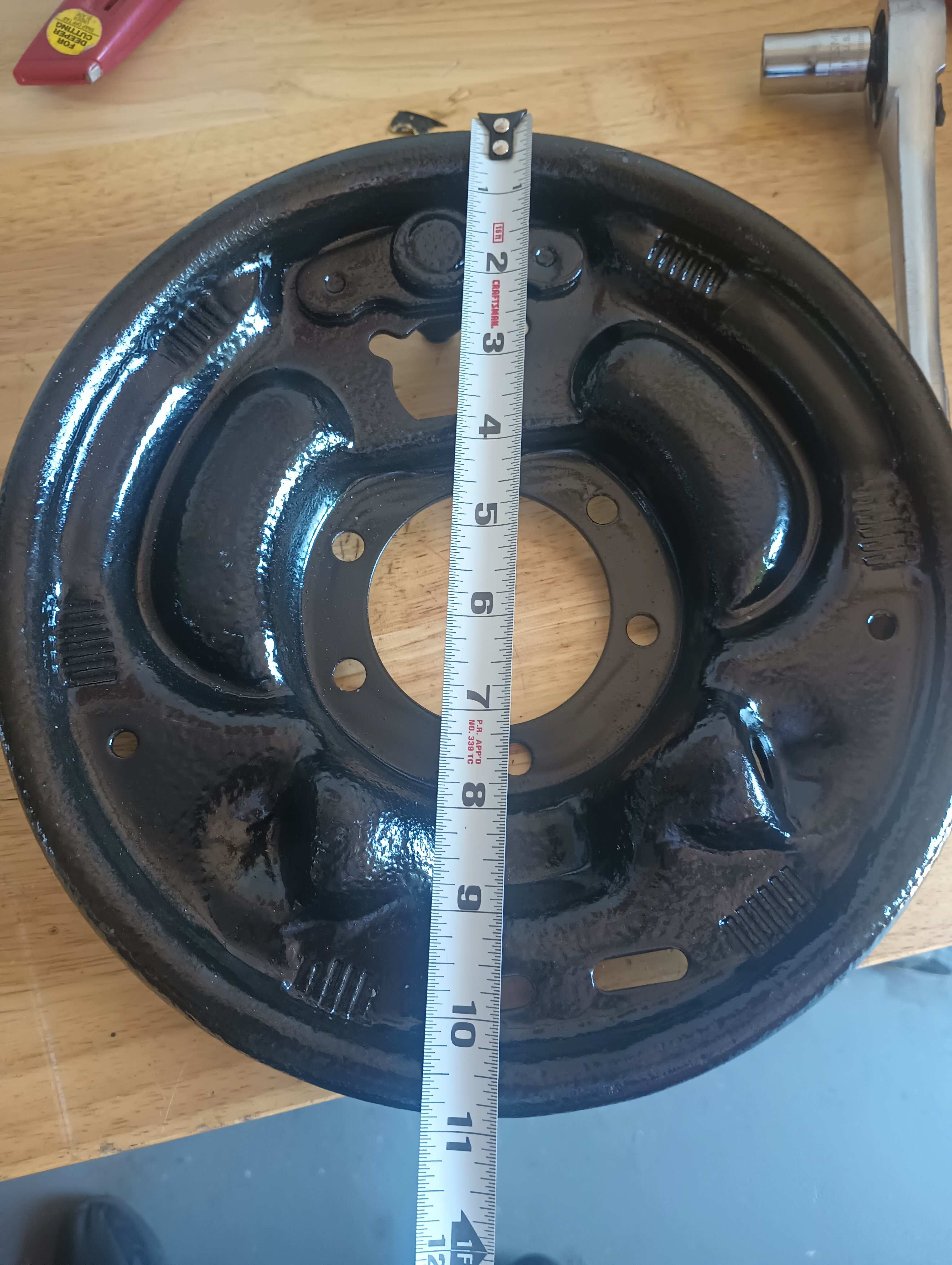

I was wondering if this is a 10 1/2 inch brake backing plate for my 8 and 3/4 .. I know they make 11's

Ok I want Shure how to tell the difference... I have a a body 8 3/4 going in my duster and need 10.5 drum set up for my large bolt axles

I am working on 74 Cuda back brakes with 10 1/2 shoes, and the backing plate outside diameter is around 10 7/8".
Okay cuz I think that's what these are 10 and a half inch drums which I think are the same drums I have on my 74 Challenger... I have an extra set that I'd like to put on my duster cuz I'm converting to large bolt pattern

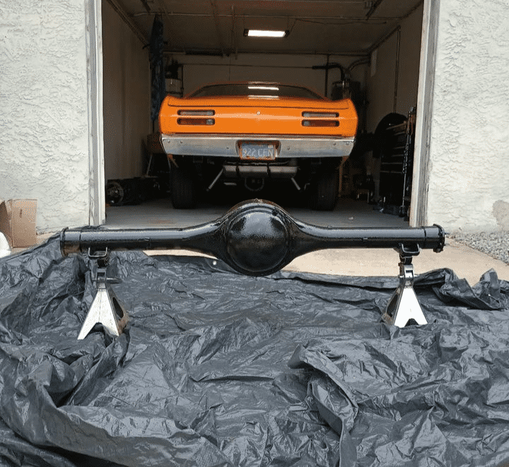

I am getting ready to build a 8 3/4 for my Plymouth duster ( I had some extra backing plates from my Challenger) conversion to large bolt pattern new axels extra
