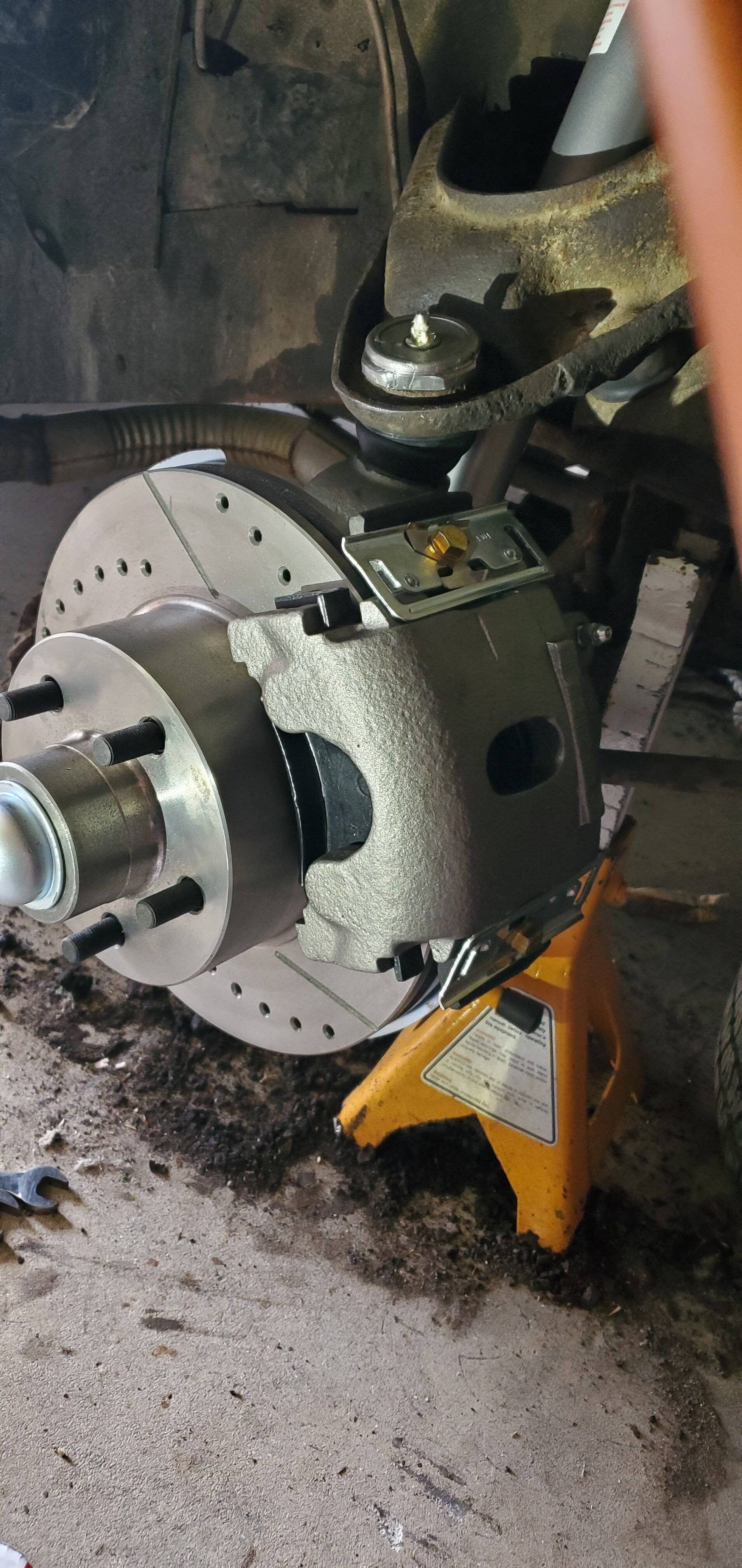

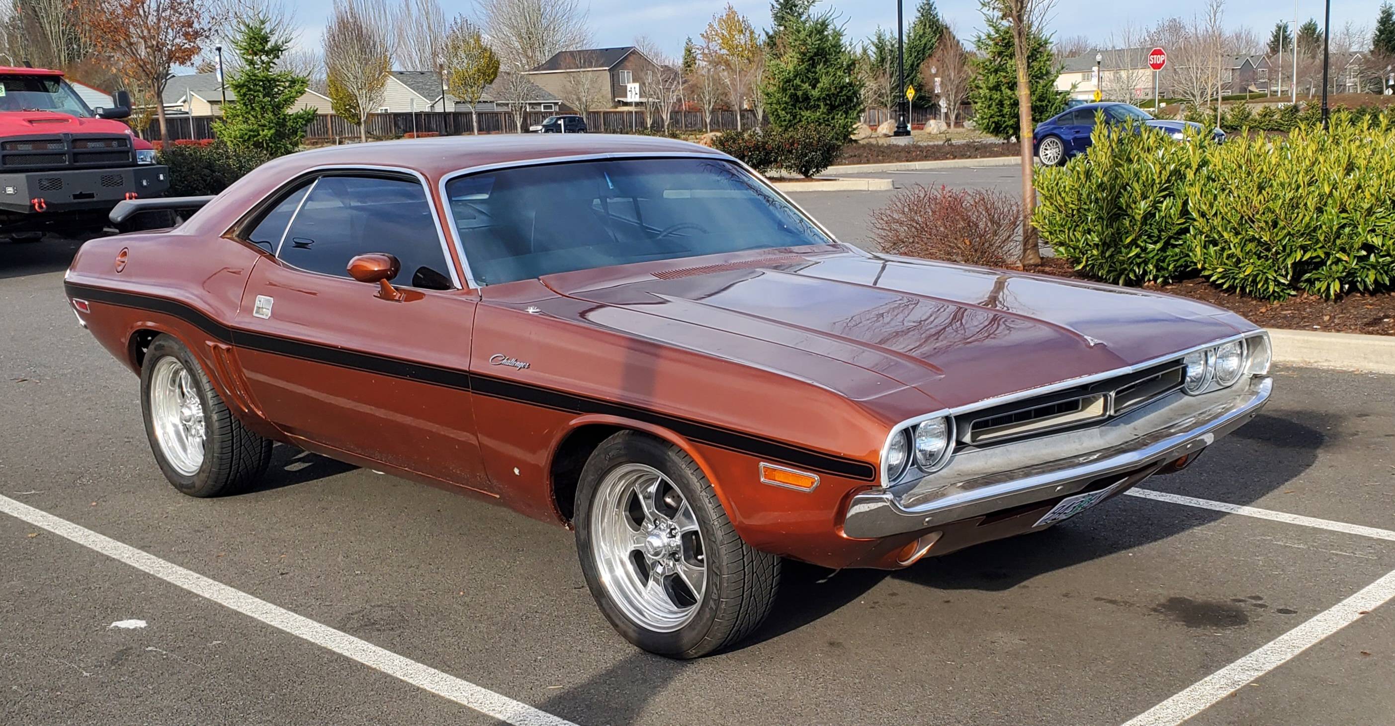

My challenger started life as a base model from the factory. From the factory, it came with a 318 automatic, column shift, manual brakes, manual steering, 2-speed windshield wiper motor, drum brakes all around, and no AC. When I purchased it, in 2019 from Springfield Oregon, it had 383 under the hood with a 600 CFM Edelbrock carburetor and a floor shift installed. It was missing some minor items under the hood and needed the brakes redone.
This has been completed already
  • Brakes completely rebuilt and upgraded to 11" drilled and ventilated rotors up front
  • rear differential rebuilt and the replaced the broken Sure Grip with an Auburn locker with 4:10 gears
  • Replaced the Manual steering column/column shift with a power steering gearbox and floor shift steering column
  • Rebuilt the upper and lower control arms, and all steering linkage
  • Rebuilt the motor (due to 3 bad cylinders and cross drilled heads.
    • Stroked the motor to 438 CI
    • installed aluminum heads and dual plane intake
    • Installed the Holly Sniper unit with distributor control
  • Replaced radiator with a 4-core aluminum unit with electric fans.
  • Replaced all rubber seals
  • Rebuilt the regulators for doors
  • Installed the reservoir and motor for windshield washer fluid with the new control knob
Still in the works currently
  • Power brakes
  • 3-speed windshield motor and linkage
  • Power window setup for all four windows
I will eventually get it sent off for all the body work and rust repair to be completed, but right now I just want to drive it. lol.
