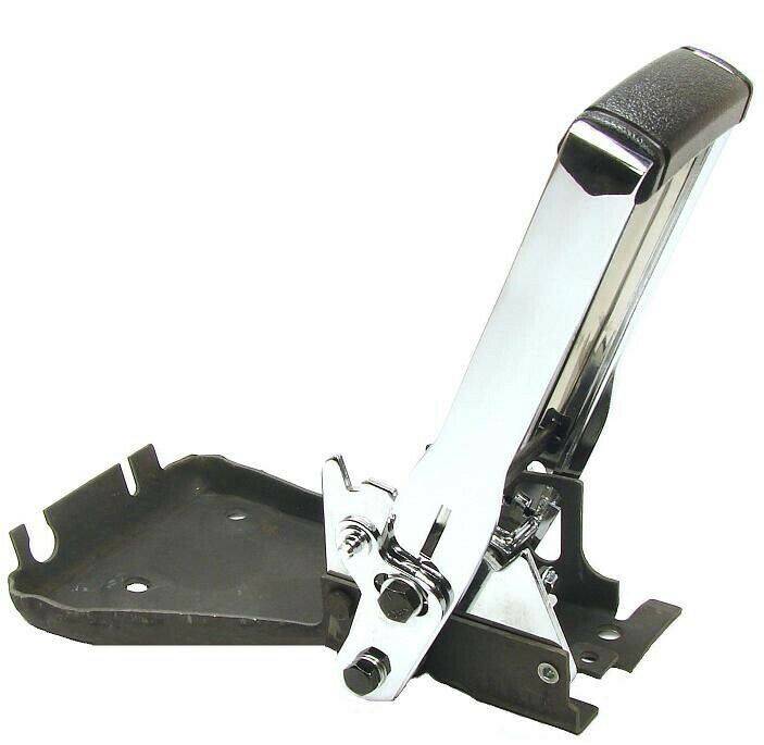

I remember driving a few shipmates Bow ties that had it.Looking at the picture there is a cable that goes in the front rounded slot. it then would go to the the transmission with an a accompanying mount and slot. the exposed ends of the cable would have to a range a motion to shift. You may have to modify a trans shift lever for the correct length.
Just taking an experienced guess at it.

Dodge pickups 66 through 68 used a dash mounted shifter with a single cable. The transmission end of the outside sheath for this cable is mounted in a bracket that bolts to a cast in boss on the side of the bellhousing. Clamping the Chevrolet shifter cable (several variations of this shifter depending on the model and year of the OEM application- Camaro, Chevelle, Impala, etc.) into the Dodge pickup bracket or fabbing up something similar to use with the GM shifter is very do-able.
Modifying the notches on the shifter mounted shift comb in the GM shifter or making up a replacement from mild steel plate to match what the MOPAR transmission needs to shift properly should not be difficult at all.
I would think adapting it into a Mopar console and making it look like it grew there would be the greater trick.
