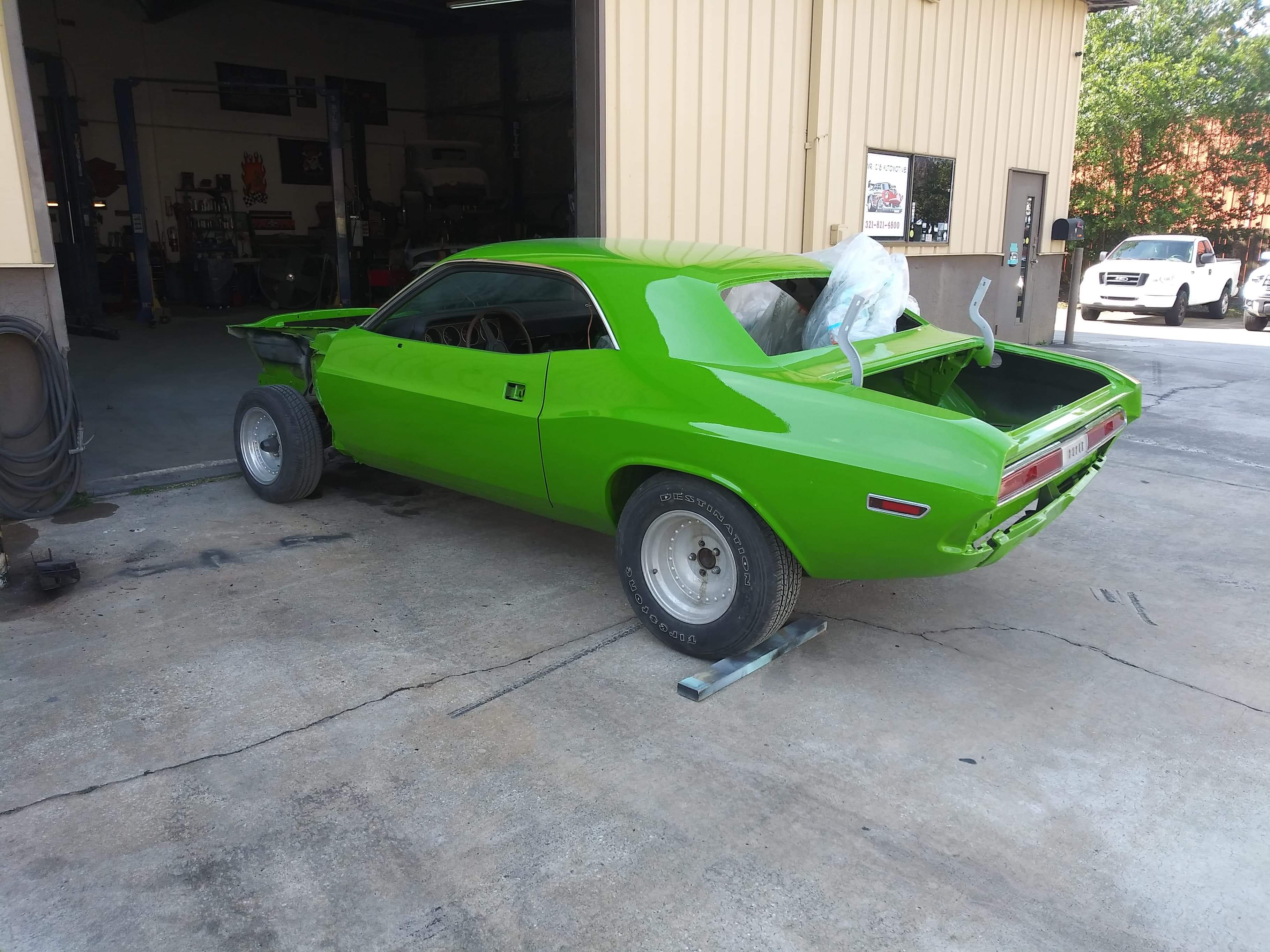

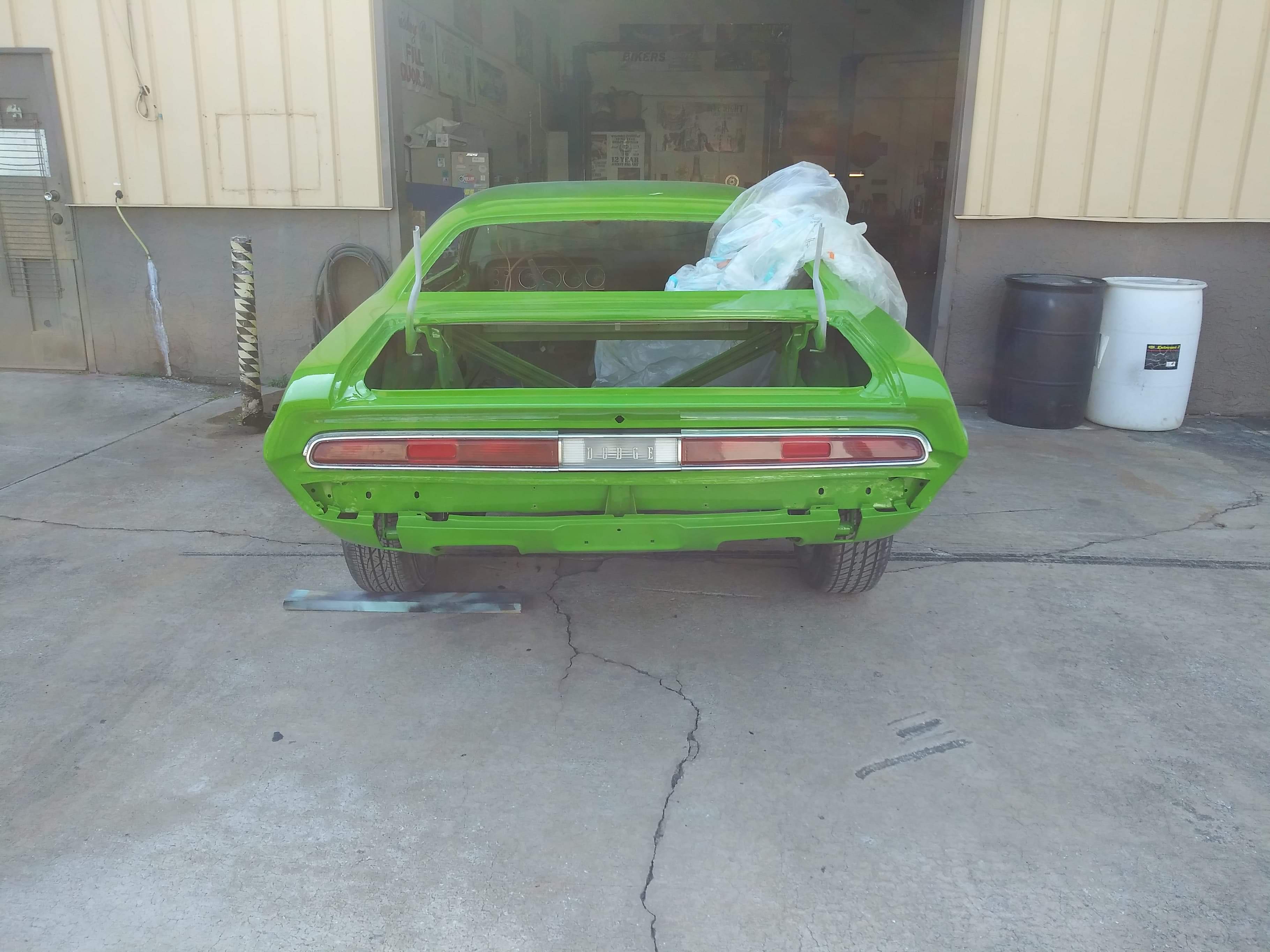

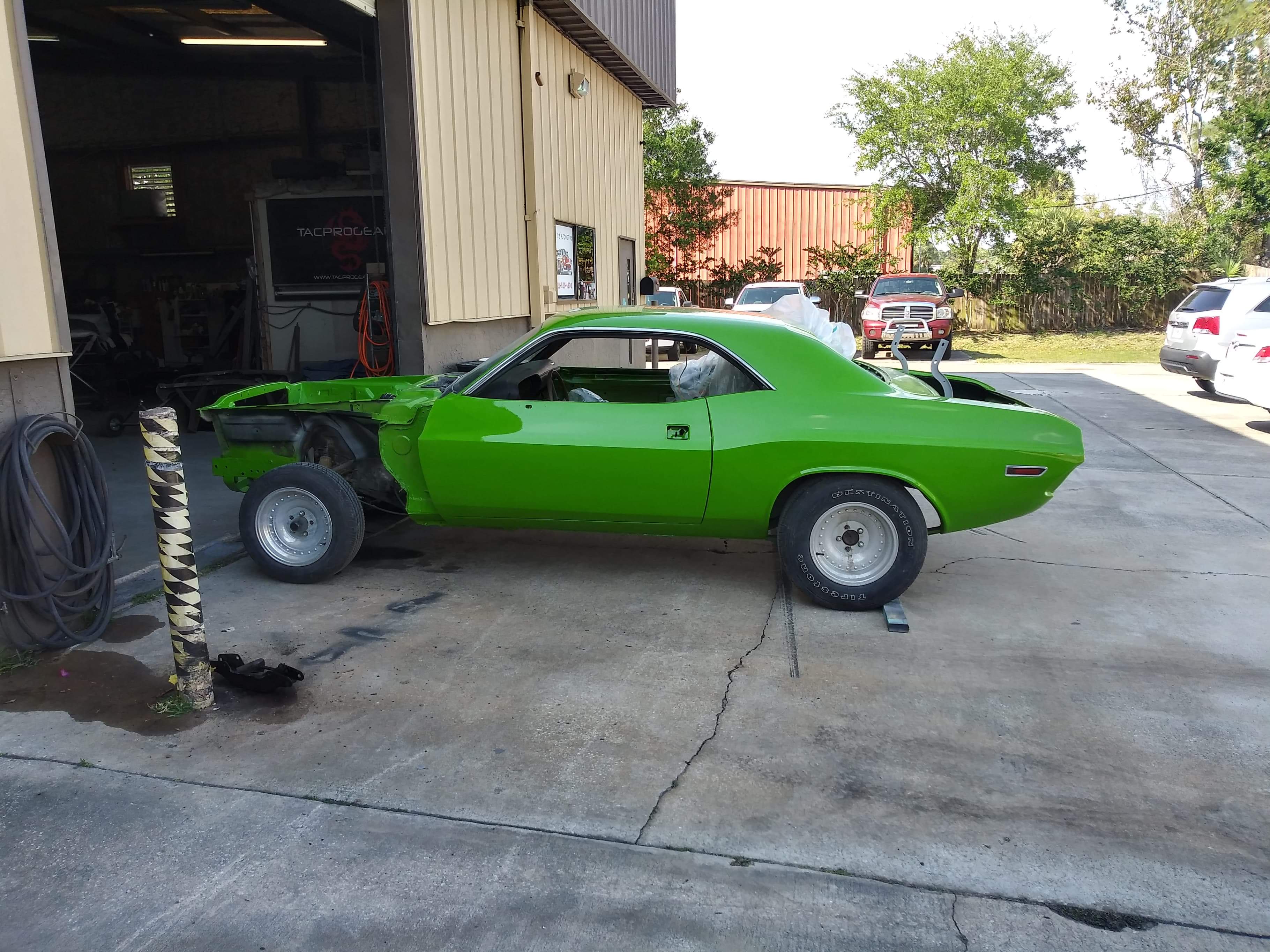

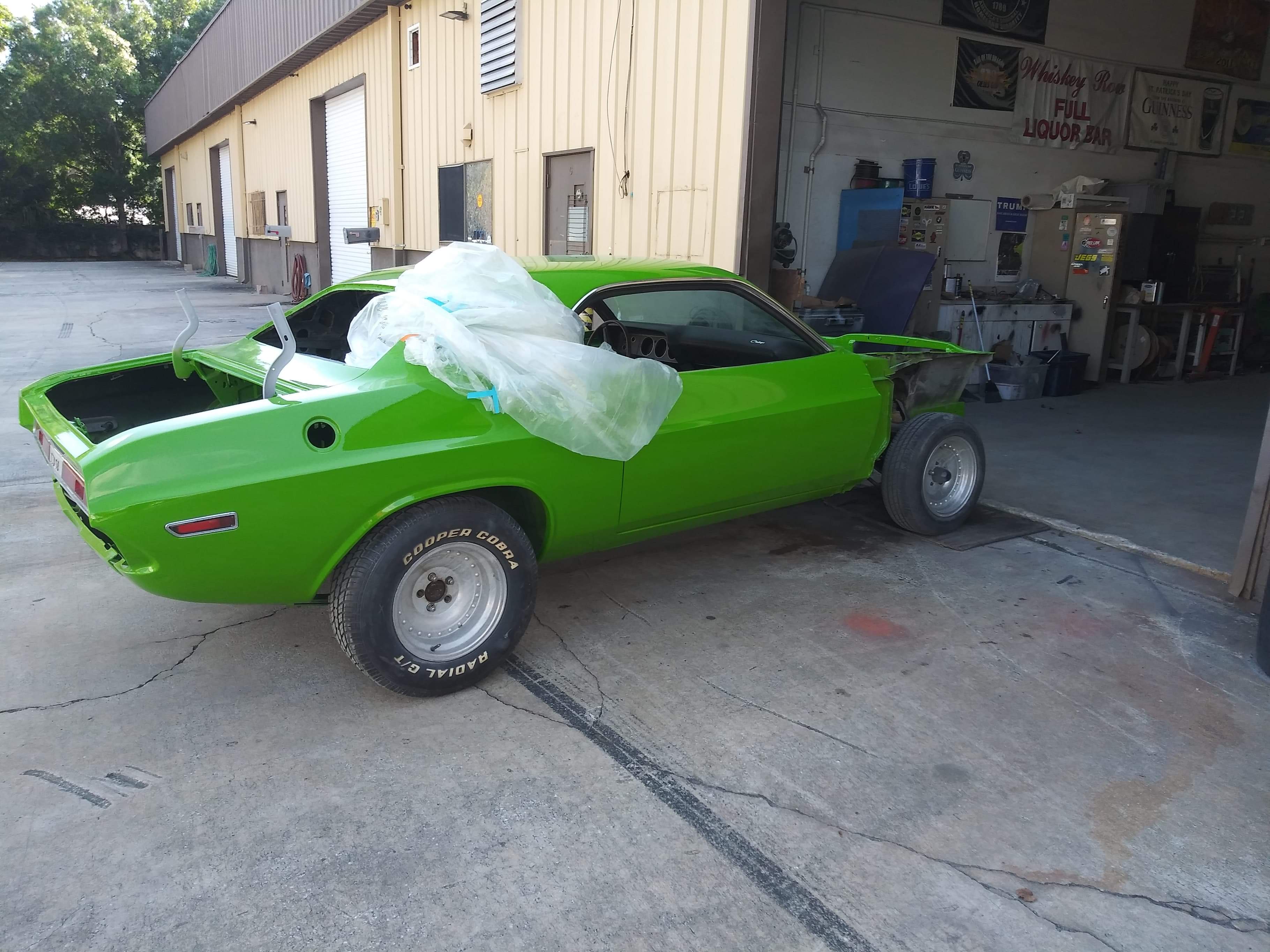

This is a 73 I used to own. It basically was a parts car. Another guy I know bought it and has converted it. He has a lot of time in it.
