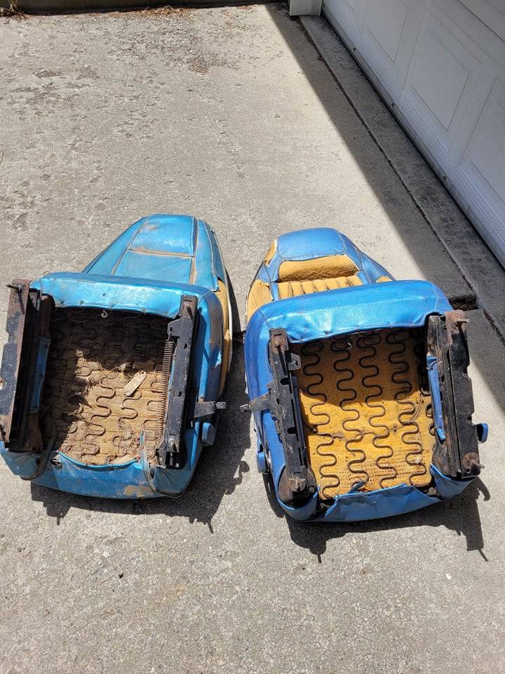

I acquired some bucket seats a while back in a trade, and wasn't able to see them before they were delivered. They were supposed to be A Body seats, but obviously are not. One is from a 70 Charger, and one is 70 or 71 Challenger.
What I am trying to figure out, is what tracks these are actually for, so I can sell them with good information. They aren't A Body, and that is all I'm certain of. If someone that is familiar with E Body tracks could take a look at these pictures, and let me know, I'd appreciate it.
Thanks.

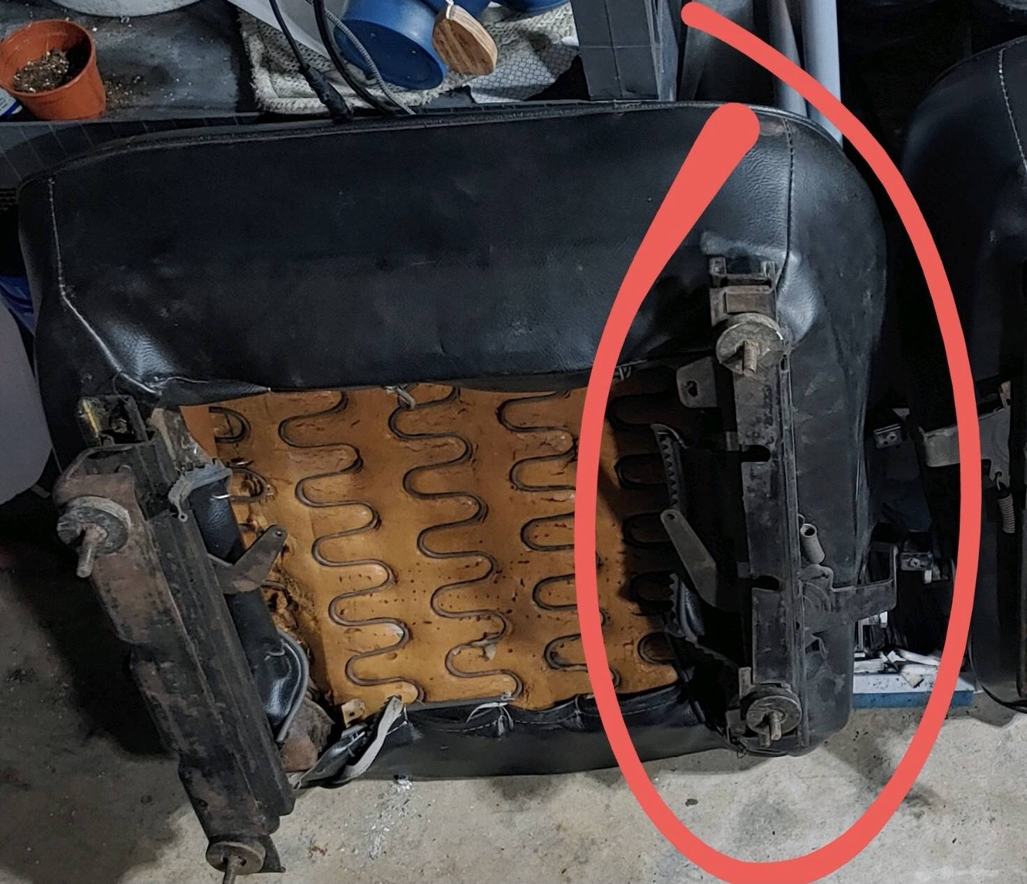

There’s a guy on Forabodiesonly that is trying to figure out was he has. He sent me pics of what he has and they look very similar to yours. He bought them believing they would fit a 72 Demon but they do not.
I am pretty sure those are E body/71-74 B body.

So are those outers (with the seat adjust handles) later style e-body? My 70-71 e-body tracks are different. And those inners aren’t 70-71 e-body for sure.
