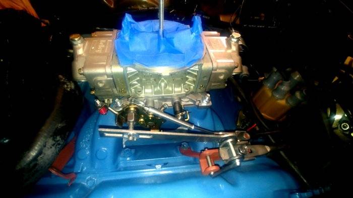

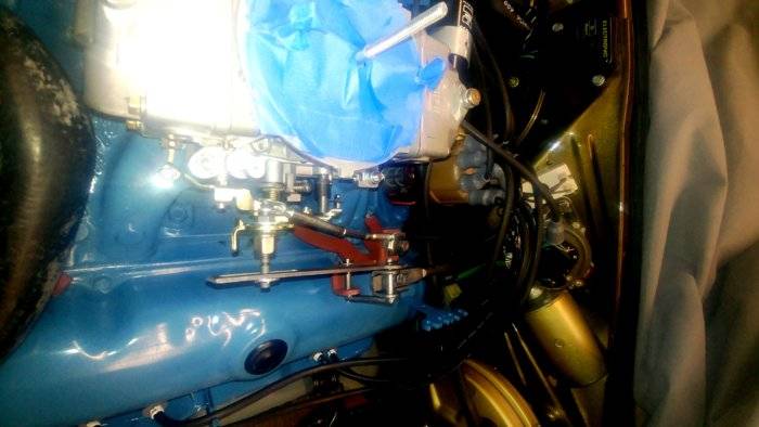

I want thank everyone for the help. Maybe you all can help me with a bigger problem. My throttle linkage does not line up with the carb. The set up on the top half of the 340 is a Edelbrock Air Gap intake with a Holly carb. I can't use an aftermarket throttle bracket because of the trans. kick down rod. See pic attached.
