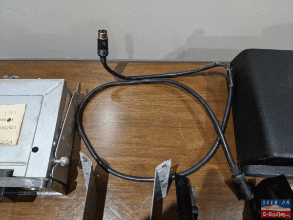

Either an AM/FM radio or an AM radio, but either way, they must have the pigtail in the back of the radio that will allow you to hook the cassette deck to it. Those radios are a one year only model, 1971, of course. The deck does NOT swivel. it is anchored firmly into the console.

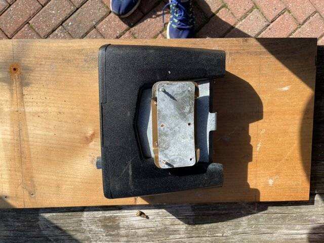

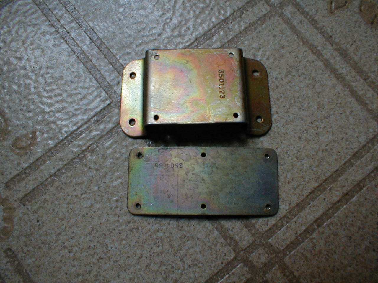

No, it is also slightly curved. I will see if I can find a few pictures and post them. There are two metal plates, one that attaches to the underside of the console, and the other on top of the console. If you have a console without the six holes from the factory used to mount i the deck, you will need to find accurate dimensions to attach the deck in the proper spot on the console.
