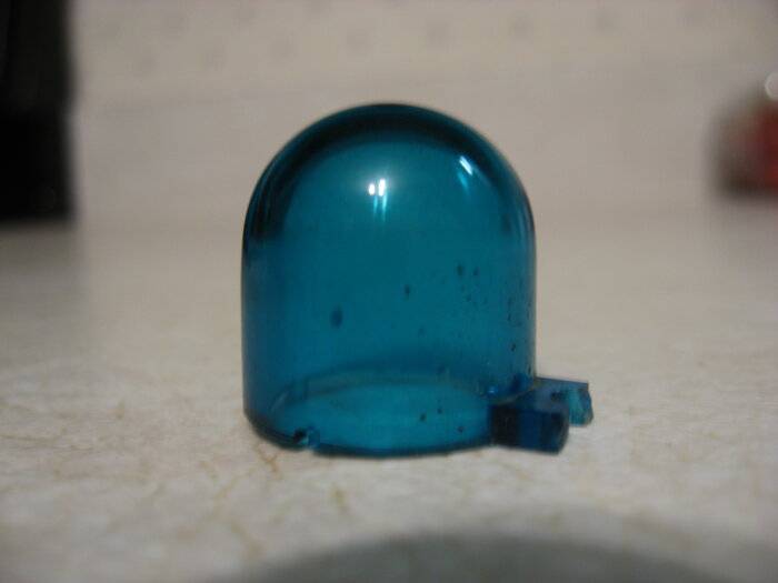

On your shifter assembly, do you still have this blue light bulb cover?

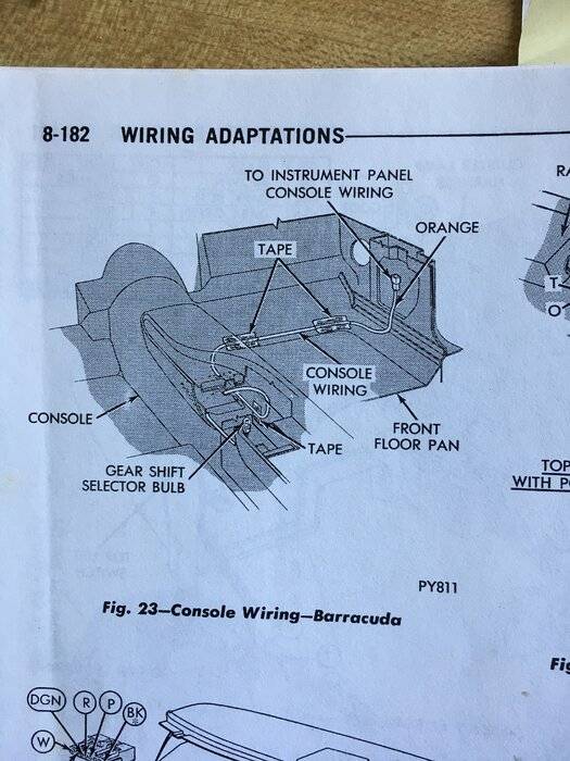

Here's a photo from the 1970 FSM showing the wire routing to the console on a Barracuda.
And here's a link to what I've been able to find [so far] as the best replacement blue 'dome' bulb cover for inside of your console shifter.....https://www.cjponyparts.com/blue-instrument-panel-bulb-lens-4-1964-1966/p/HW2201/
Your instrument panel light bar has colored plastic in front of white light bulbs, and the color 'diffuses' the bright white light down to a more eye pleasing level. Same with your gear shift selector. These new blue domes have a place for you to install a small screw or a nut/bolt through them and into the exiting hole in the selector assembly. Your light bulb then attaches behind/under the blue dome and the lighting at night looks pretty close to OEM.
