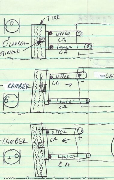

camber (2).jpgCamber is adjusted with the eccentric bolts on the upper control arms. You would need to rotate the bolts so that they offset is to the inside
