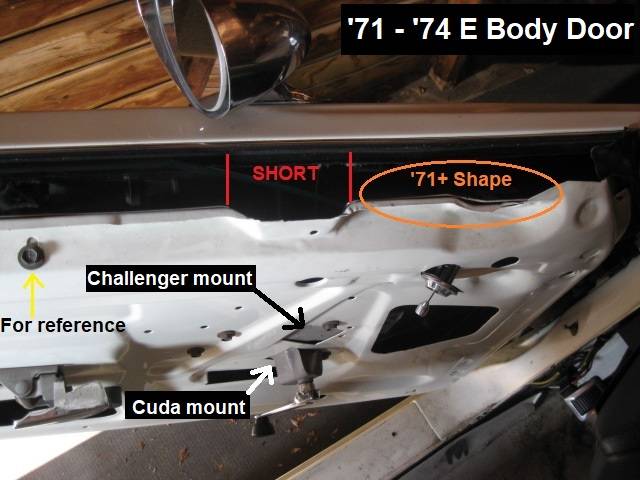

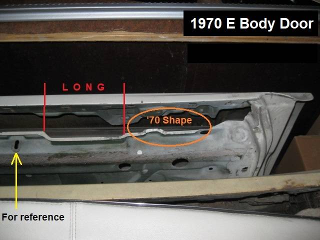

I have both types of doors, '70 and '71+ and tried my best to show the structure differences in the following pictures. The '70 is different to accommodate the different '70 manual window regulator.

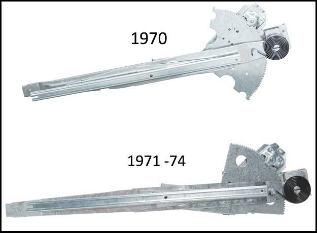

Manual window regulator differences. Because '70 has more teeth (bigger arc) that's why the '70 door frame has the "L O N G" cutout.
