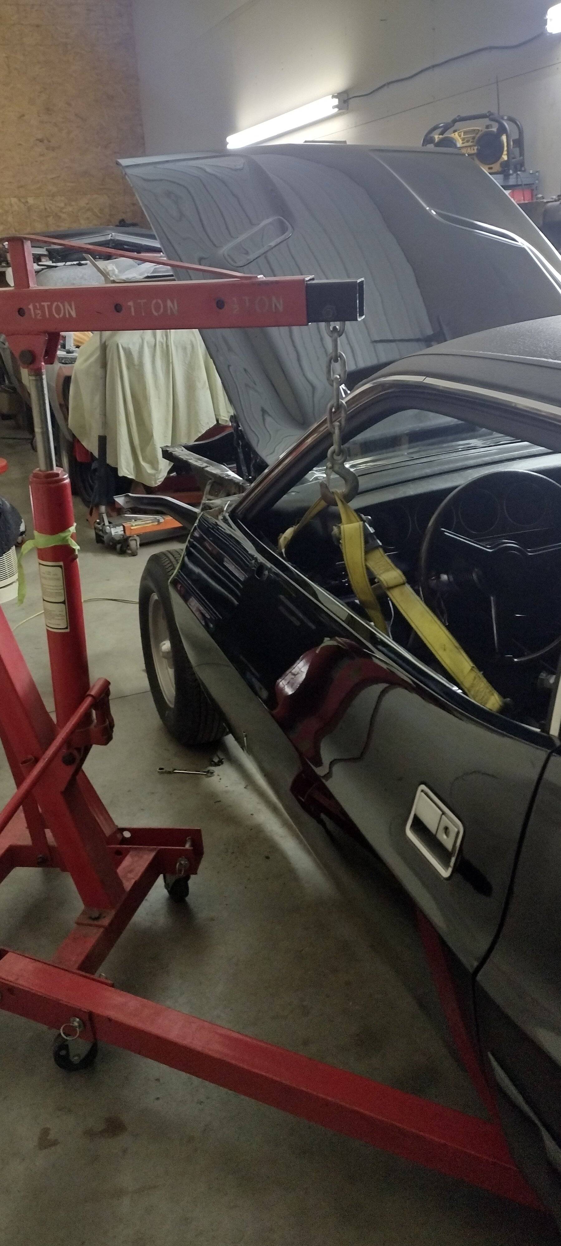

I used my hoist. 1 man job. I suggest that you take the upper/inner support brace off, align bottom and rear without the striker. Make sure that you have the windows in because it makes a difference and will sag if you don't. It's time consuming to get the fit right. Tape all edges so you don't nick any of them. 2 layers is better than 1. After you mount the fenders, be careful when you open the door fully to assure the gap don't bind. 1/4-3/8" worked well for me.

Wanted to add that I did lift the door about a 1/2" above the body line when the hinges were snug but movable. Took about 4 hrs each door till I was happy but the end result was very satisfying.
Good luck.
