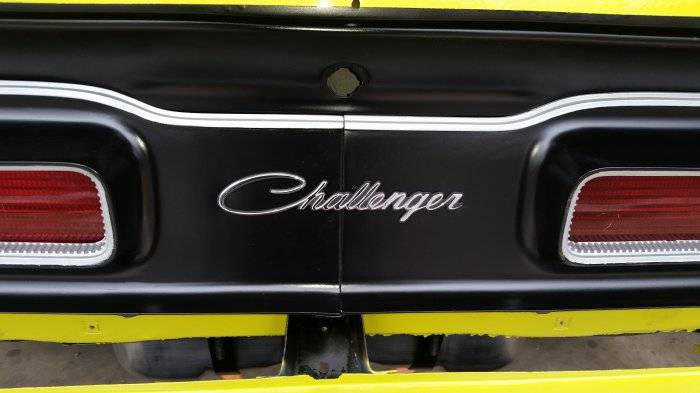

"Challenger " emblem for 71 tail light panel
EV2-70
Jun 22, 2016
29
8
I was unable to find a reproduction emblem made specifically for the 71 Challenger tail light panel. So I purchased a 3 pin emblem for the 70 Challenger front fender and re-drilled the center hole location on the tail light panel and it Worked out fine. The original center pin hole is covered by the emblem so there is no problems with doing it this way. I used the emblem from Trim Parts. Their part number is MP6060.
