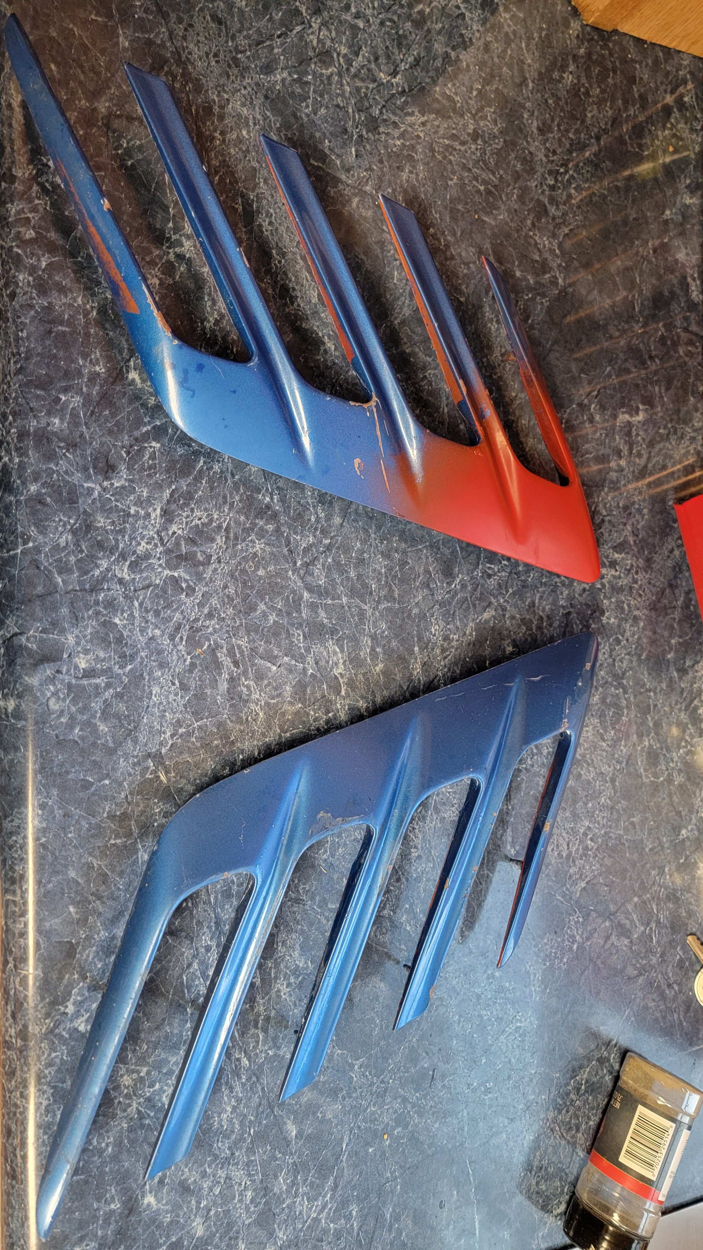

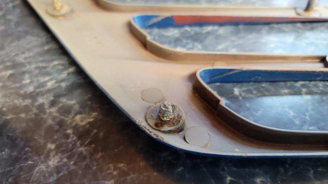

Friday at 7:55 AM #1 K Kevineng Active Member Joined May 6, 2024 Messages 30 Reaction score 29 Location Minnesota Any tricks to repair these studs on the fender louvers? Without welding? Also would be looking for another pair of louvers for my 73 challenger
Friday at 8:18 AM #2 Juan Veldez Well-Known Member Joined Jan 1, 2011 Messages 828 Reaction score 391 Location Nampa, Idaho You can try using JB Weld to secure a new stud. I've had success using it in similar situations. Create a rough, clean surface for best adhesion.
Friday at 8:21 AM #3 Challenger RTA Well-Known Member Joined Oct 28, 2018 Messages 3,905 Reaction score 2,044 Location PA Flood city Might be able to drill and tap for a smaller stud. And as john also said JB weld it also.
Friday at 9:12 AM #4 K Kevineng Active Member Joined May 6, 2024 Messages 30 Reaction score 29 Location Minnesota Im thinking those are my options, at least its only a few on each louver
