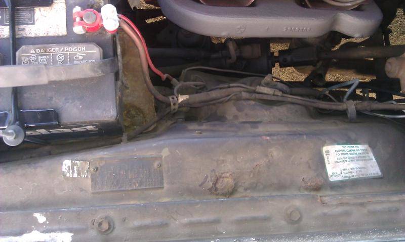

Dino2 (1).gifWhat year Challenger 340 is it? In 1970 the 340 cars would have an A66 on the fender tag/
The power bulge hood would normally have the metal emblems "340 four barrel".
Very early 340, 1970 Challengers (August through about November) had 340 four barrel decals that looked like the metal emblems with no holes drilled, but only the early cars came like this. Some early 340 challengers came with a flat hood (not to confuse the issue)
If a 340 car came with the power hood it should have the 340 callouts, regardless.

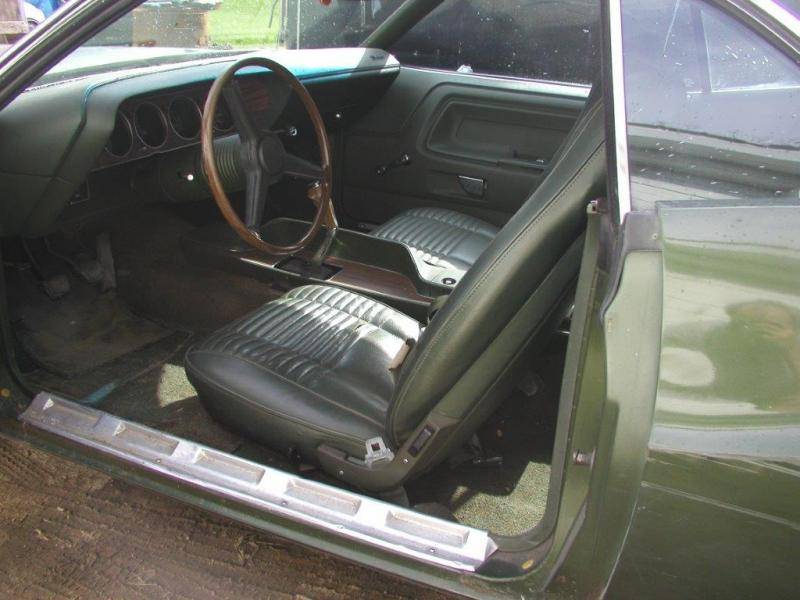

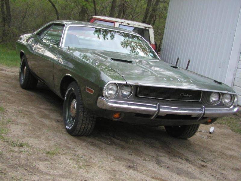

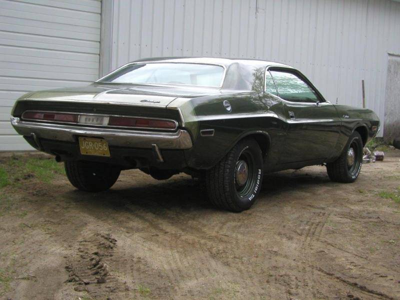

Here's a couple more. This car is an unrestored survivor car and I'm really liking it!
