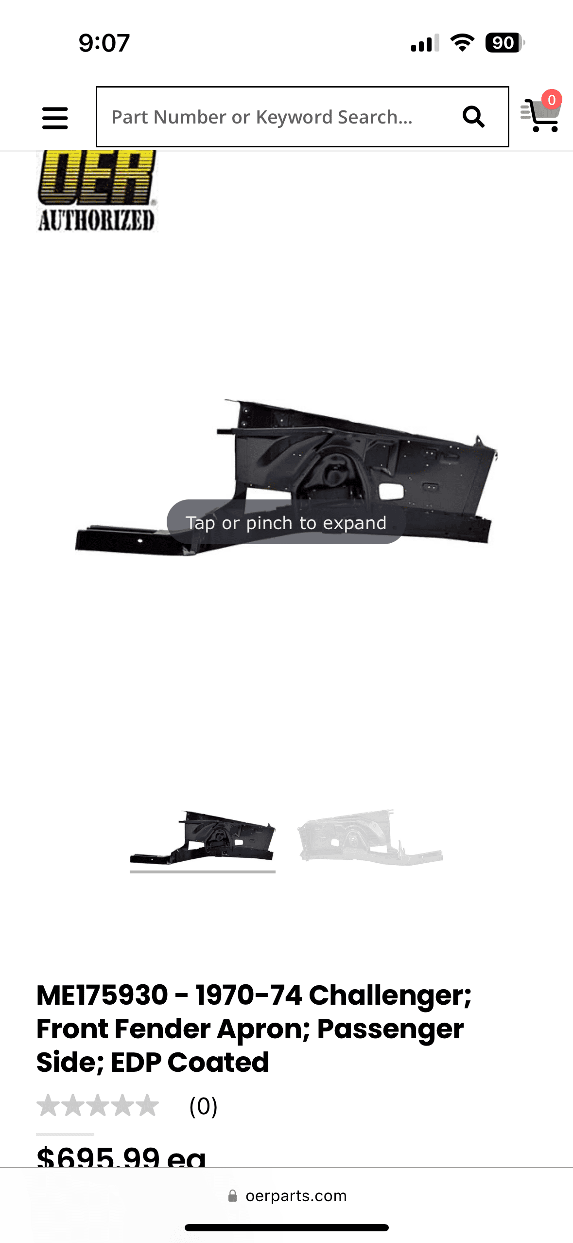

I’ve stumbled upon a part through classic industries that is made by OER. It is, as described in the picture, the inner fender and frame rail for a 70-74 challenger. I am replacing nearly the entire front end of my car. I can’t think of any reason this would not fit the Cuda I am currently restoring. If anyone has some different knowledge or opinions I would appreciate it before I pull the trigger on both the driver and passenger side part.

Yes, they are the same. The difference between them is the rear seat foot well floor pan is 2" long on a Challenger than a Cuda.
