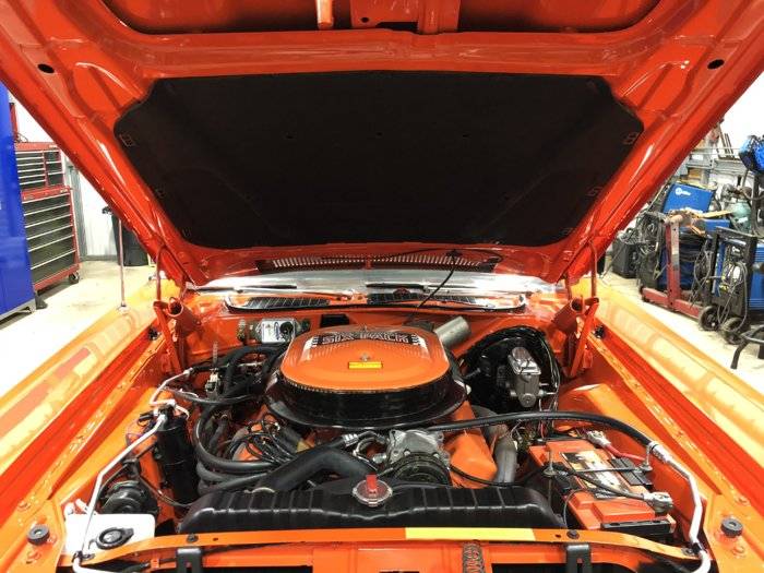

Here’s mine in a 70 challenger original 318 car but I put in the 440 six pack. Ordered off eBay about 100 bucks.
