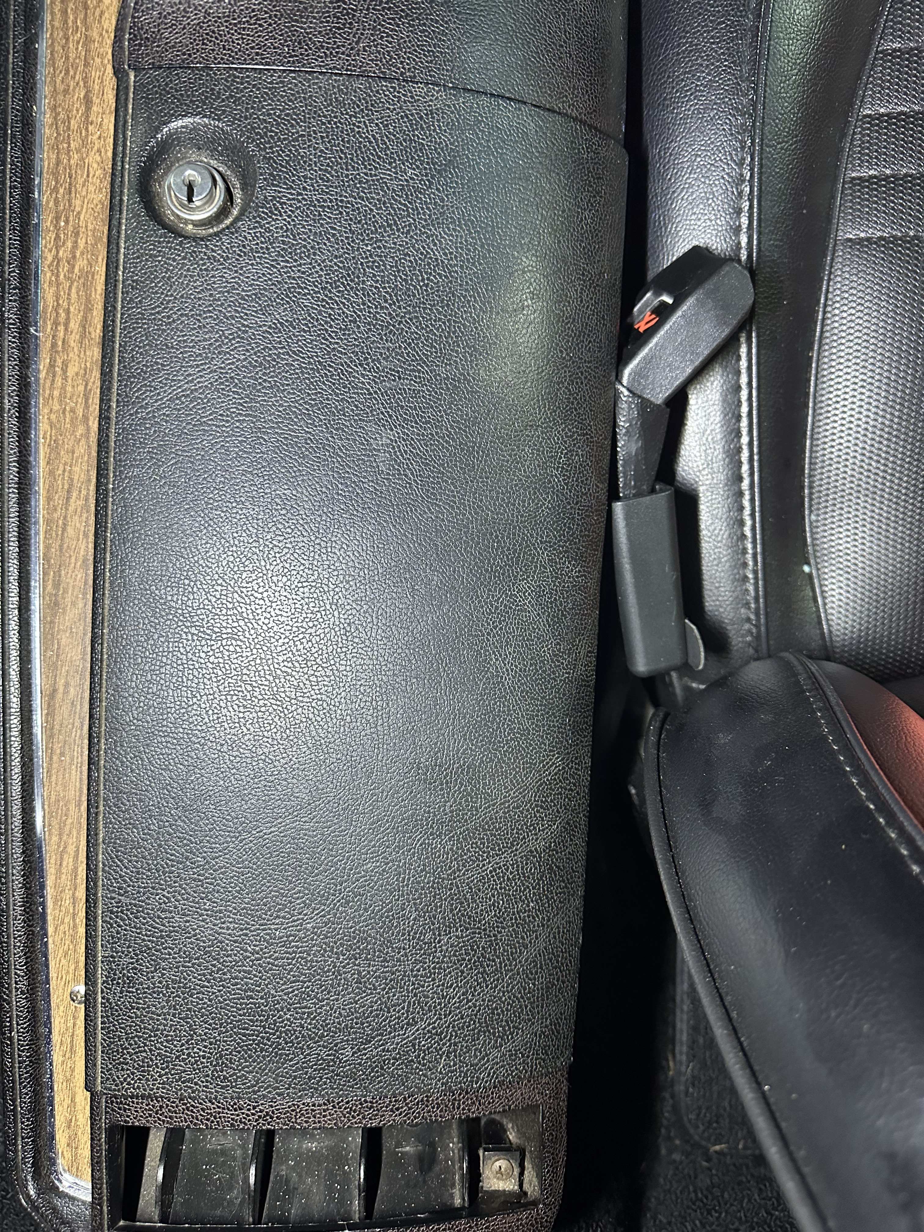

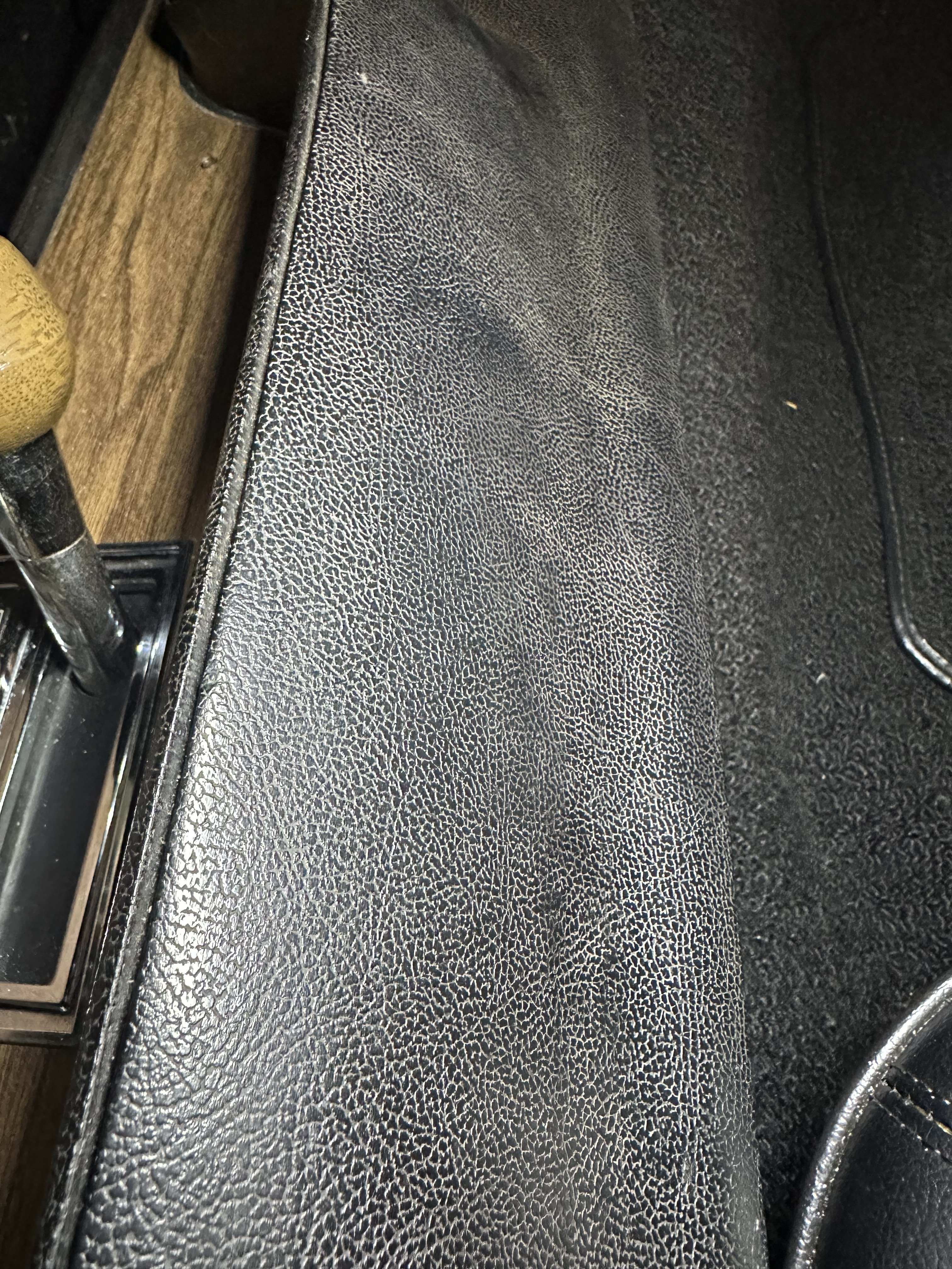

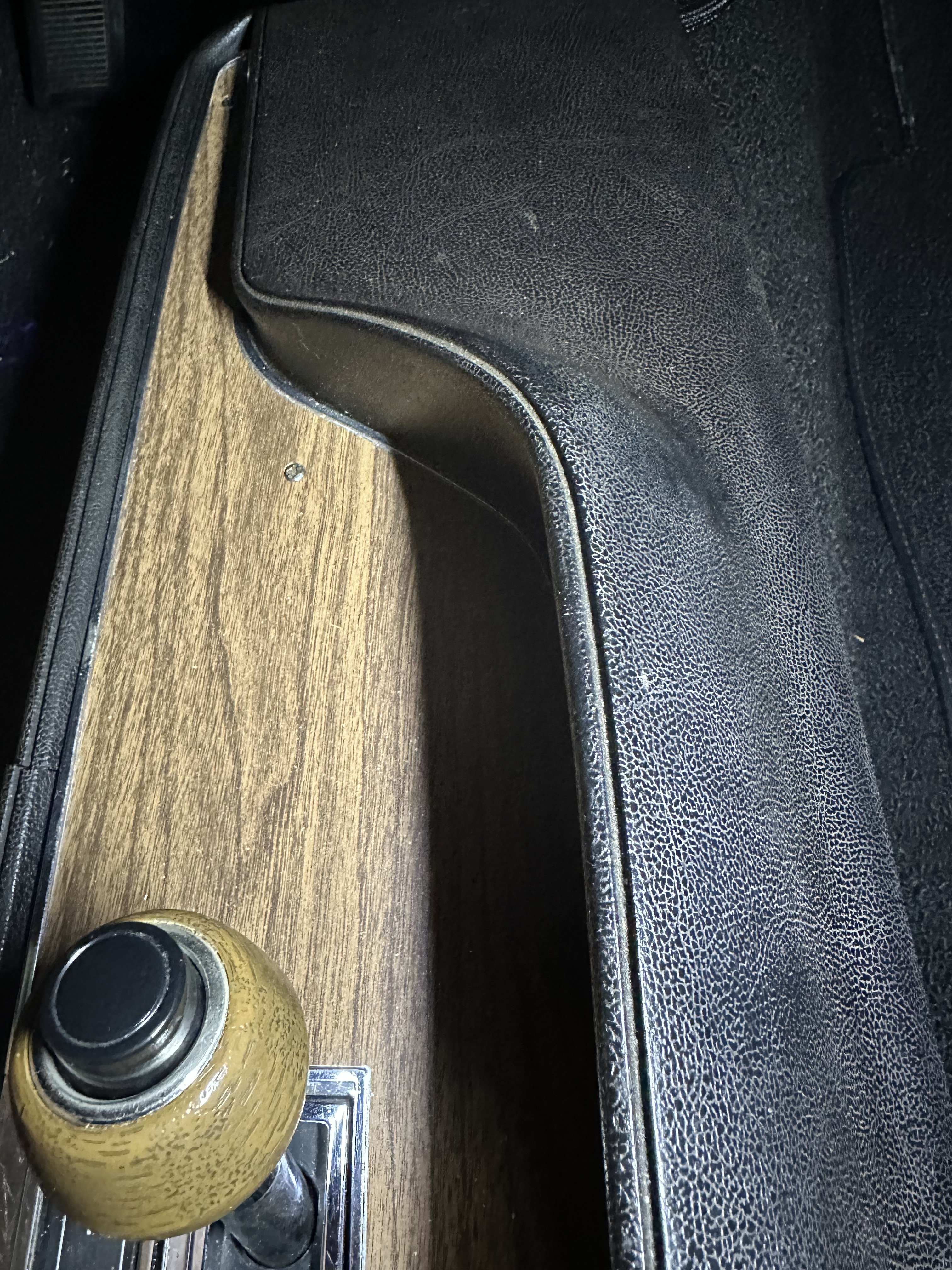

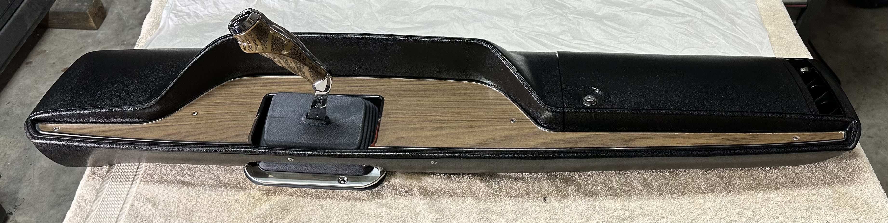

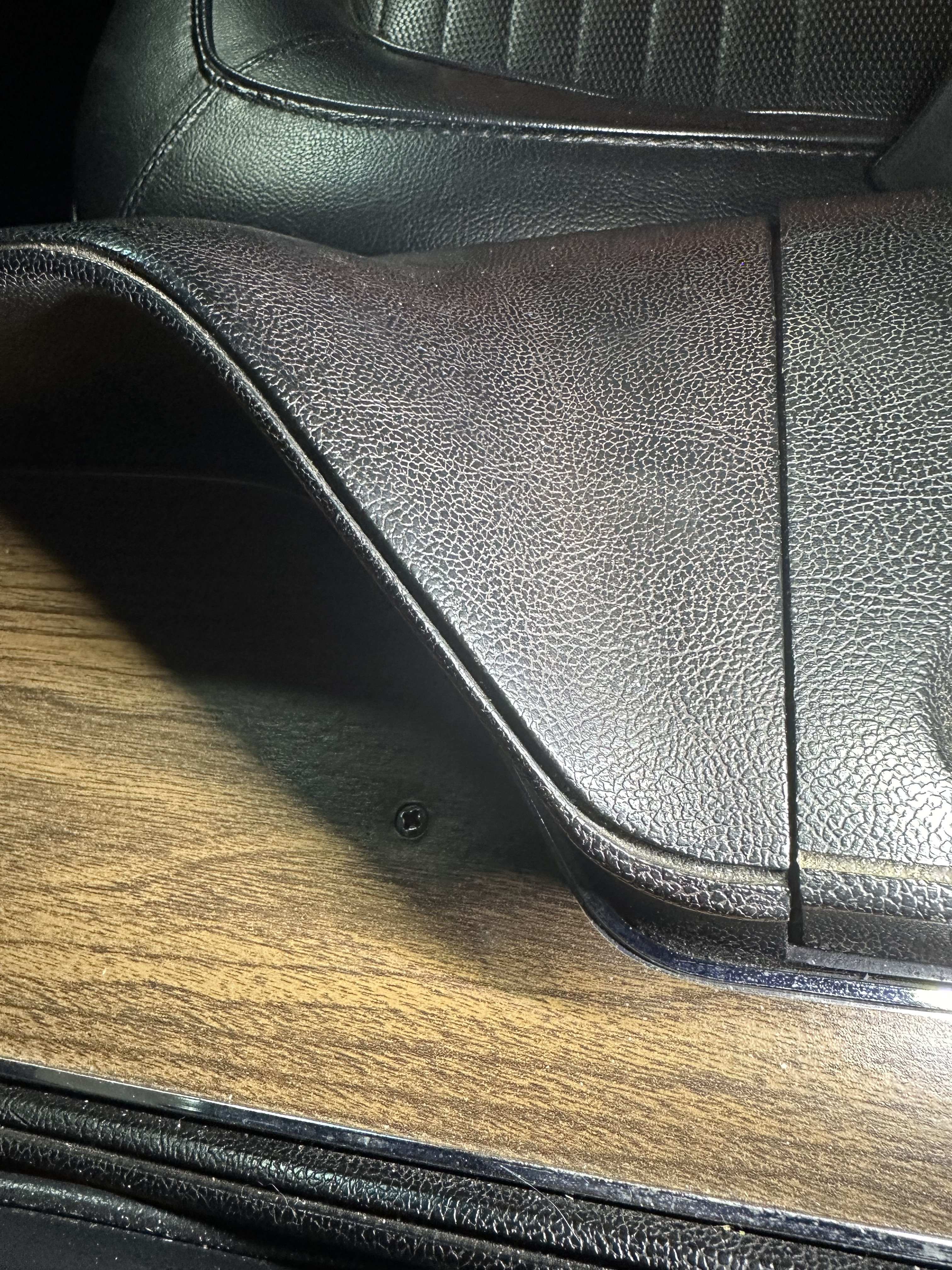

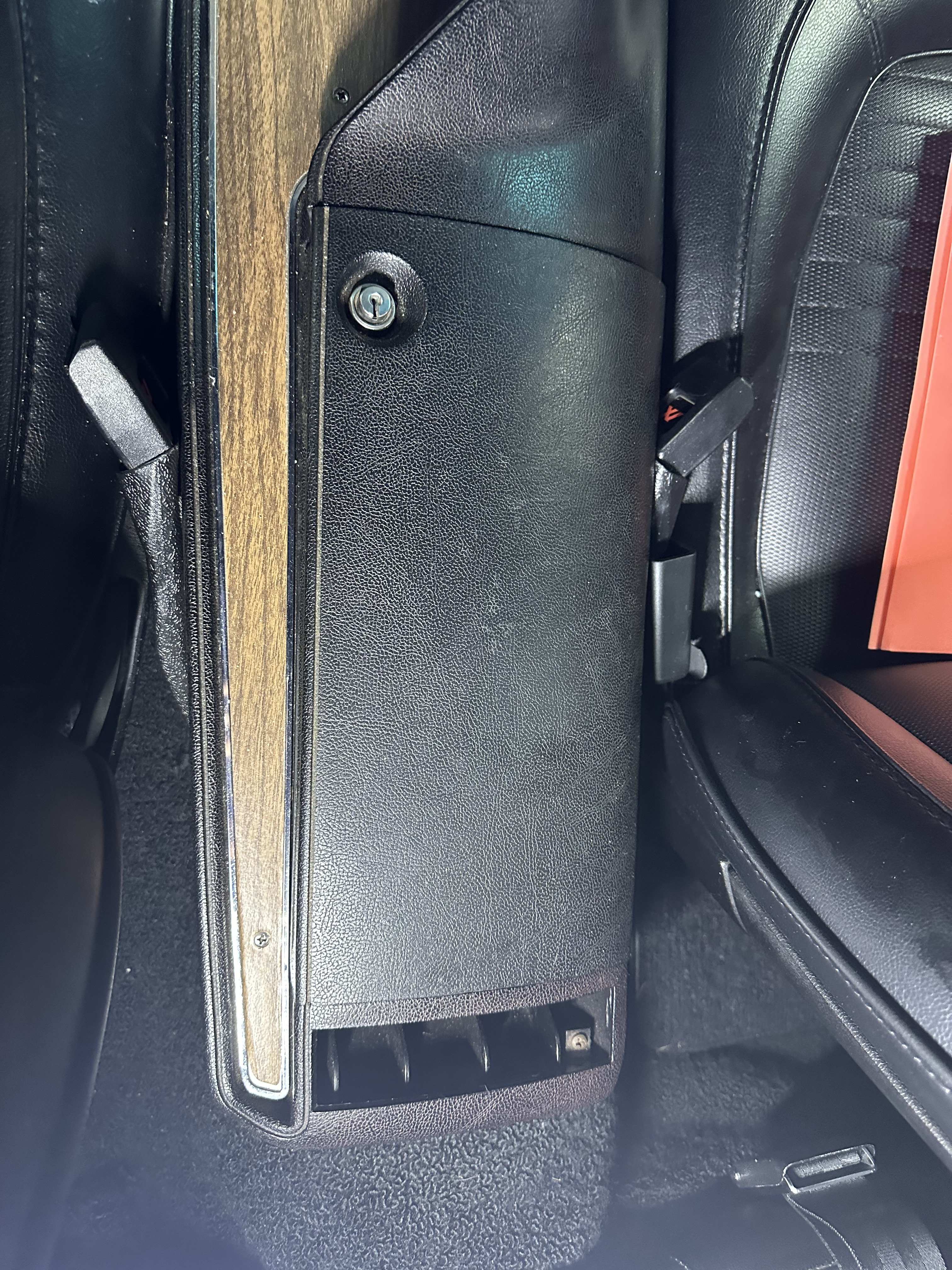

My 70 black console is original and has a very, faint appearance of what appears to possibly be dark red primer overspray. The console lid is much better.
Pictures show the problem pretty well. Nobody has ever commented on it but I see it so I want to make it look the best it can.
I searched the forum but do not see any info on cleaning the console or any how-to info on spraying it with the SEM Color Coat process. Looking for options.
I also need confirmation that the console is made of ABS plastic so I can consider how to go about restoring it.
My questions...
1. What product would be best to clean the console and remove the dark red tinge? I would expect to start with just soap/water and move to something more aggressive but need ideas.
2. If cleaning does not get rid of the problem, what are your thoughts on spraying the entire console and lid? Durable? Worth the effort?

I believe I have seen that red tinge in my console also. I think that it is a colour "coming" out in the make-up of the plastic.
I would not use a solvent in case it goes wrong.
A gentle wash then a good quality plastic protectant.
Don't fix what ain't broken.

I’d probably leave that alone as well. However, if you’re sure it’s overspray, full strength EasyOff oven cleaner is usually safe to use for removing paint on plastic and rubber. I would test it on a small area on the underside first.
I think you’ll have to do the whole console if you decide to go the SEM Landau Black route. I haven’t used it on a console but my 70 Challenger dash pad came out fantastic with the SEM stuff. Sorry, I can’t offer any best techniques for spraying it since I had a local shop do it.

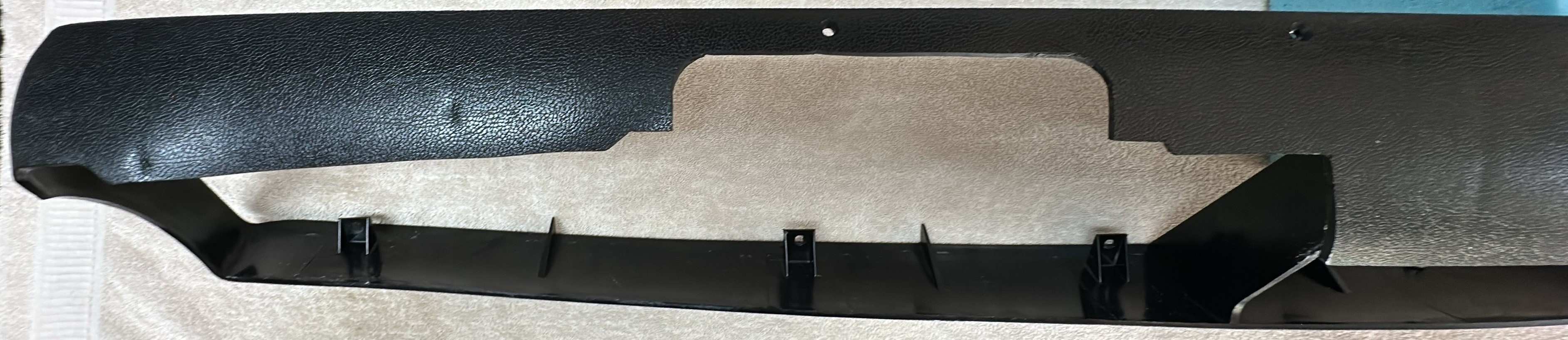

I am going to try a good cleaning with a small fingernail brush and Dawn dishwashing liquid. If that does not do it, then moving to test out Isopropyl Alcohol (IPA). Will test in an inconspicuous area first. I will let everyone know the results when I finally take out the console to do this.
I am modifying the AUTO console to a 4-Speed console and installing a TKX 5-Speed so the console has to get out of the way. :lol:
