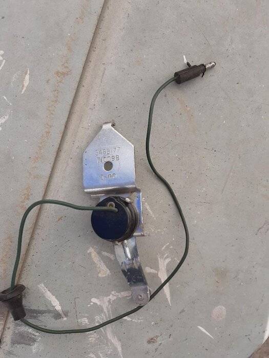

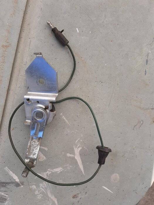

I don't know of anyone reproducing them. You probably will need to do a search for a used one and send it in for a restoration if you're going to that level. Also, there's a difference between a 1970 switch and a 71 switch. I have a photo of a 71 switch. When you do find one, they are not cheap.
