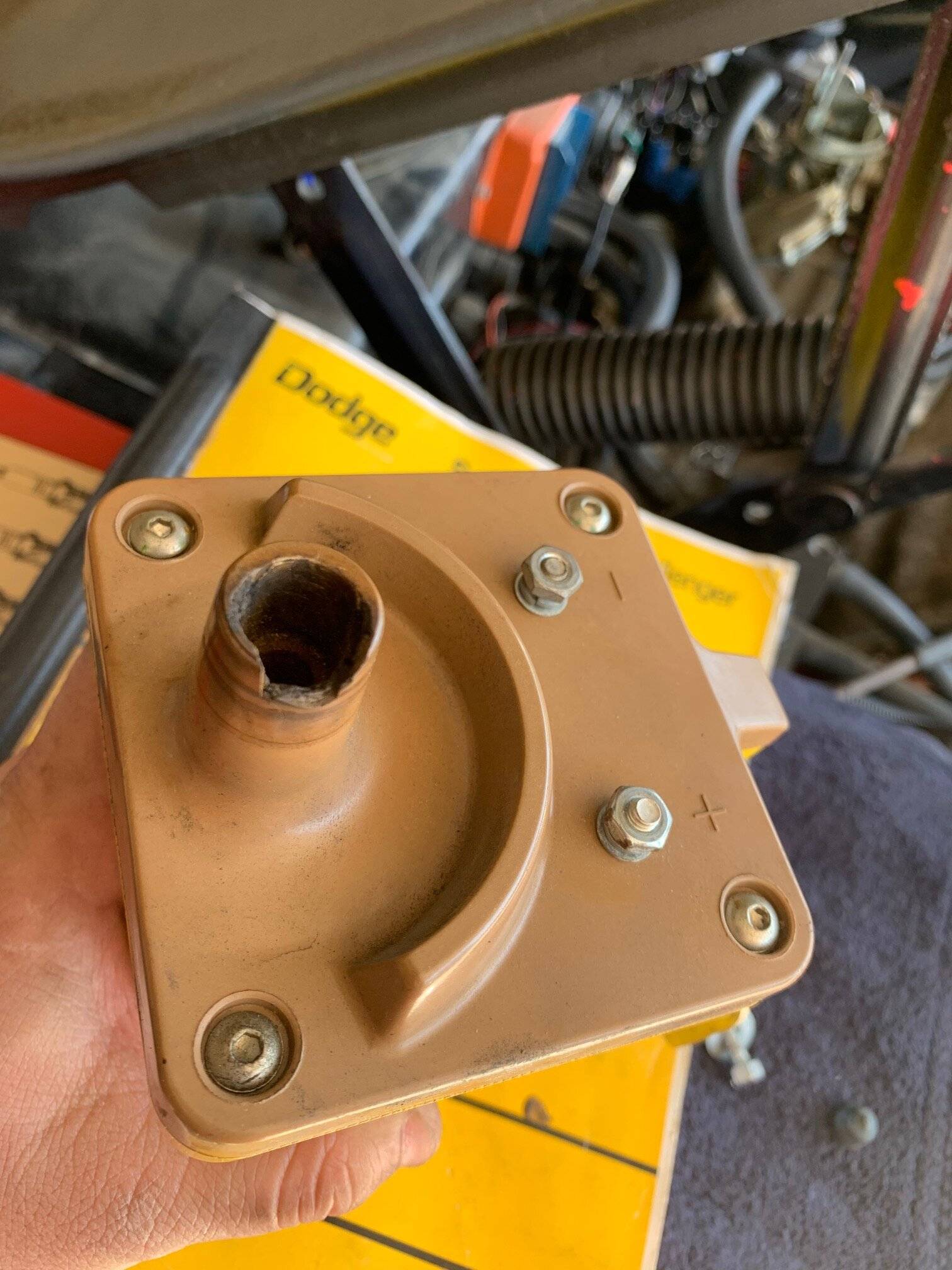

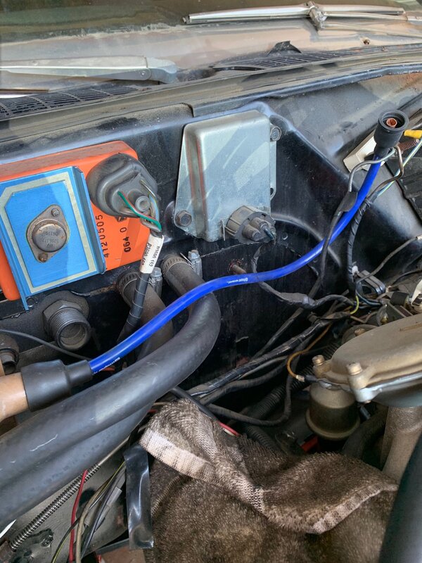

All, in the process of organizing my engine compartment's wiring, i found that my Accel 140001 coil (which is ginormous) has a chip in it. not sure if this occurred due to ignition or dropped somewhere along the way. Either way, i figure I should replace it. Since I have an MSD 6A box w/ tach adapter and a chrysler distributor conversion kit (from what I can tell), I was considering an MSD blaster coil for no other reason than its the same brand as my MSD box. Are there any other considerations I should account for?
my car is a 70 challenger with a 1993 crate engine 360.
thanks for the help.
