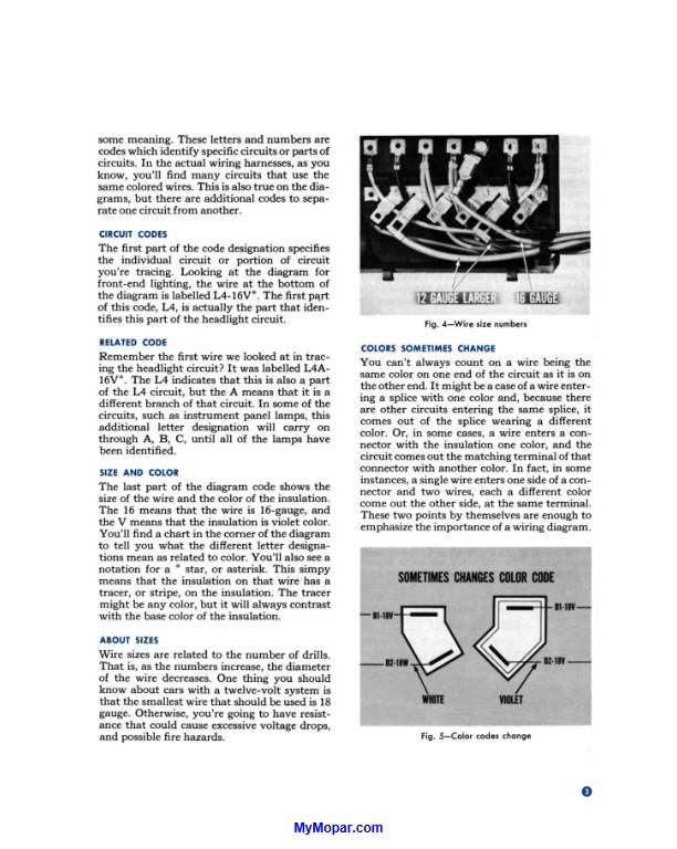

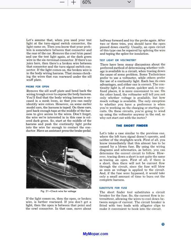

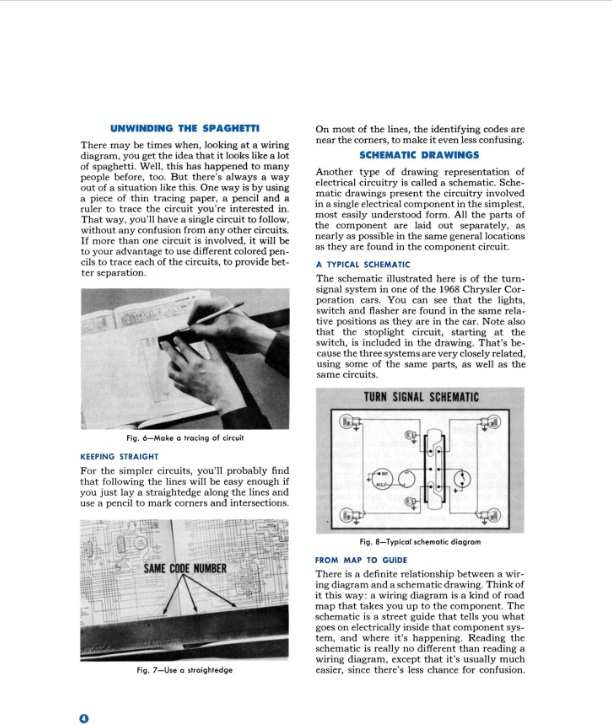

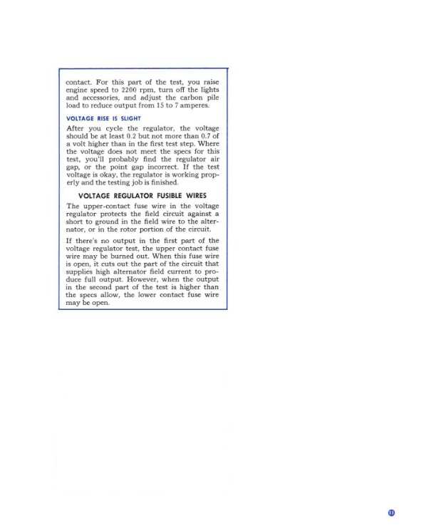

Service manual

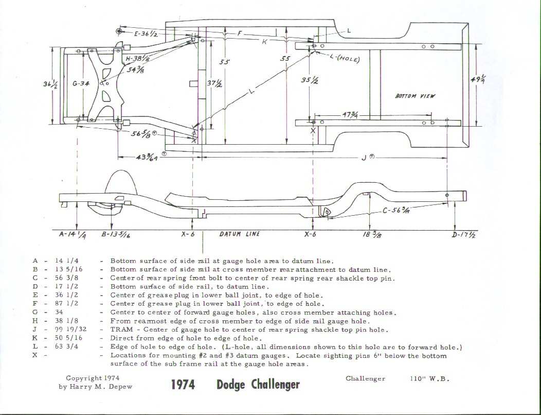

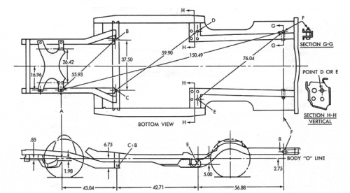

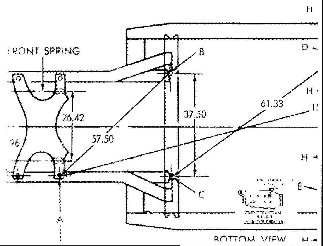

Frame measurements
Blank for recording measurements.
