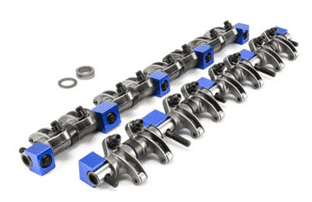

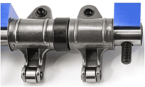

Decided against the Aluminum roller rockers after some thought and reading some stories on line. Went with the below stainless set instead. Will use real MOPAR shafts .
Using hydraulic flat tappet cam as the Aluminum heads from that Brock outfit requires them. No biggie. Like I said, this engine will live a pampered life in my 72. Will attempt to make a movie of the initial run up of the 440 on the stand and post somewhere.

Cool let us know how it works out !
I assume these are riding on a bushing against the shaft ?

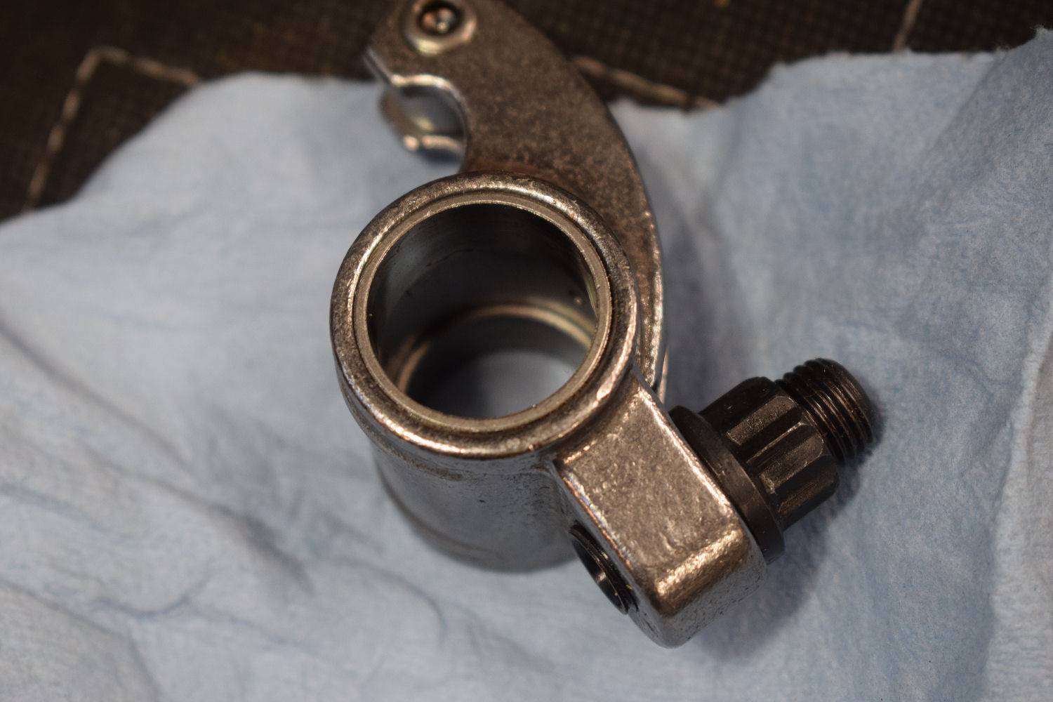

The roller rockers arrived. Poorly made. Look to be cast. Not sure I trust them? May use them on older motor with stock orignal springs. If they break I have excuse to tear down and rebuild 440 #2. They are bushed but not bronze. Looks like plain old metal tubing, reamed to size. 7 out of 8 line up over the stems. Will need to shim that lonesome arm, but extra shims were sent with the package. Photos ( close ups I hope) to follow for all to view.

Speedmaster, AT Racing, PRW... same stuff, different selllers. It's pretty typical of most Chinese imports (made in Taiwan is an upgrade these days), where probably 85% or more of the parts are great for the money, but the others will have variances or problems. I've not had issues with the parts I've gotten from them, although I don't purchase anything of a precision nature from them either. I have a 16:1 manual steering box, B-engine water pump and housing, and an intake manifold. No warning flags on any of it, although I've seen complaints about porous castings. I've also seen that complaint about Edelbrock parts... everyone has a bad day, I guess.
Regarding whether they're cast, that really shouldn't be an issue unless you've seen multiple complaints of breakage. I haven't, but I didn't look for any either. They've got meat where it needs to be. Hell, factory rockers are stamped and pretty soft. If lateral shimming of one arm is the biggest problem you've got, that's actually pretty good. B3 Racing Engines makes custom rocker shaft shims that, based on your measurements, will optimally place the rockers on the valve tips. He also does custom stands that do the same thing, if you've got W-series or early B heads. He says the PRW stainless stuff is actually pretty decent, once it's correctly placed over the valve tip. If you've got some time to kill, his Tech Corner has four articles on rocker geometry that are well worth reading.

I have used a lot of the PRW stainless rockers , never an issue , bronze bushed , yes you have to space them but they send 3x as many shims as you will need .

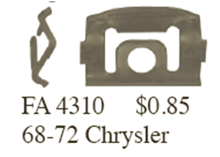

Gentlemen, a question, well, two actually.
One, has anyone replaced their windshield on their Challenger????
Two, if your answer is yes to question one, do you remember the clips you had under the windshield trim?
I ordered some and received the item in the first pic. The package was labelled 70 Challenger.
What is physically on the posts on my 72 (not screwed on and yes screws came with the clips I ordered) is the second photo.
Note, what was sent is listed by Mister G as a 68 to 70 Chrysler. [link to Mr. G's - Mr. G's Enterprises - Auto Fasteners - scroll down to the windshield mount clip, pgs 60-62]
(Hope this site may be of some use to all out there for your projects, if you don't have this link already)
What is actually under my trim is listed as a GM clip 69/71???? Open to ideas...... Different window trim for a 70 versus a 72?

You need to post this in the Body Shop forum. You will get better results.

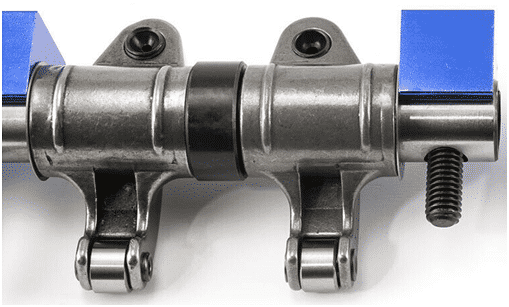

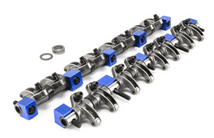

I stated I would send photos. It was recommended this subject might get better results in the engine section. Same for the windshield clips. Appreciate all the hints, recommendations. I will post to the more relevant sections in the future.

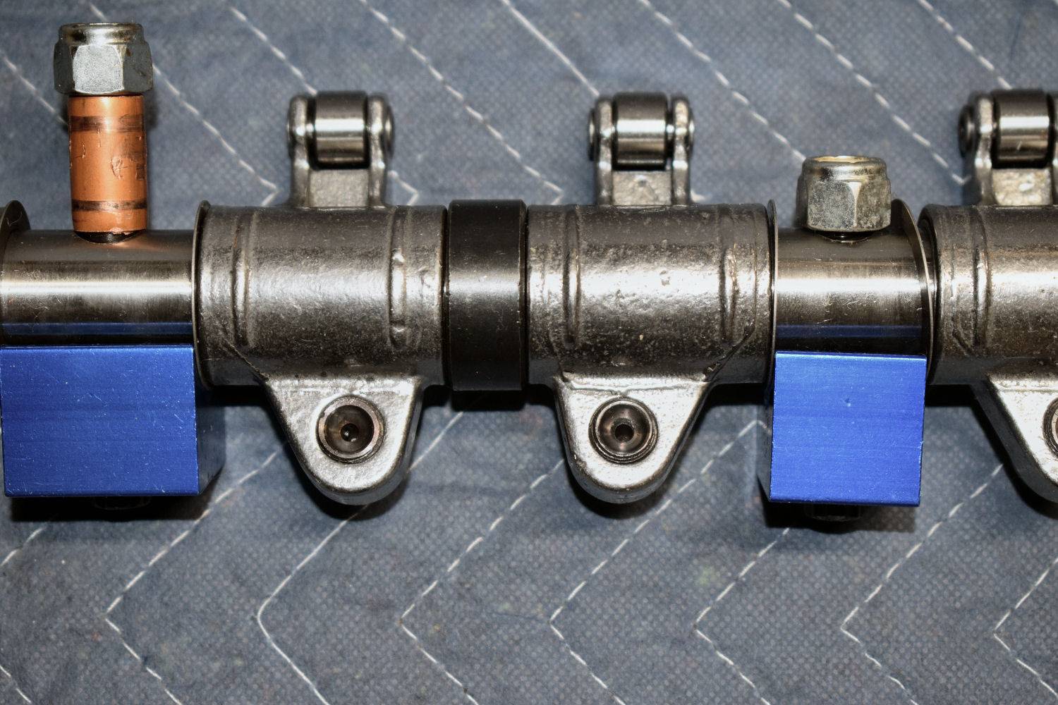

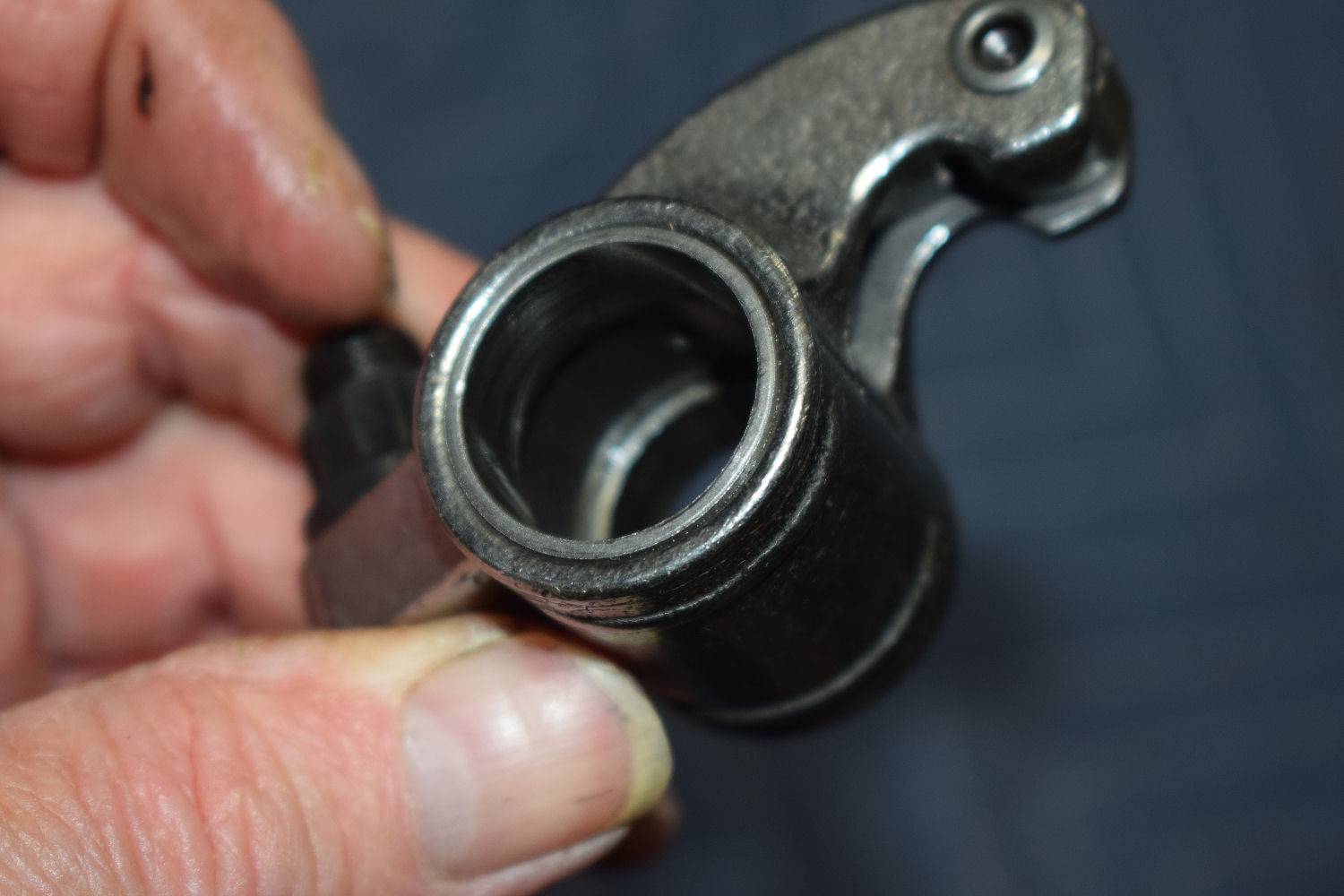

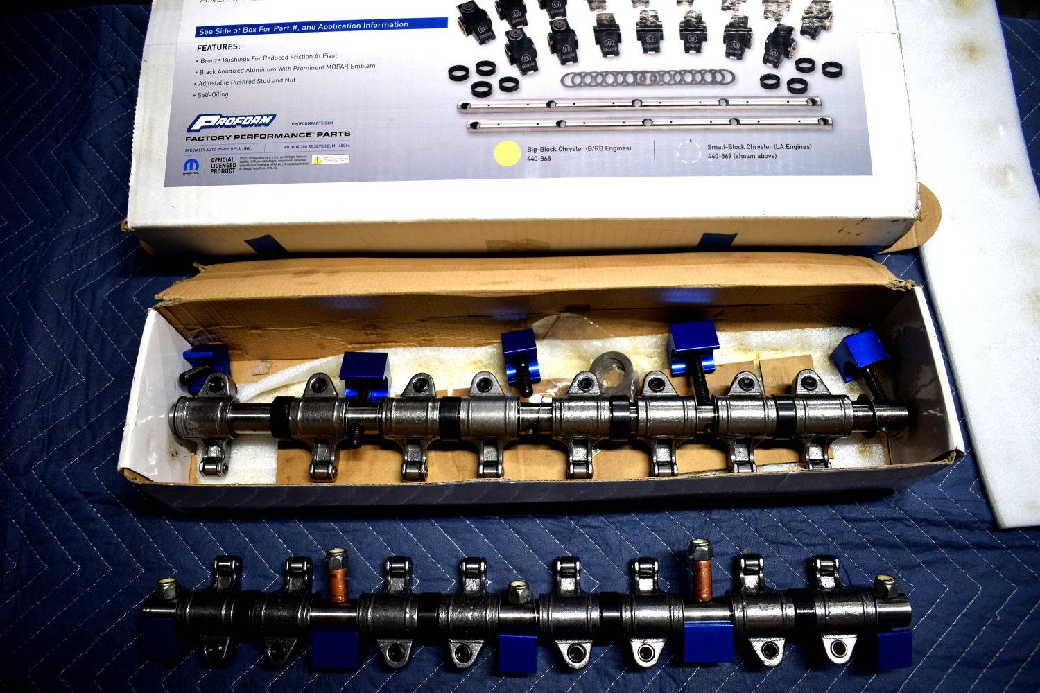

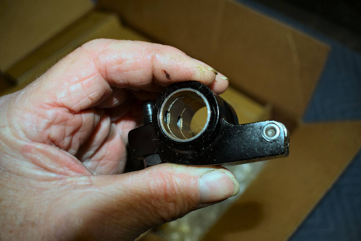

Photos. Note how clean the rockers look in the captured photo from their add than the below rockers that were delivered. Granted, they will be hiding under valve covers, but to me, that is like airbrushing some babe's photo and then you see her in the flesh....
To answer the question of sleeving, yes they are. It looks like 2 sections of stainless pipe that was pressed in and reamed to size. Yep, it will work, but they did not sleeve the rocker all the way thru. So there is a cavity area inside the rocker. Great for oiling and may aid a tad in dissipating some of the oil heat into the rocker shaft??? Otherwise, looks like very little shimming will be required.

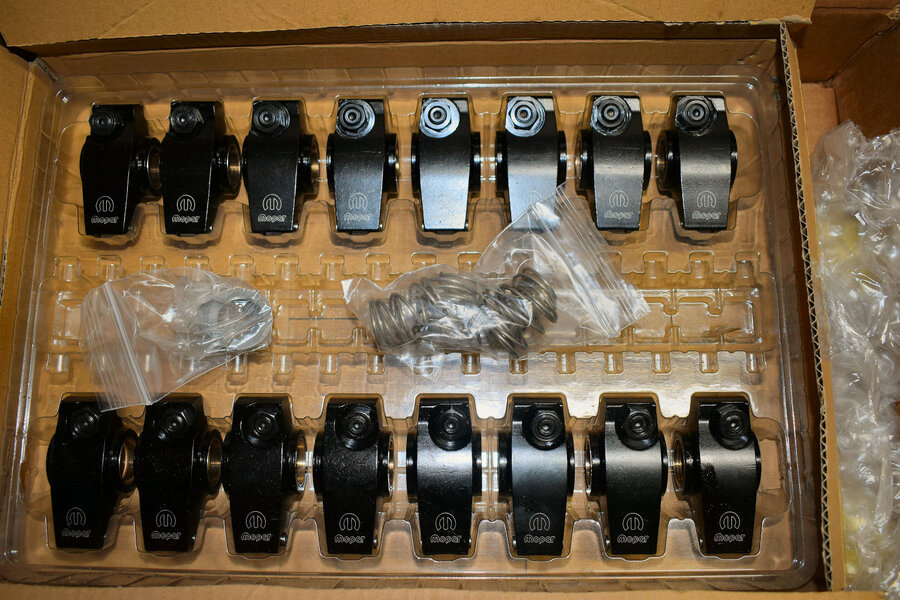

Now to the Aluminum set. I did not buy these. I inherited them. And of course after I had already purchased the Stainless set.
Better finishing and love the twin oiling holes, visible in the photo. Weighs a ton less than the stainless. May use the heavier stainless on the other 440 I have, since it will be just a so-so build in my Dart, and I am trying to shed that extra 200 pounds the 440 added to my 72 that had a 340 in it originally...
