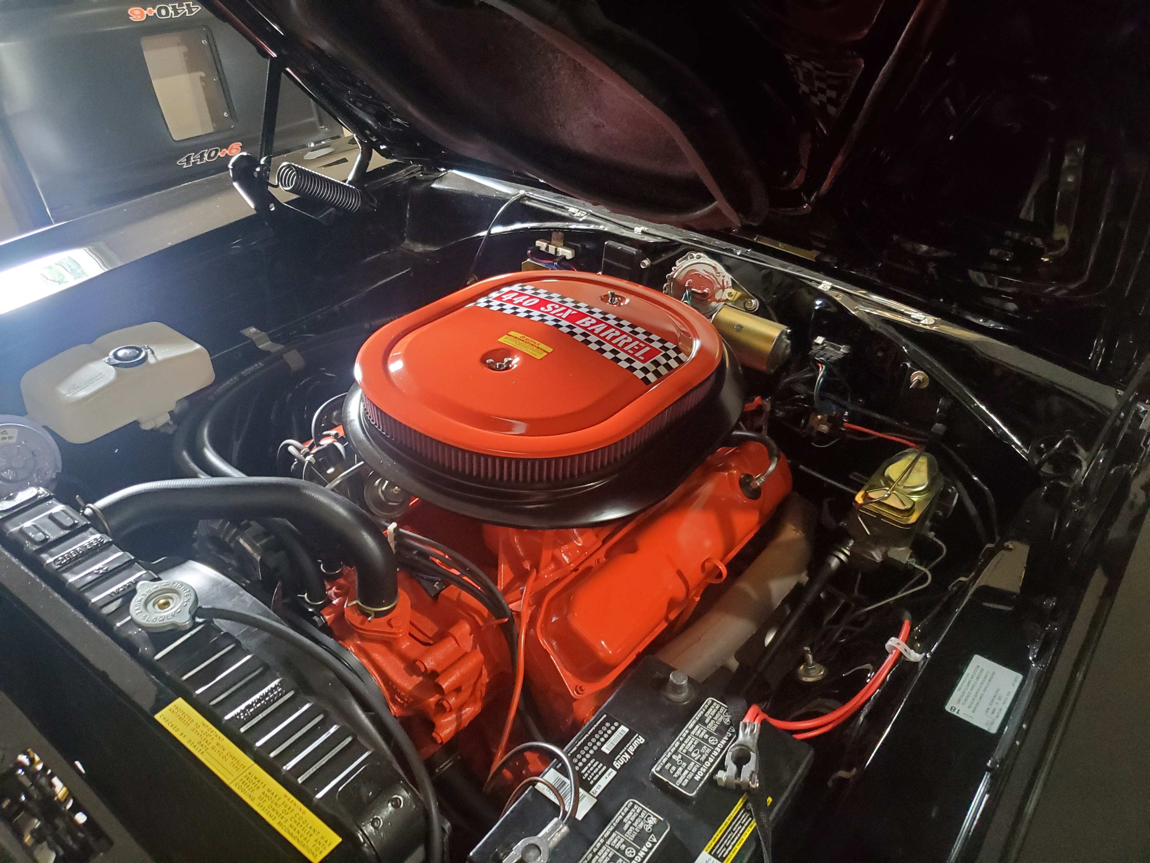

I went with a Summit manuel disc brake setup on my 70 sixpack roadrunner. Purchased the complete kit and it really was just a bolt on. Stops great!!! Installed easy, I chose manuel because the power brake boosters look so wrong. The master cylinder doesnt look 100% but its not too bad.The adjustable proprotion valve I installed in the juntion block location under drivers seat frame rail its hidden and I didnt have to adjust as the factory adjustment was excellent. The only area to watch is when turning steering wheel lock to lock there was an area where caliper just touched the shock, barely but it did touch. Just a light hit with disc sander or die grinder and perfect. This setup stops so much better than the drums. Peddle feels just like a manuel drum brake car, very high but stops excellent. I wouldnt hesatate to use this kit again.

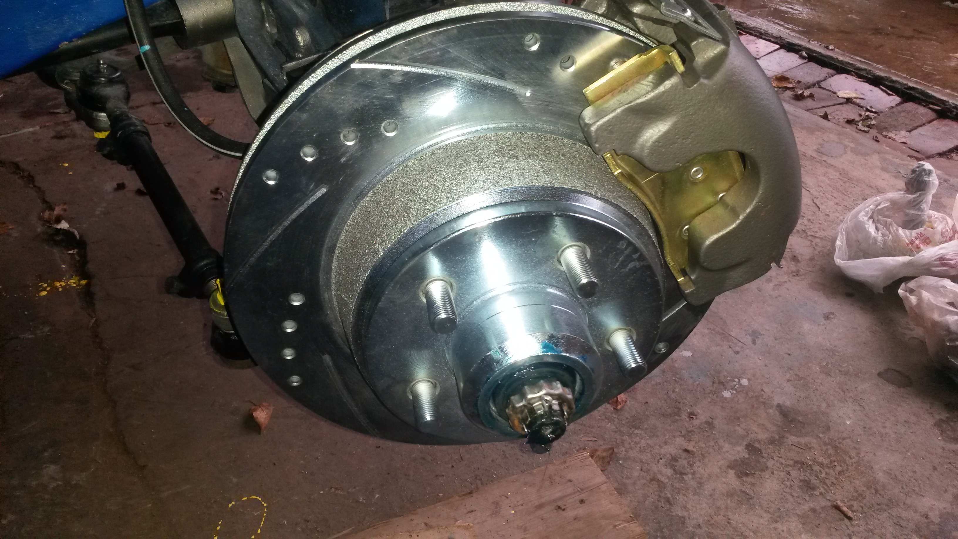

I went with the factory 11.75" set up. Chrysler put a lot more $$$$$ research and engineering into it than I would, and I think any after market co. The only thing with the 11.75 rotors you need to use 15" or larger wheels.
