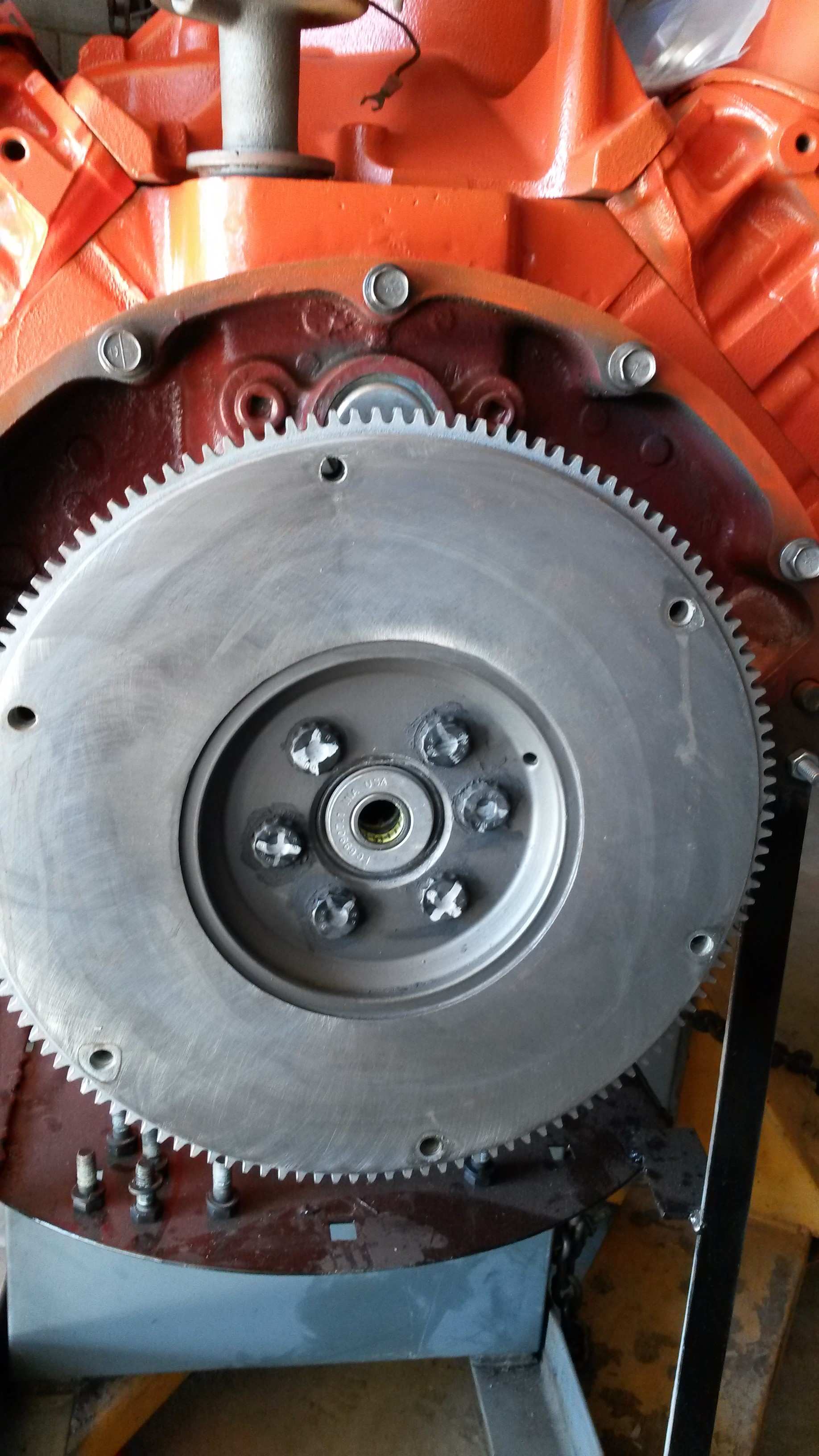

Engine crankshaft with either a bushing or drilled and reamed for a bushing would be a big help, but it's not a deal breaker as they make a bushing to fit in the torque convertor nose centering ring.

Xcudame That you mention it. I changed the busing and also installed a bearing.
