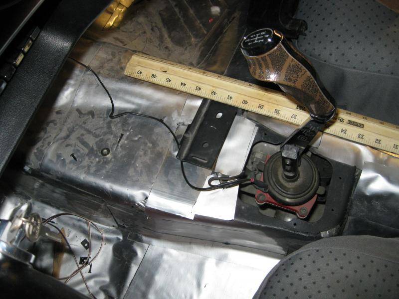

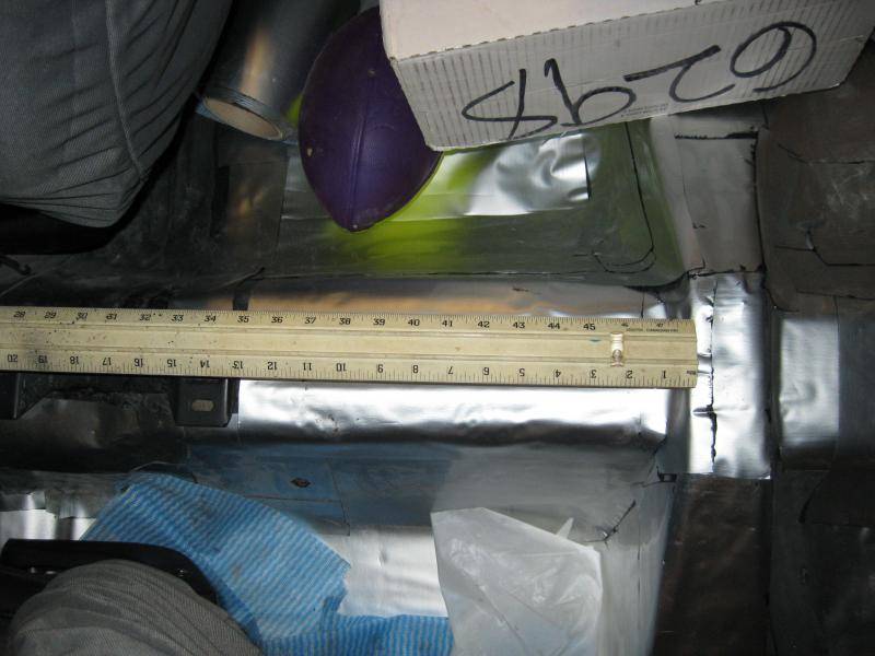

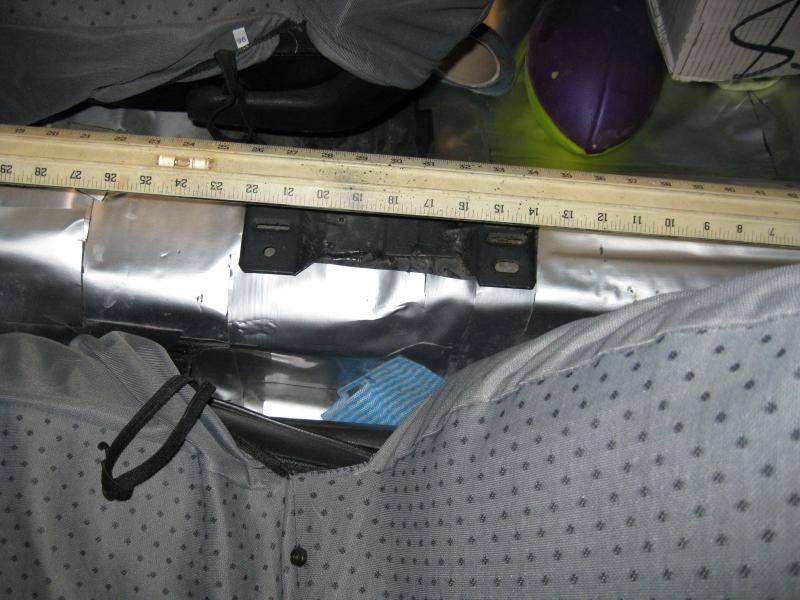

These pics start where the trans tunnel meets the back seat ridge. This is from an original 4 speed, console car.

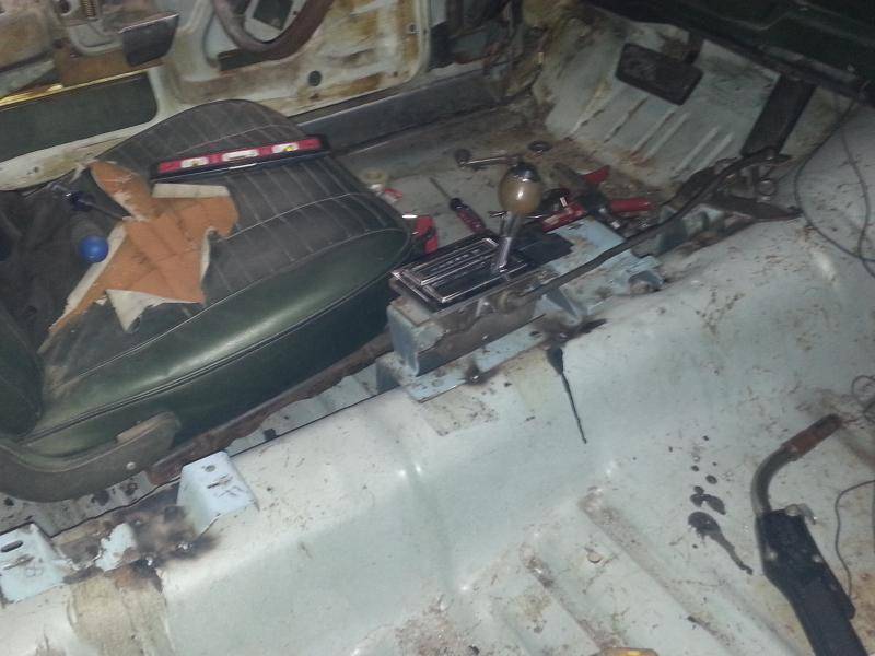

I ended up putting just the top portion of the console on and finding out where it should go and tacked it in place.
