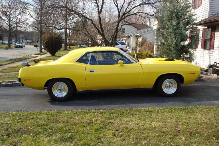

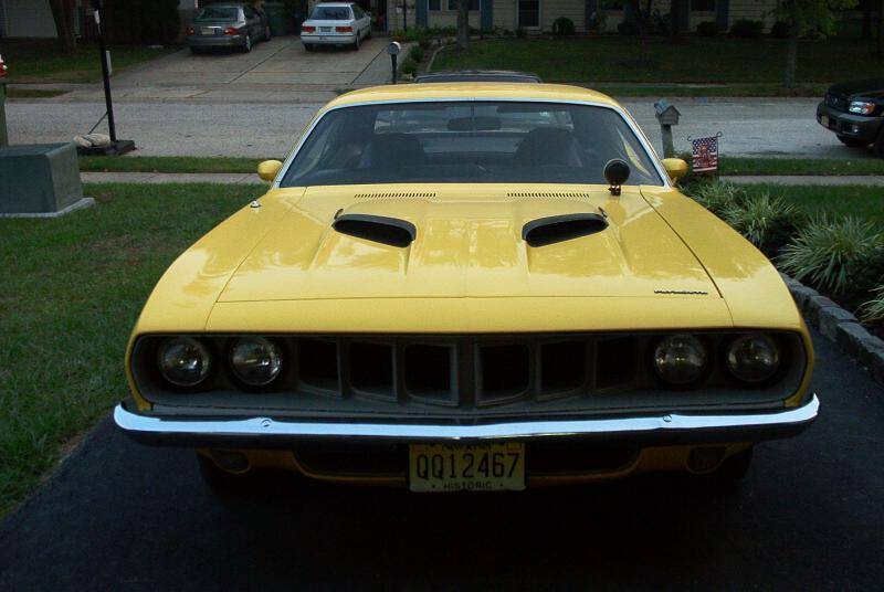

The car is road worthy and I drive the car a few times a month. Nothing is wrong with the transmission my problem is I can only find Dextron III/ Mercon instead of the plain Dextron III. My owner manual states to use Dextron. Can Dextron III/ Mercon be used to top off the transmission?. I may have said the car was restored 20 years ago in the previous posts. I never resolved the fuel issues but my work around was to keep a full tank of fuel in it, which is not a bad thing a car that is not a daily driver. The steering box started to leak last summer and the puddle in my garage is pissing me off. I will look at the paper work for for the steering box and see what it wants for fluid. The box is stained cherry red from what fluid was put in at the factory were it was rebuilt. Attached are to photos. Thnk foor taking the time to responed.
