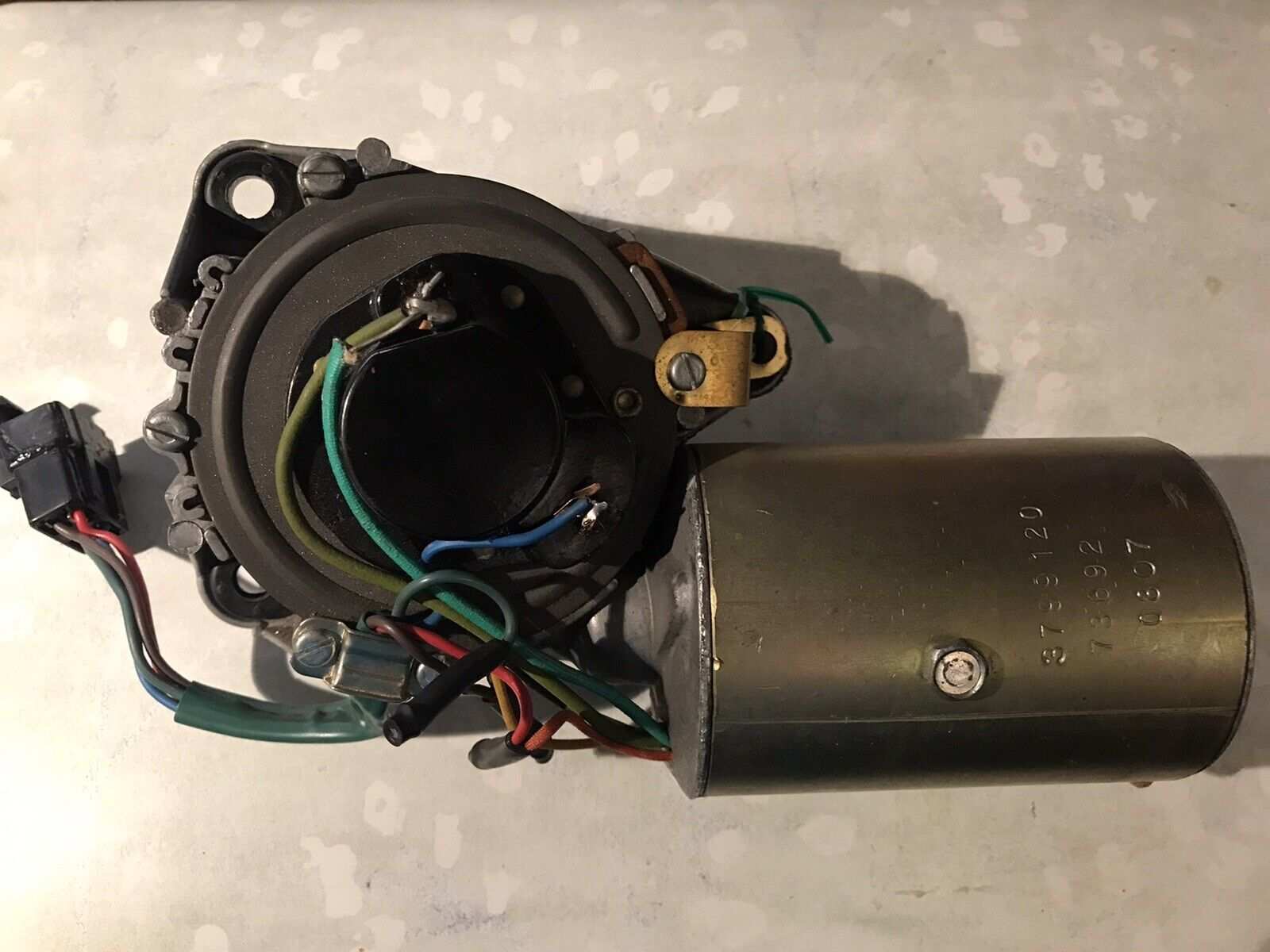

Hello. A Friend has a 70 Cuda 383 with the 3 Speed windshield wiper Motor. The Motor works fine, But He is concerned about the wires not having a cover over them. I have been searching all over for a cover for this , but all I get are either generic or GM covers. is there a factory cover for the 3 Speed wiper Motors or do We have to fabricate one? Appreciate any Ideas. Thanks

No cover for them, that' how they were made. The one you have pictured is a later 76-77 motor, a true 70 motor is 3431077. Some of the 1970 motors had red glyptal covering the wire connections.

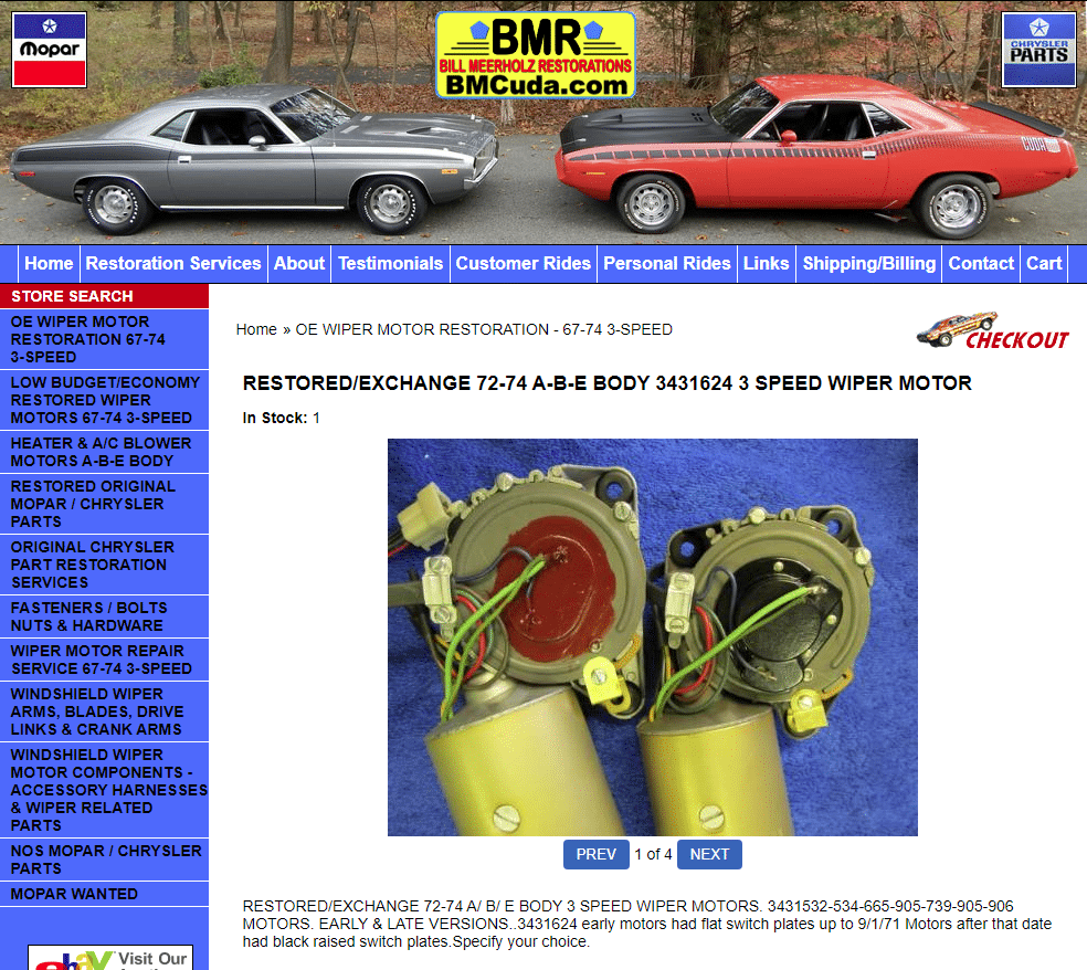

I was using this to make that previous statement, in the bottom sentence "flat switch plates up to 9/1/71".
