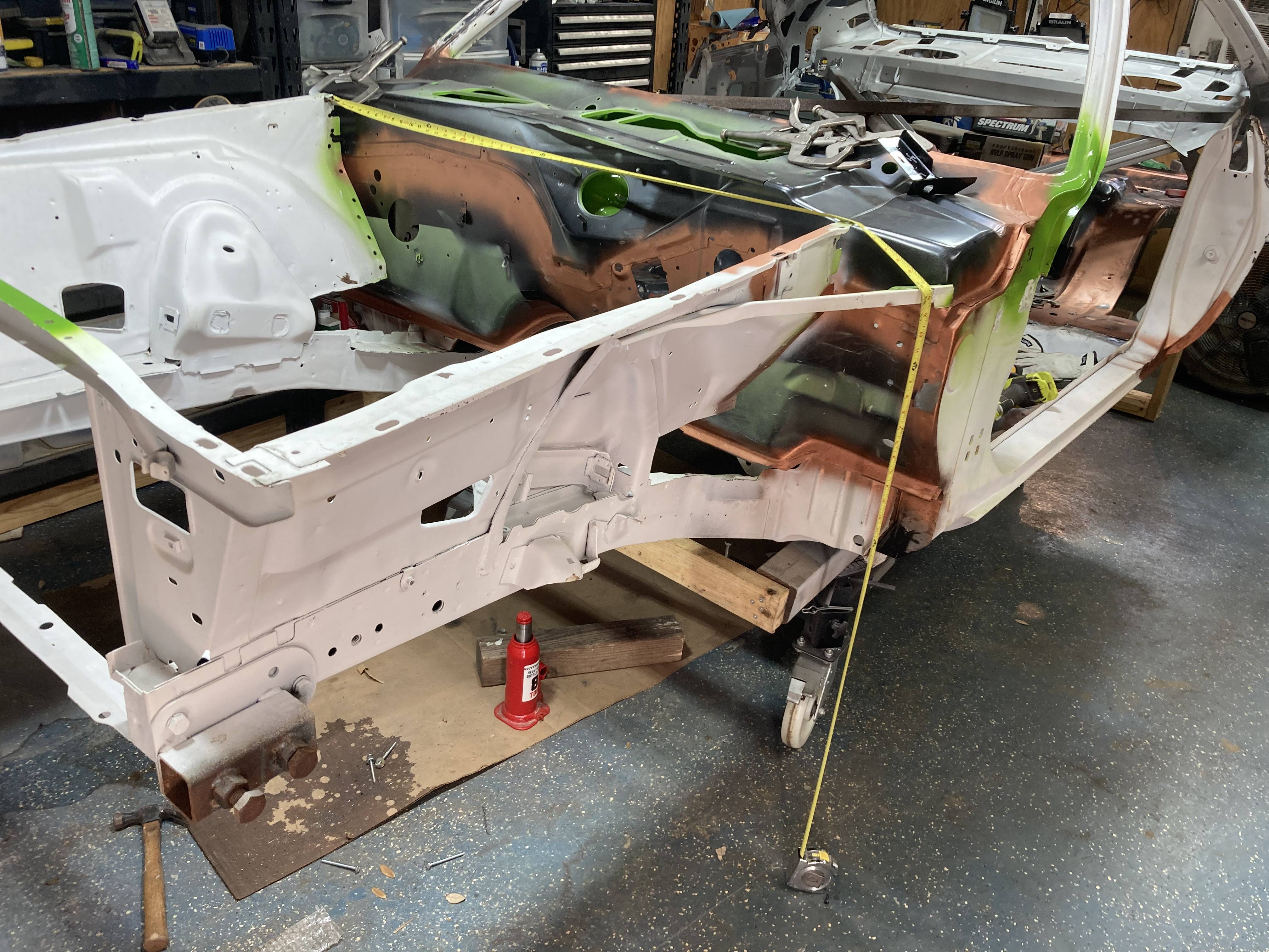

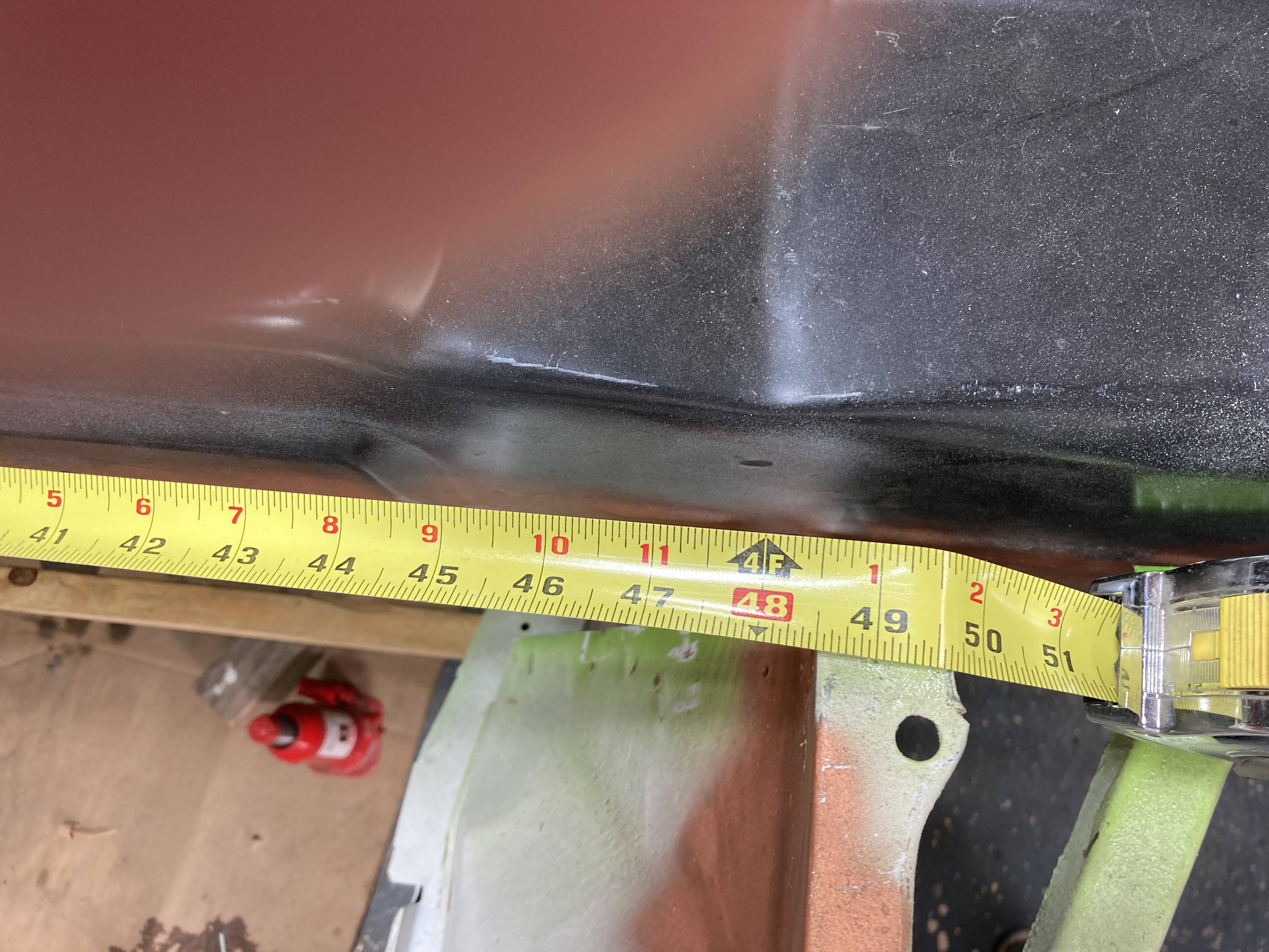

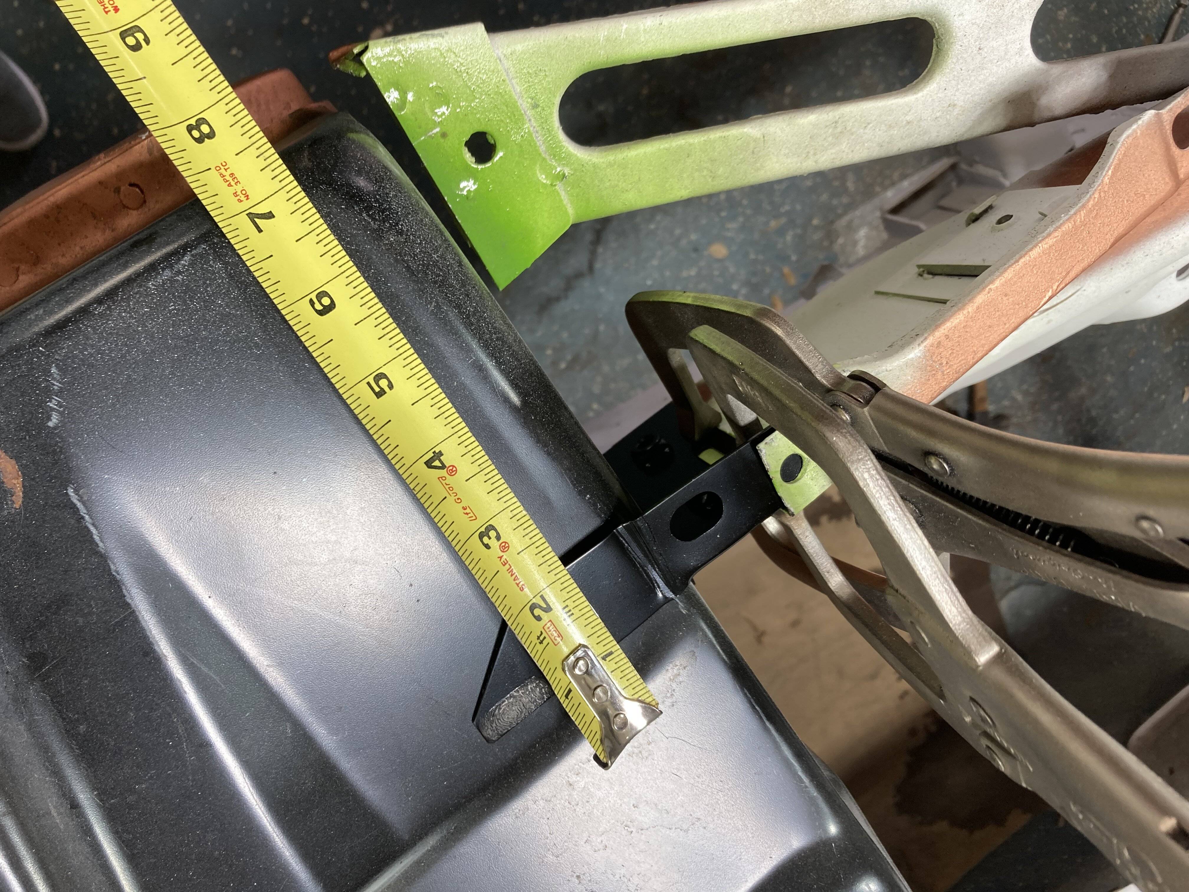

Help please. I need the cowl/firewall to inner fender measurements for a 73 Cuda. Is 7-1/8" correct for outside edge of cowl to inner fender as illustrated in Cuda4 ( I saw in an earlier post)? Is 48-1/2" where the inside edge to inside edge of inner fender is supposed to be as illustrated in Cuda1 and Cuda2?

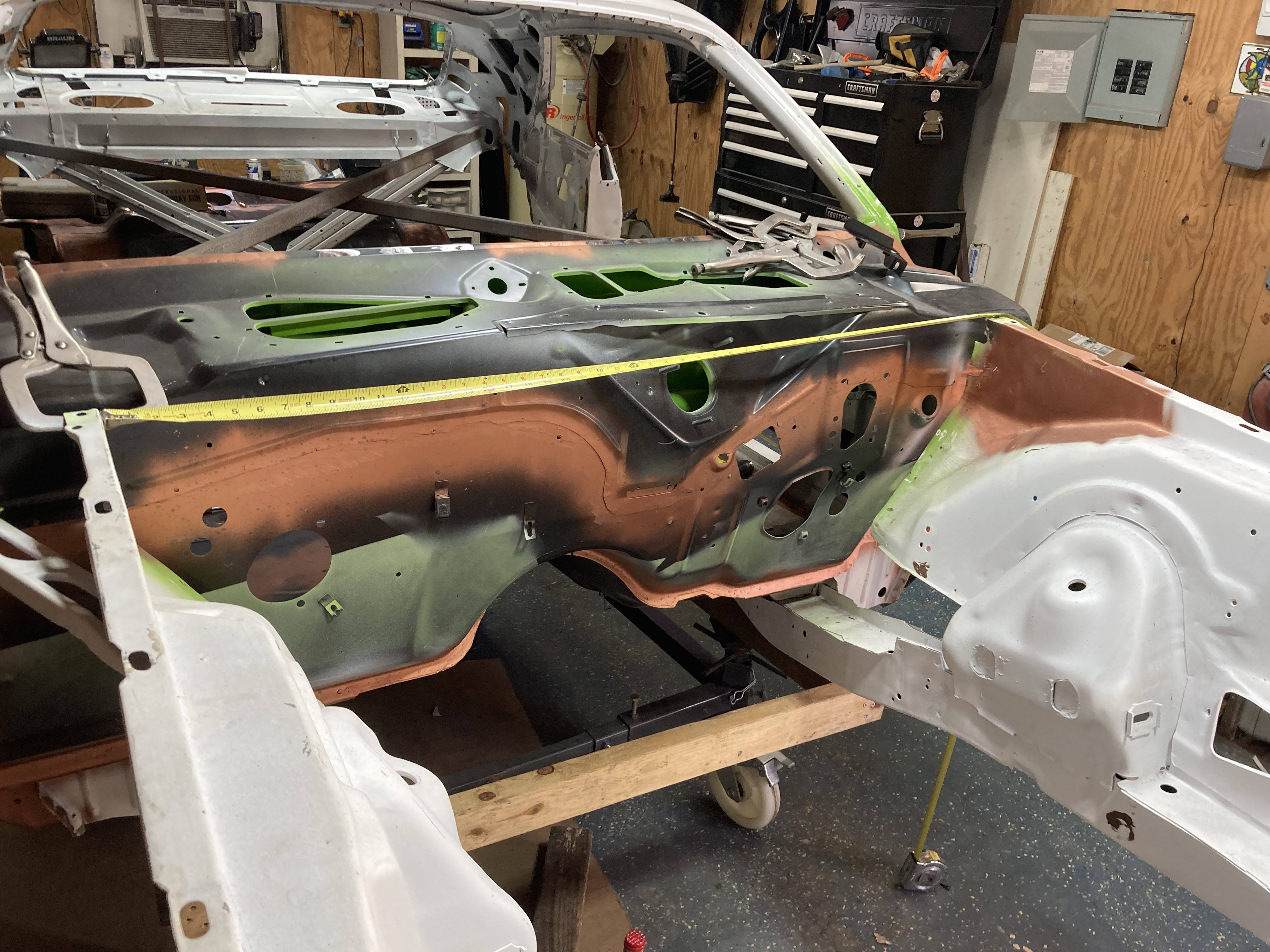

I didn't do any other cutting/replacement in inner fender, shock tower or radiator support (Cuda3).
