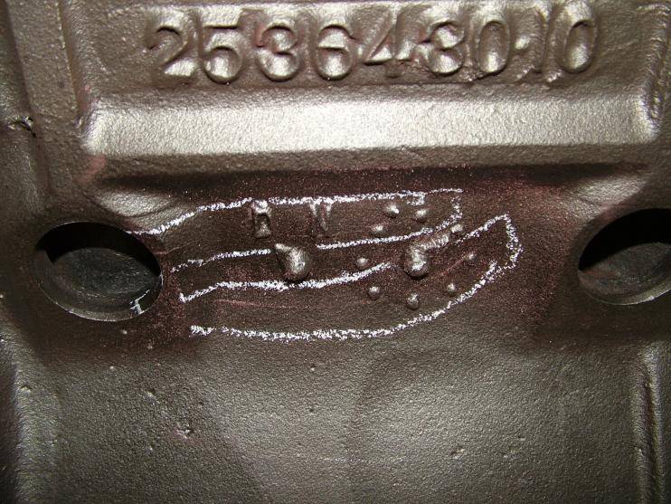

I need some professional help with my 440. It is currently being re-built, but found that the original matching numbers block was cracked :icon_mad: during magna flux inspection. There are two parallel cracks about 3 ½” long which end (or start) in one of the frost plug holes and are about ¾” apart. I have had the car about 15 years which always had a 50/50 mix of ethylene glycol and it never showed any signs of leakage. I suspect the previous owner had put in a block sealer. I do not trust it so now using a '73 block for the street build.
So here is where I need some help……do I have a boat anchor or can it reliably be repaired by welding or using those tapered threaded pins? My concerns are the freeze plug hole and the cracks being close together. The cracks are outlined in the pics with white chalk.

My engine guy would fix the cracks no problem , drill the end of the crack install & threaded pin & work back to the frost plug

Dead right, drill and stitch, it's worked well for loads of so-called scrap blocks, get it done and don't worry about it!

Thanks Chryco and Adrian. I will talk to my machine shop. And I would think the frost plug bore would need to be re-machined to remove any remains of the last threaded pin which would need to extend into the hole to remove the last bit of the crack.
