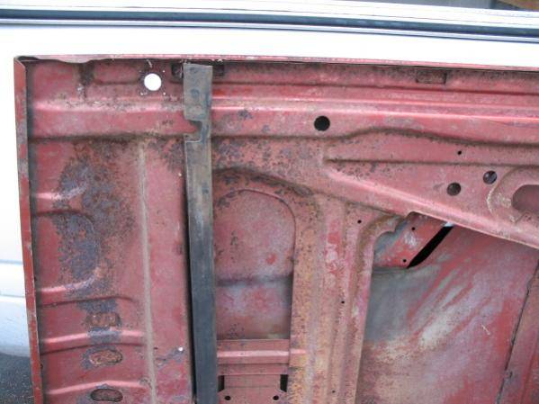

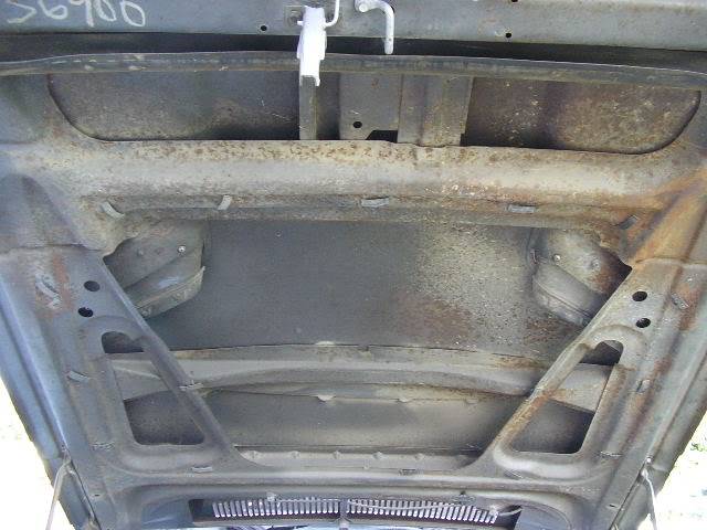

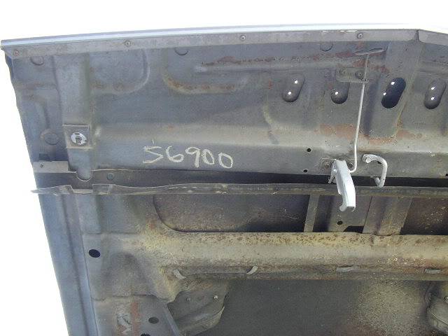

I had a member pm me with a question regaurding the difference between the early `70 Challenger non crumplezone hood and the rest of the Challenger hoods with the crumplezone. I only have a couple of early `70 non cz hoods here so I am posting a pic or two them, could somebody post up a pic of the underside of there hood with the cz so they can be compared by all?

hay matt thanx for posting this..anyone have one with them??or atleast where there suppose to be at?? from what i see my hood is the same as yours..but i might be missing something..old eyes you know lol...thanks again lee

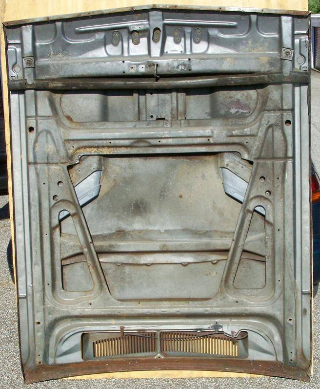

Since there are no replies here yet I will say that there would be some linear indentations in the understructure aft of the rubber seal that would make the hood fold at that point in an accident rather then sending the rear of the hood through the windshield. Somebody should be along anytime now with some pics considering probably 90% of Challenger hoods have the crumplezones.
The crumple zones are on either side of the main beam twards the front of the hood...just forward of the scoops.

It looks like that hood is off of a 73. The safety hook is different then a 1970 and the color looks like A5...a 73 only color. I don't know what you'll have to do to get the 70 style safety hook to fit.
