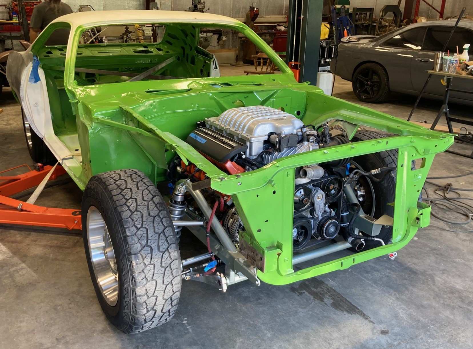

Body shop getting Cuda Body set on Schwartz Chassis w/ Hellcat Engine & 6 speed manual.
Big week. Been working 2 years to get here. Making panels for front inner fenders. Got tunnel out of 2016 Challenger Hellcat to be installed in next few weeks.

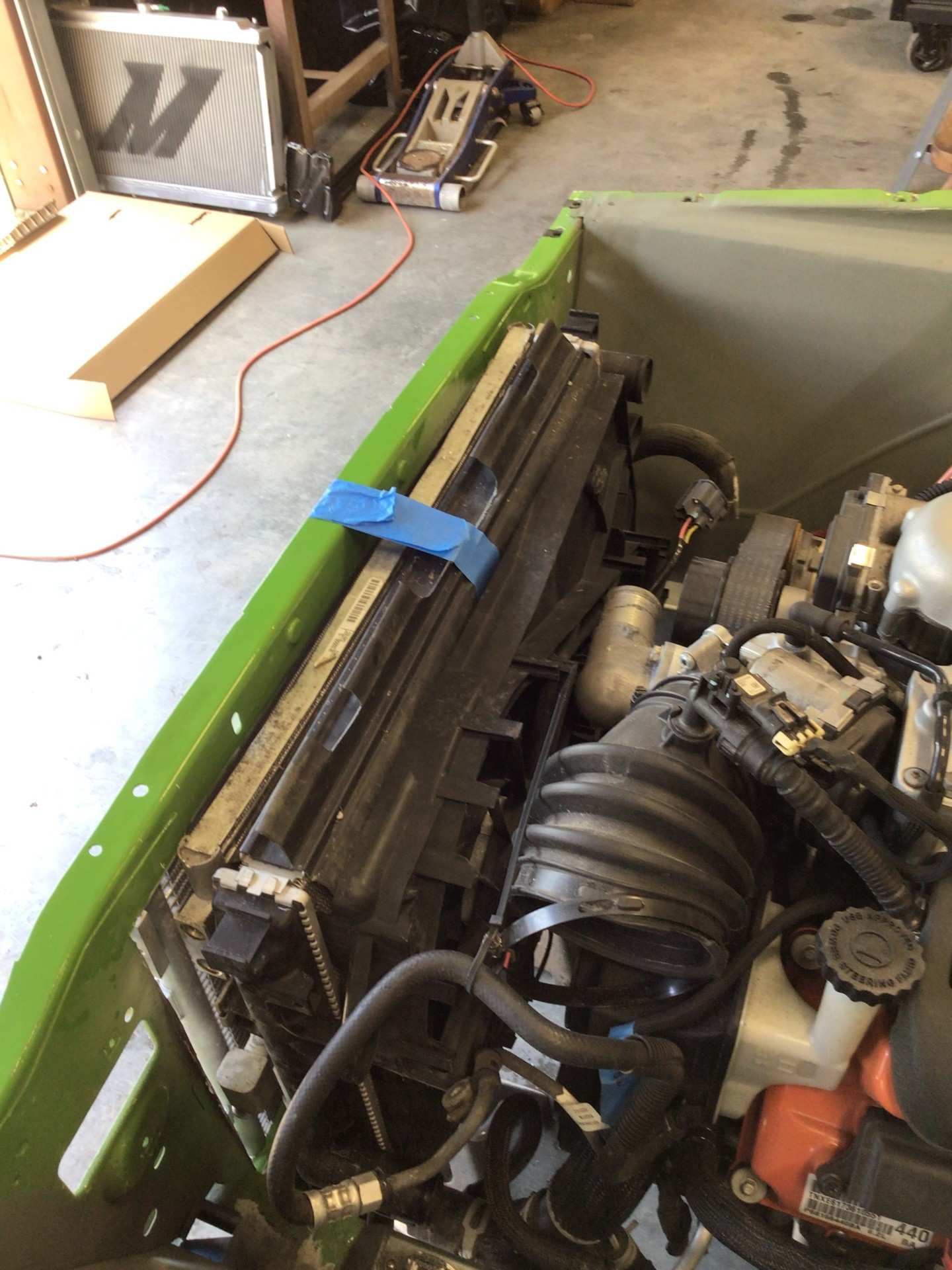

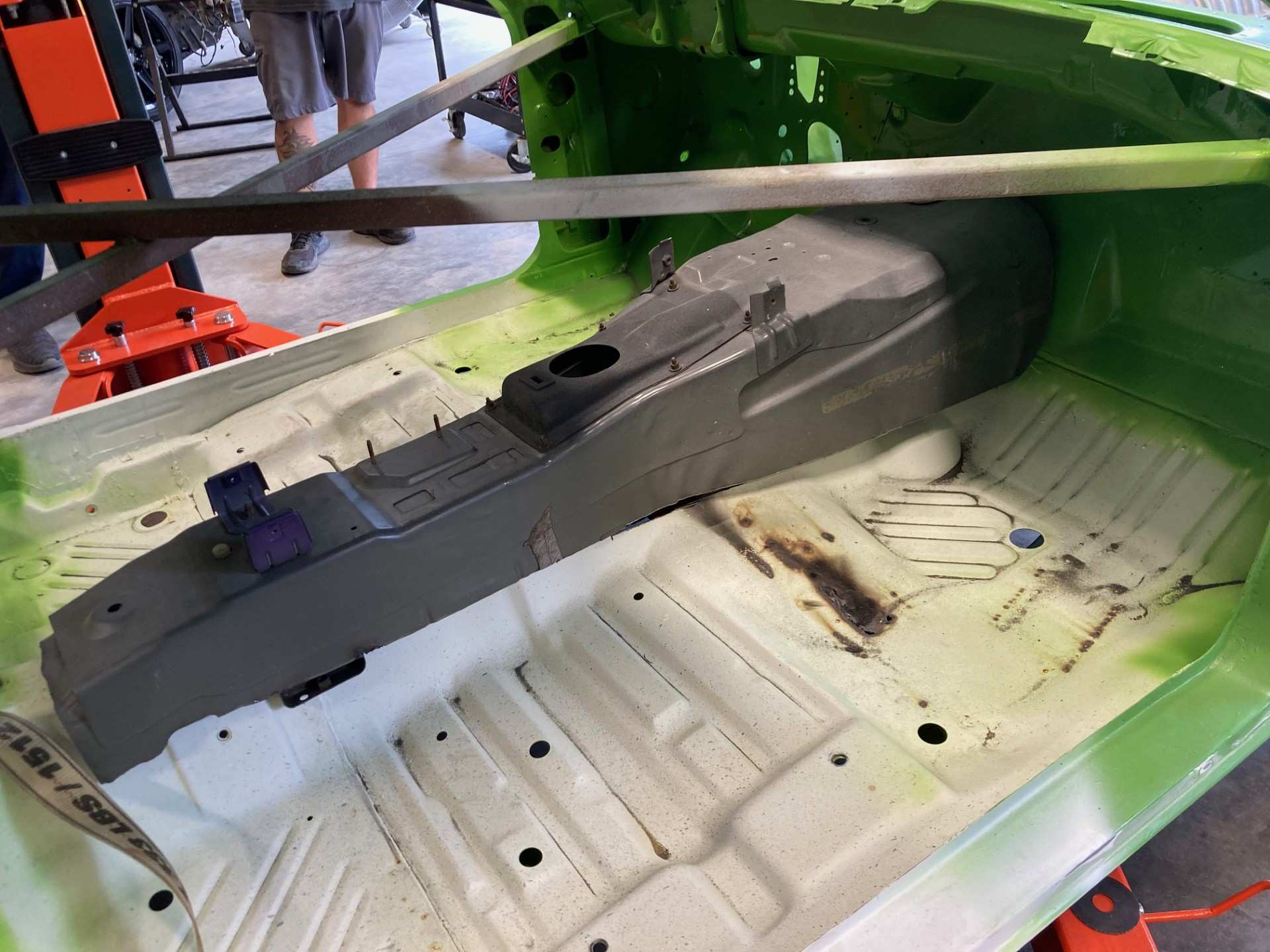

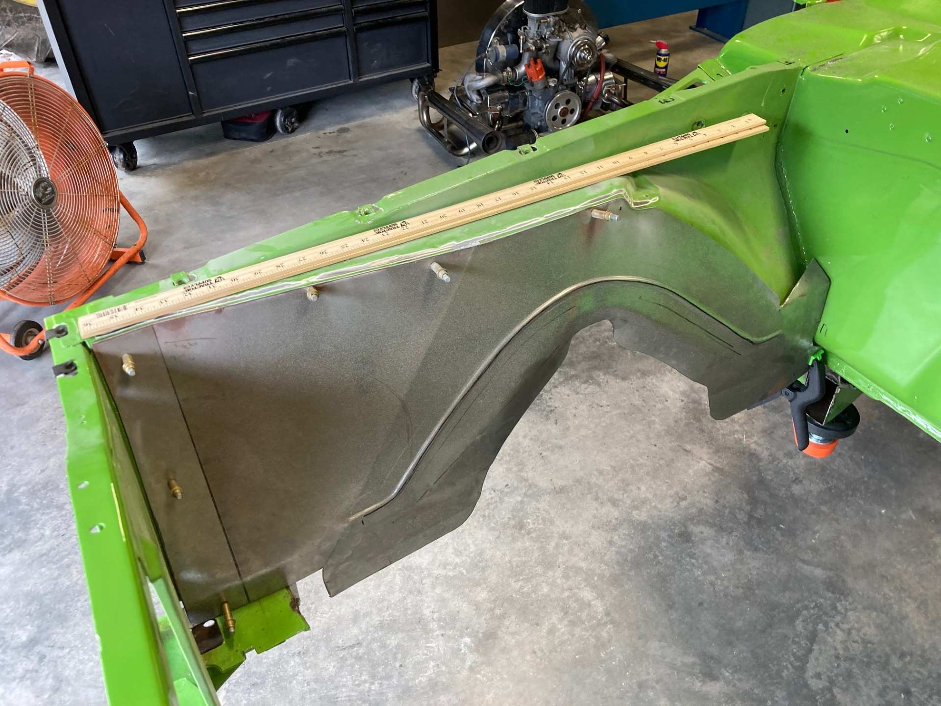

Started fabricating pieces to my Hellcat Cuda. Got the stock Hellcat radiator, intercooler & AC Condenser mocked in. Also, a Hellcat Challenger Tunner for 6 speed Manual. Panel isfor the hole left when I cut the stock shock towers out to make way for the Schwarts Chassis towers. Have gotten a 2016 Hellcat Dash to fit in. We test fitted and will worked. Show dash and more progress and I make.
I got Tim's Fabrications in Stagecoach, TX (Northwest of Houston) to do work on this part as I don't have a lift and my Tig welding isn't that great.
More updates to follow

Measure with a yard stick, mark it with chalk, cut it with a torch. Sorry, couldn't resist after seeing the yard sticks. Fabrication looks great. Nice work.
