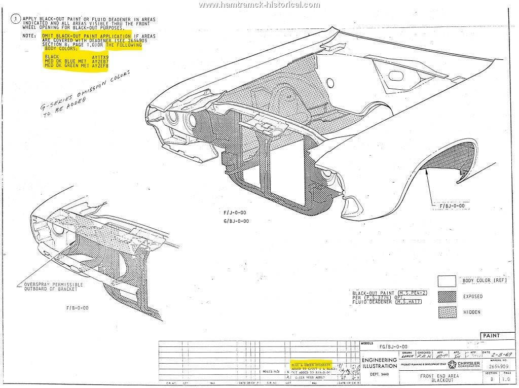

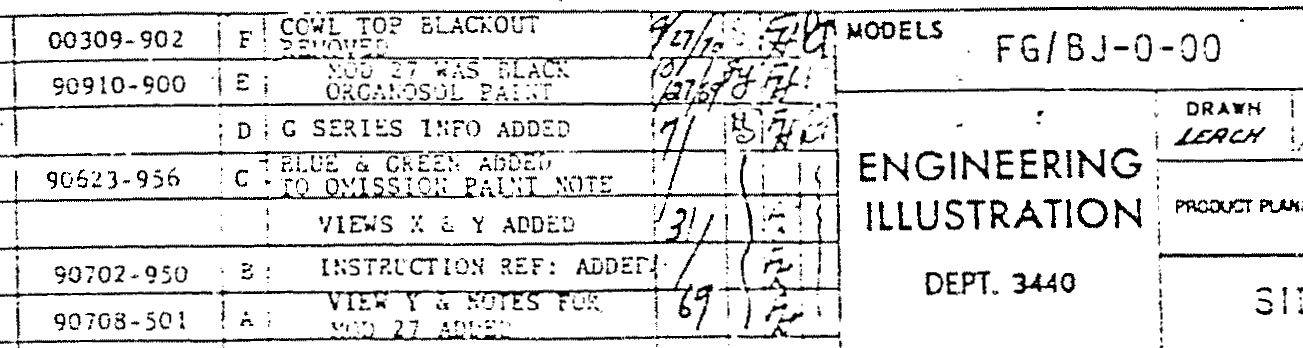

The 1970 Cuda received the cowl blackout from the August 1969 introduction through approximately April 27th of 1970. The engineering document pictured below shows:
COWL TOP BLACKOUT | 4/27/70
REMOVED
The timeframe coincides with the end of AAR Cuda production and it may have just been a cost-cutting measure for what is simply an aesthetic feature.
Original, survivor cars with Scheduled Production Dates (SPD) of late-April or early-May confirm the cowl blackout went away and never returned.
Also, note that under the MODELS section, it shows FG/BJ. I take this to mean F-Series (1970 models) and G-Series (1971 Models) of the Barracuda (B) and the Challenger (J).
Most E-body guys seem to like the cowl blackout feature. I am definitely in that group.

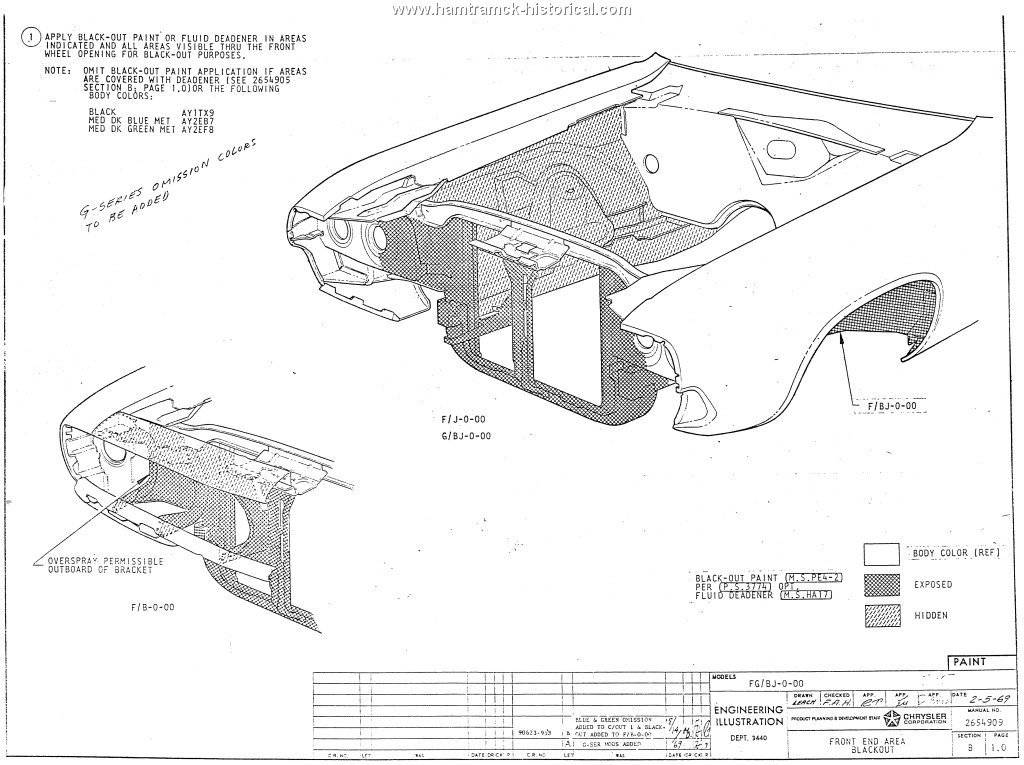

More info I had saved a while back...
"From Moparts as relayed by Tavis King of E-bodies.org:
When E bodies were introduced, the top of the cowl was intended to receive blackout paint.
This blackout paint extended under the windshield so that no body color would show between the windshield and the dash pad, and it also extended up the inside of the A pillar pinch weld about 10 inches so that no body color would show between the windshield and A pillar plastic trim.
The blackout paint was applied after the body color, and it was not masked off, it was just sprayed freehand. This results in a soft foggy transition where the forward edge of the cowl transitions from horizontal to vertical, and sometimes overspray and runs can be found on the firewall. It covers the entire top surface of the cowl from fender to fender, sometimes with paint runs or small puddles running downward to the portion of the cowl which is under the fender.
Some darker colors, TX9-BLACK, EB7-MED DARK BLUE METALLIC, & EF8-MED DARK GREEN METALLIC, were not supposed to receive the blackout paint, but it wasn’t unusual for a line worker to forget and apply it anyway.
This was regular blackout paint, not Organisol.
The mid year introduction colors FM3 and FJ6 aren’t mentioned in the blackout engineering diagrams, but it’s assumed that they should have the blackout because they’re light colors.
Around mid to late March 1970, application of this cowl blackout became hit or miss. I don’t have enough data to indicate whether additional colors were intentionally being excluded from the blackout requirement, or if the omission was accidental, but fewer and fewer cars received it, until the requirement for cowl blackout was removed for all cars on April 27th 1970.

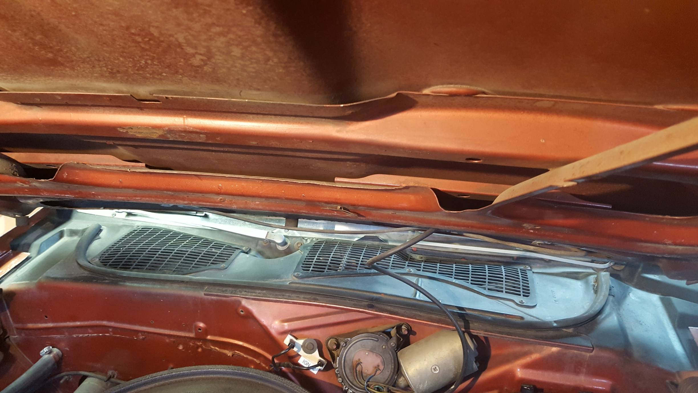

On a 1970 Cuda I've heard people say the cowl should be body color and some people say it should be black does anyone know for sure what color it should be?
Here's a picture of the cowl on my 70 Cuda, built in LA on 10/16/69. The car still has the original paint and the cowl is blacked out.

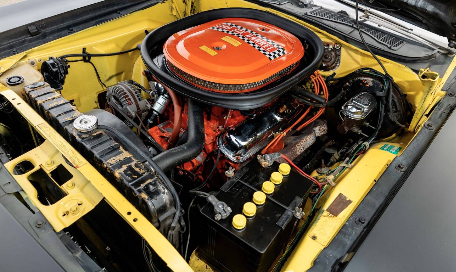

An original AAR FY1 sold at Mecum recentlyView attachment 83819. It had 34,500 miles. The cowl is Black.
As it should be and it appears to have been sprayed black first before the yellow body color was sprayed. AAR's marked the beginning of the end of regular Cuda cowl blackout as an assembly line process.
