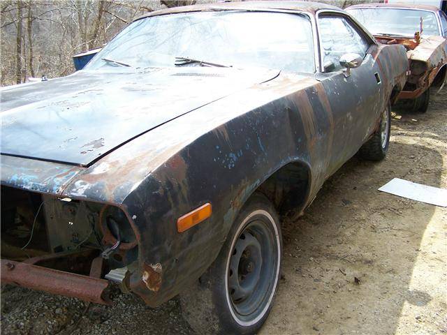

The 72-74 Cuda had a mounting bracket that your buckets would attach to. I don't have a good picture, found something on another site that shows the bracket. You will have to have a left and right one as well as the buckets to get your fenders back into shape. I used to have some from a 73 that I parted out, but I think I sold them. I'll dig around in the shop.
