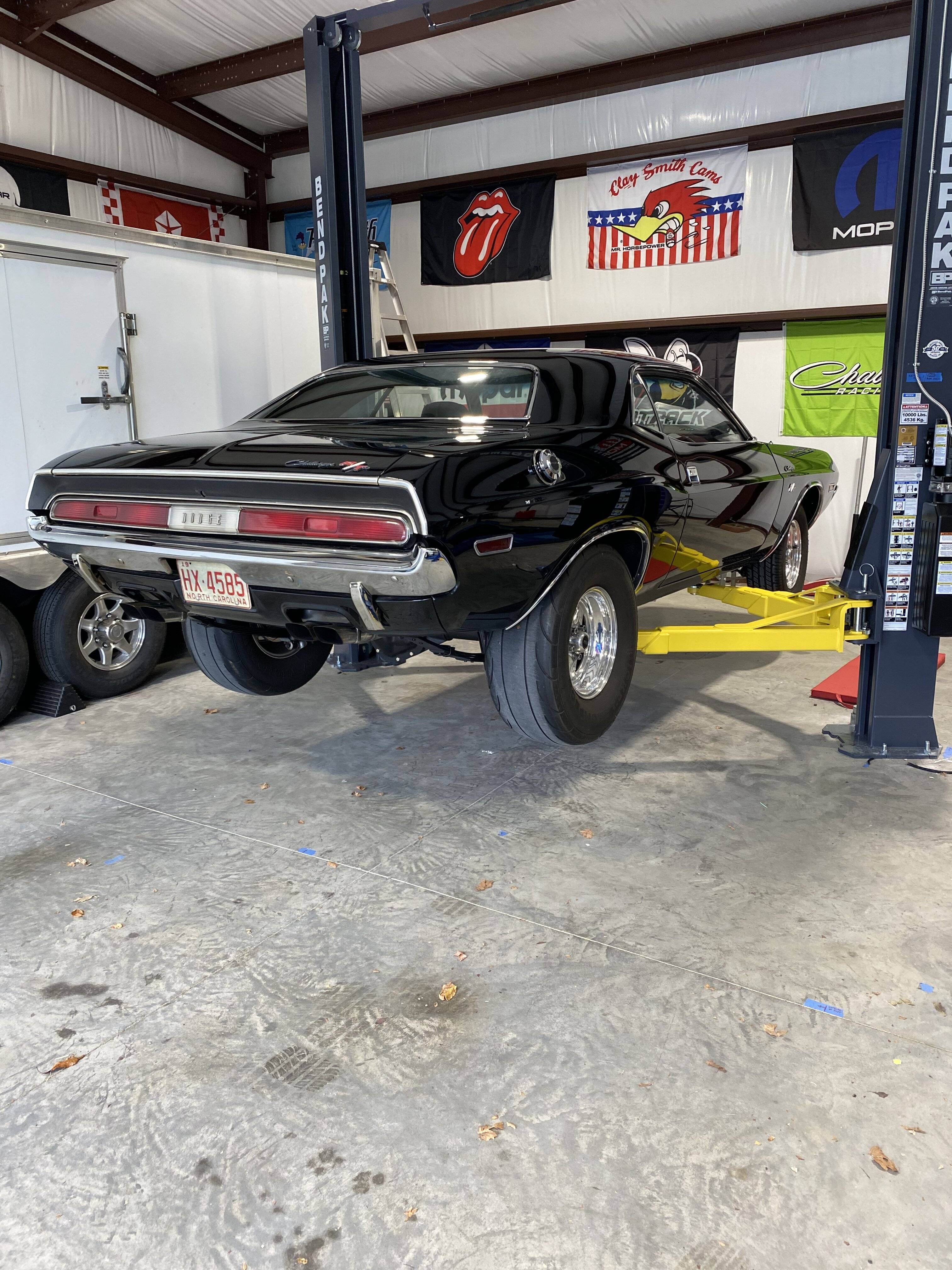

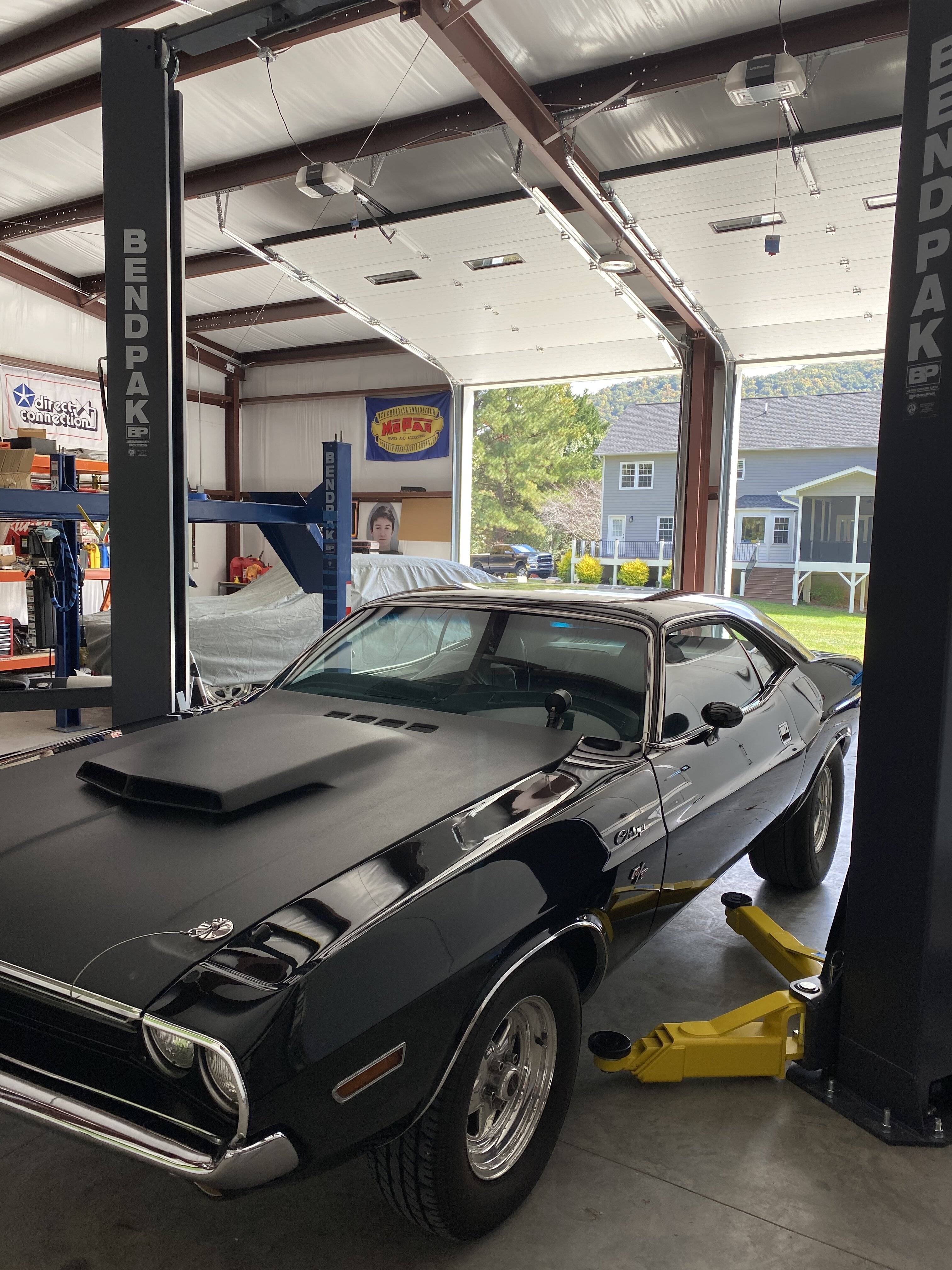

70 Challenger. Dana 60. 4:10s. Less than a year old. No issues accelerating at cruise or laying into it. Hear and feel a metallic whirring sensation/Sound on deceleration as you come off the gas.
From what I have researched the concern might be a pinion bearing failure or poor pinion bearing preload??
Anyone agree ?
I have little to no knowledge on setting up the lash, preload, etc.
Any downside to re-torquing or tightening down the pinion bolt ?
Thx for any constructive comments.

Great looking Chall !
