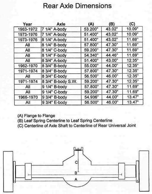

Do you remember where you got the bearings and the bearing holders to weld onto my tubes? It must have been your conversion I read about, I just forgot where I read it at.
Do you have a link for the B body specs to shorten it to?
Chryco Psycho
4,697
2,341
Panama
I used to work in a racecar frame building shop building race cars & suspension mods etc , we used to go to the wreckers & buy 6 Danas at a time to build for customer cars , we were a dealer for Strange so I bet they have the parts . I don't recall right now where I researched the ford tapered brg swap but I believe it was through Strange as an option when ordering the axles .
Here are the dimentions
