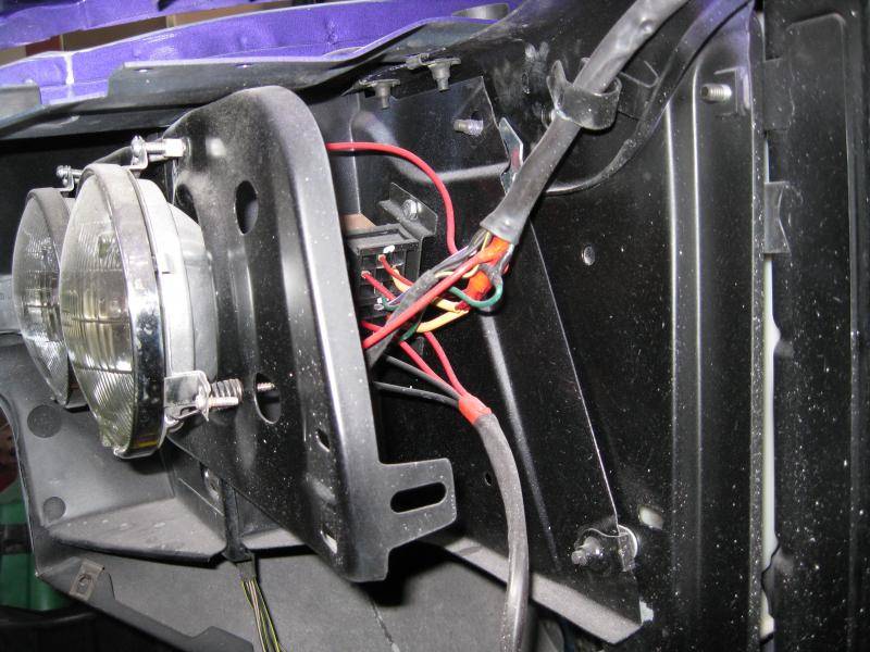

Yes. I used his kit to upgrade my headlights. You can get relays anywhere, the ceramic headlight sockets were the only thing I haven't seen elsewhere, although I didn't look too hard. They are somewhat fragile and chip easily.... use good wire and relays (not Chinese). Ron Francis wiring has some good stuff. www.ronfrancis.com
I hid the relays behind the headlights to keep it clean looking and get the out of the heat of the engine compartment. Definitely a worthwhile upgrade. IMG_3272.jpg

looks good, just trying to find a place where I can get everything together at one place, headlights, relays and wiring with connectors.
thanks for the picture and links, Ill give them a look

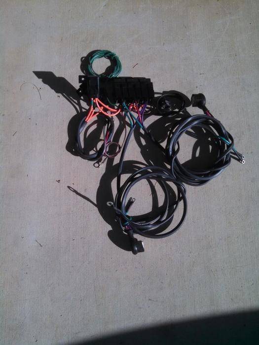

Here's a kit I put together for a customer from CC.com
He had a special situation using fog/road lights. Took three relays and it works great.
