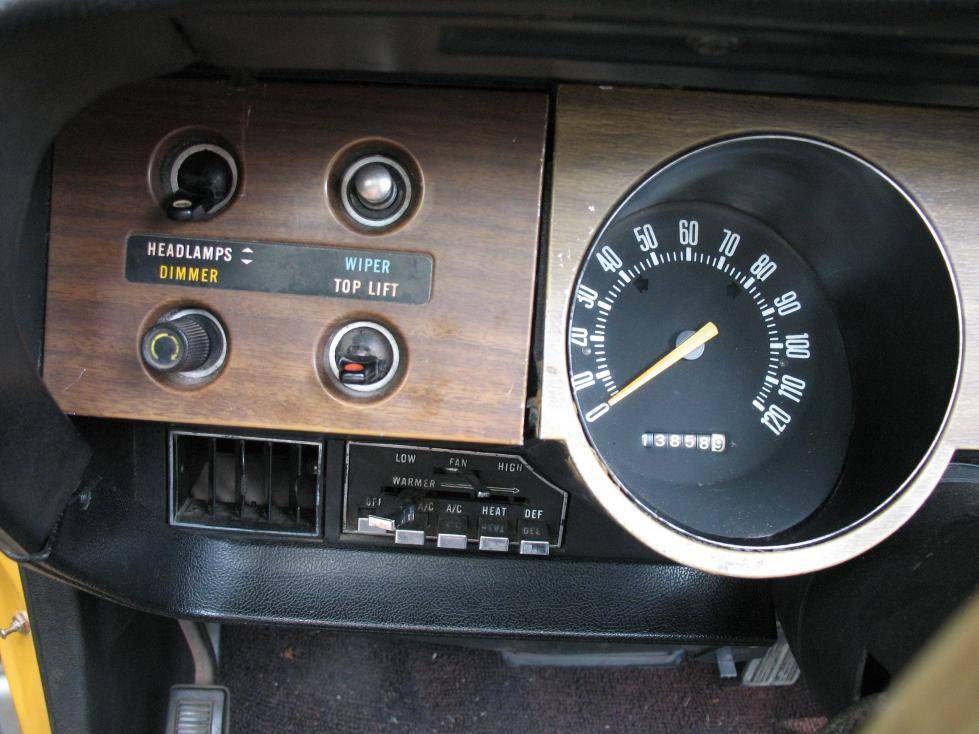

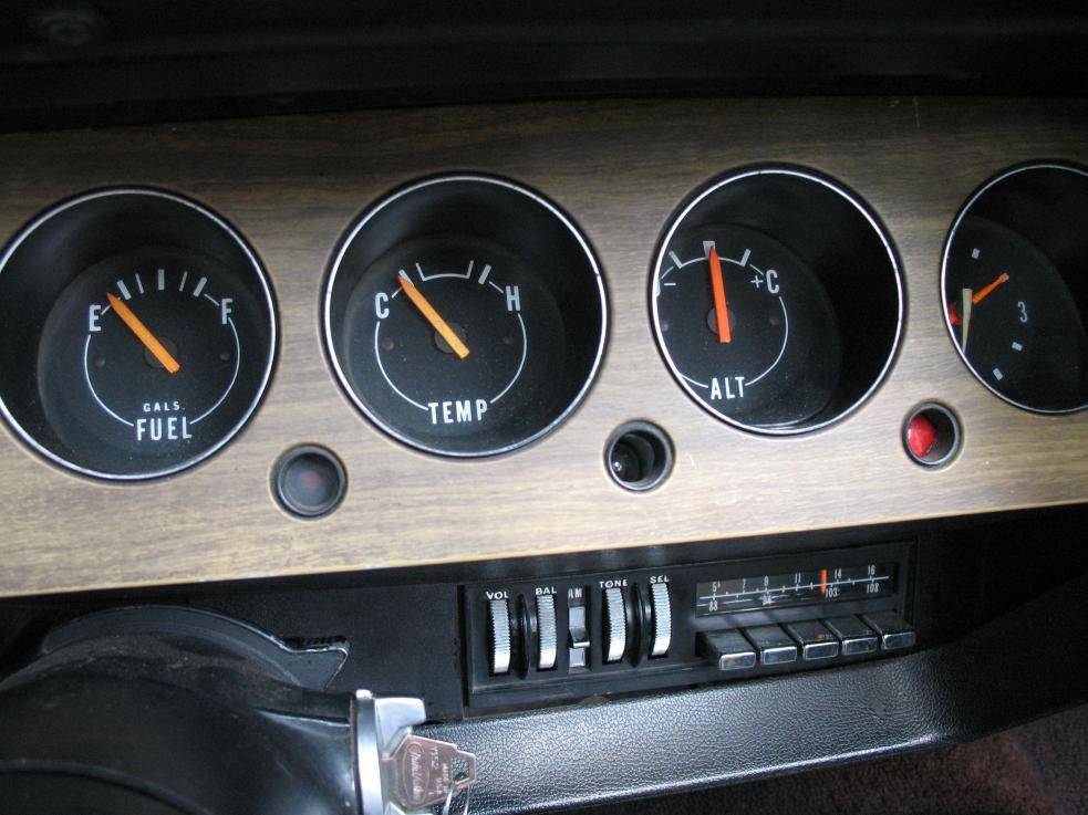

What is also weird is that the dash is non ribbed and the face of the gauges has a aluminum wood grain face. Is this not a 70 part, or were the 70 SE cars wood grain on the dash bezel.
Thanks
You have to have the key to take the glove box lock out. You lock the lock with the door open and it will give you access to a pin you can push down with a small screw driver to release it. I don't have a pic. Chryco or Burdur may have a pic. A wood grain dash was an option on any car except the R/T with the rallye dash cluster. The metal is somewhat a satin. If you have the ability to spray your own paint, I can dig out the PPG code for you. There are other paint colors that are close.
I was told that that the non ralley wood bezel applicay was a Barracuda Gran coupe thing only but it would make sense that it was an option in the SE Challengets as well.
Thanks guys, that helps a lot, my dash looks exactly tlike the the one pictured above.
