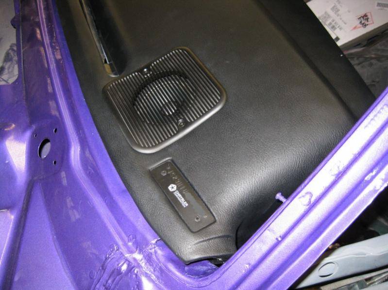

http://www.tcpglobal.com/Automotive-Paint/Hot-Rod-Flatz/?gclid=CMTsi4n1jcMCFRWRfgodLLwArg This Vin, and speaker grills, were sprayed with Hot Rod Flatz 201. The light on the speaker grill is a better representation of how this looks in person. There are other sheens available; I have also used Chassis black on other parts, but that would be too shiny for a VIN tag.
