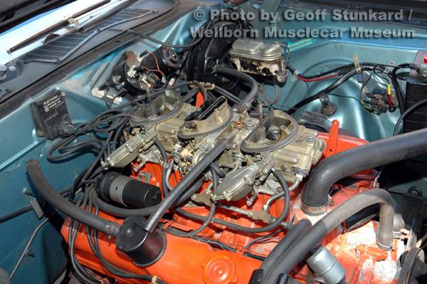

Actually not true.
AARs came with the standard cluster which would have meant a 2 speed wiper motor. If the car was optioned with the A62 Ralley Cluster, then the car would have the 3 speed wiper motor.
Here is a picture of one of Tim Wellborn's 340-6 motors with the 2 speed wiper motor.

Well how about that! Maybe the interference was just a B-body thing then.
You might be right, when it comes to B-Bodies with a 6 pack. That would take some research for me to safely say. Then I'm sure that we have someone out there that already knows that one.
