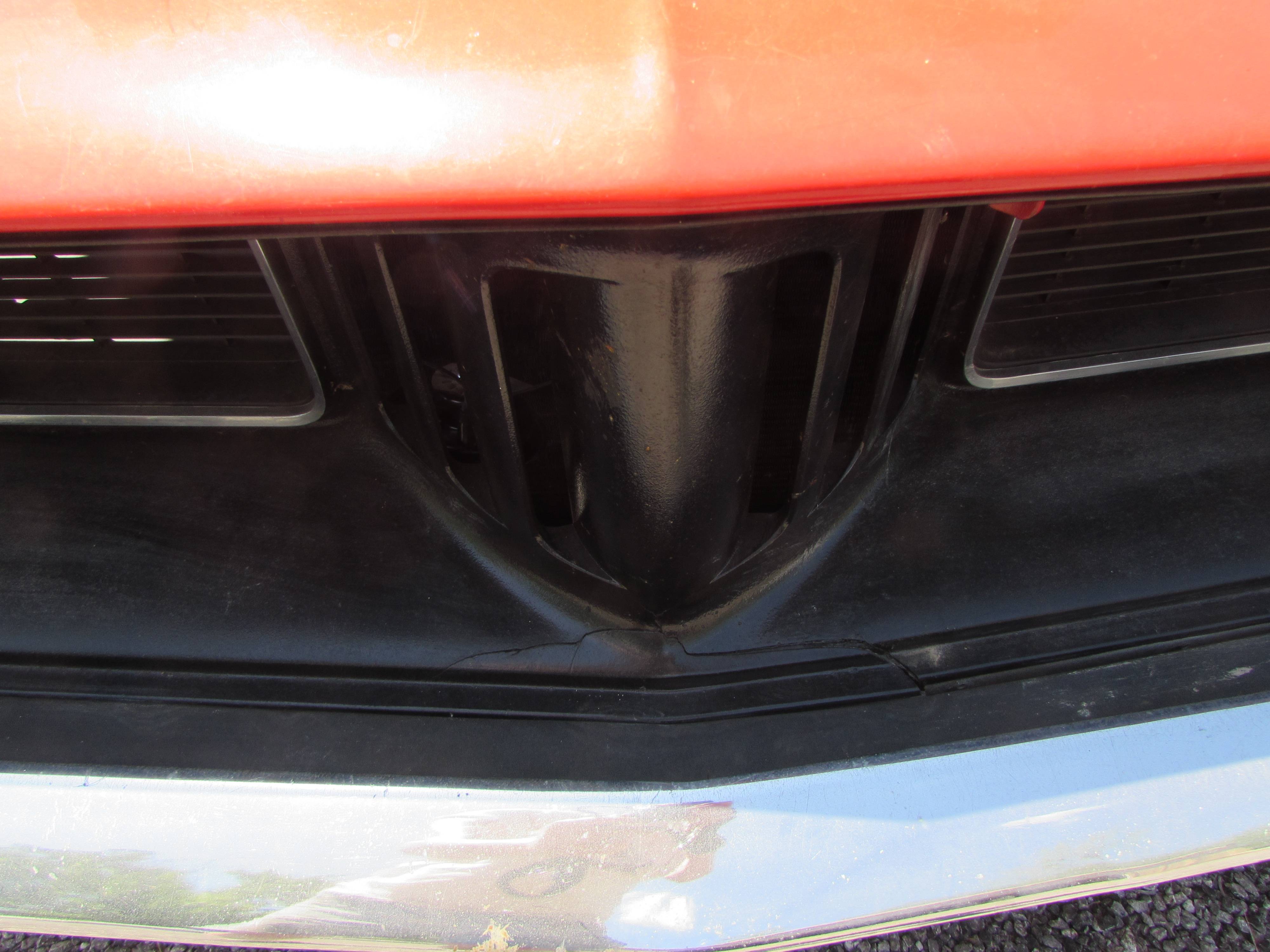

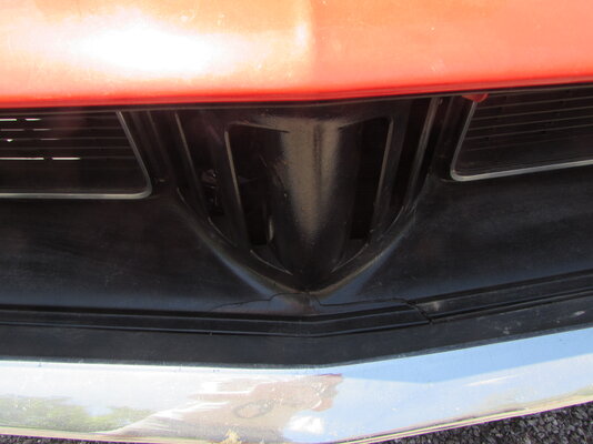

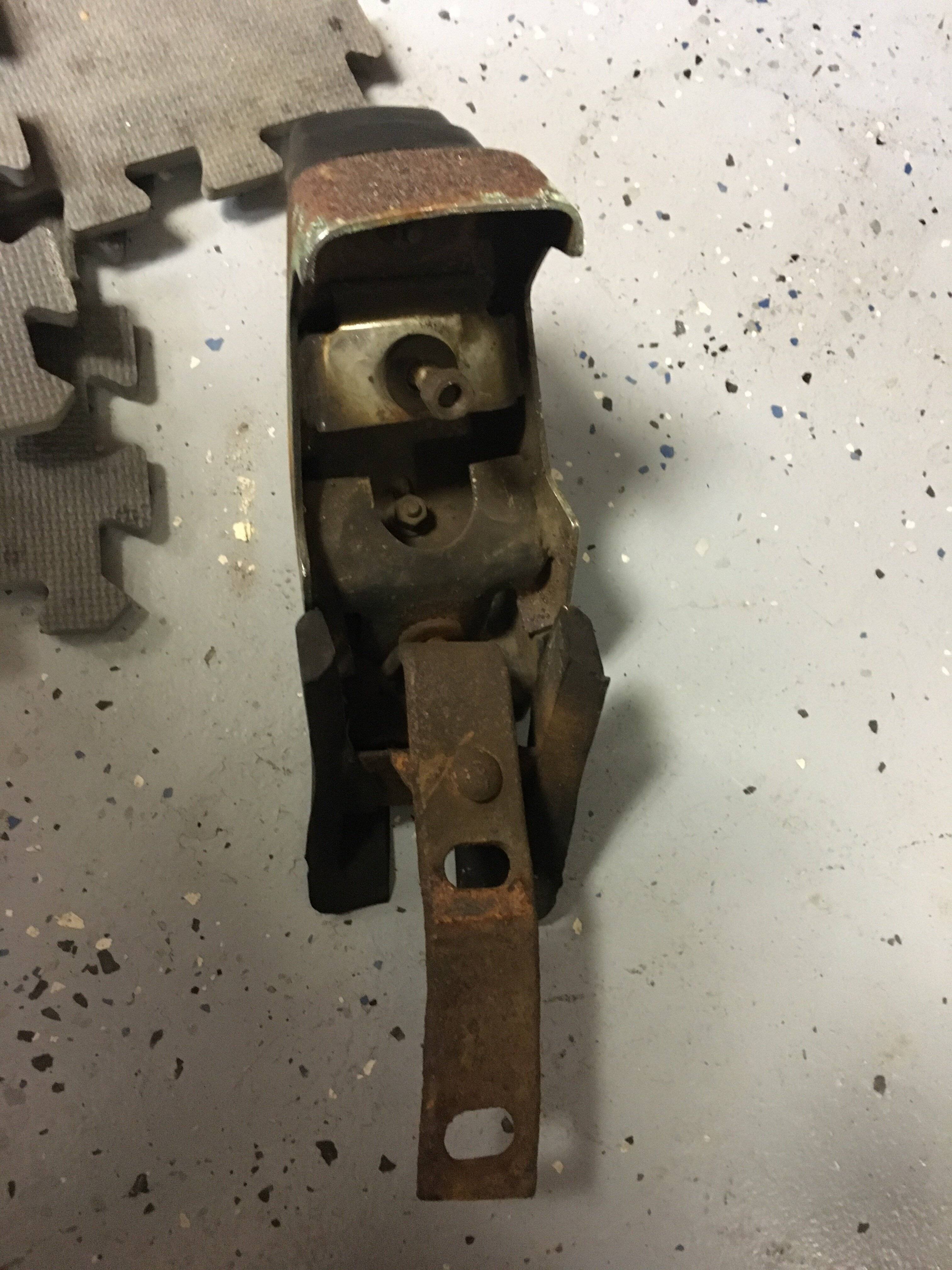

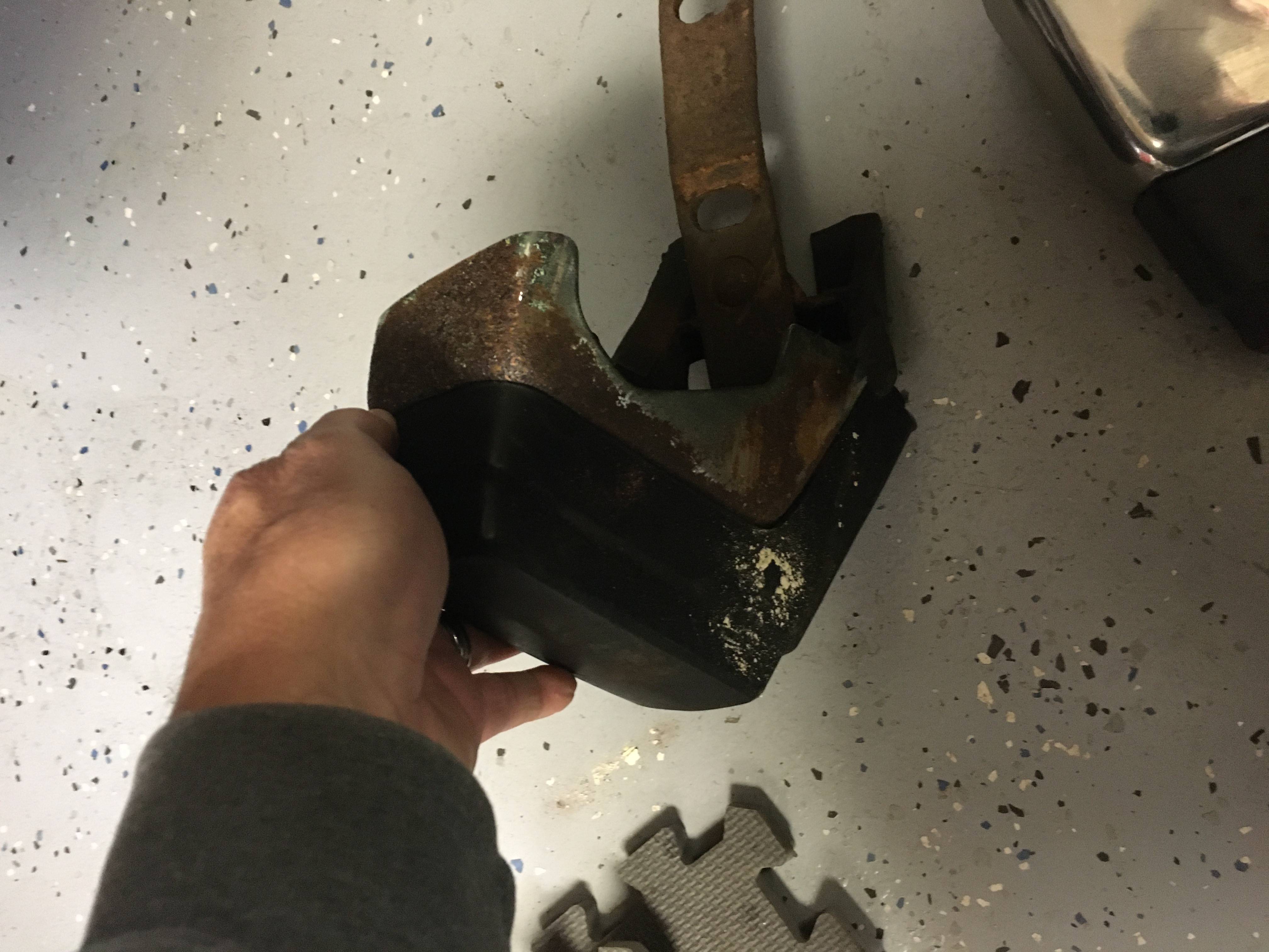

Here is a picture of my dad's 360 Cuda which has the stock bumper brackets. You can see how Mopar used filler pieces to cover the gap that was created by the bumper brackets being manufactured to move the bumper away from the body. It really is pretty ugly and a lot of people will put on 70-72 brackets to move the bumper closer to the body.
View attachment 91140Here is a picture of my dad's 360 Cuda which has the stock bumper brackets. You can see how Mopar used filler pieces to cover the gap that was created by the bumper brackets being manufactured to move the bumper away from the body. It really is pretty ugly and a lot of people will put on 70-72 brackets to move the bumper closer to the body.

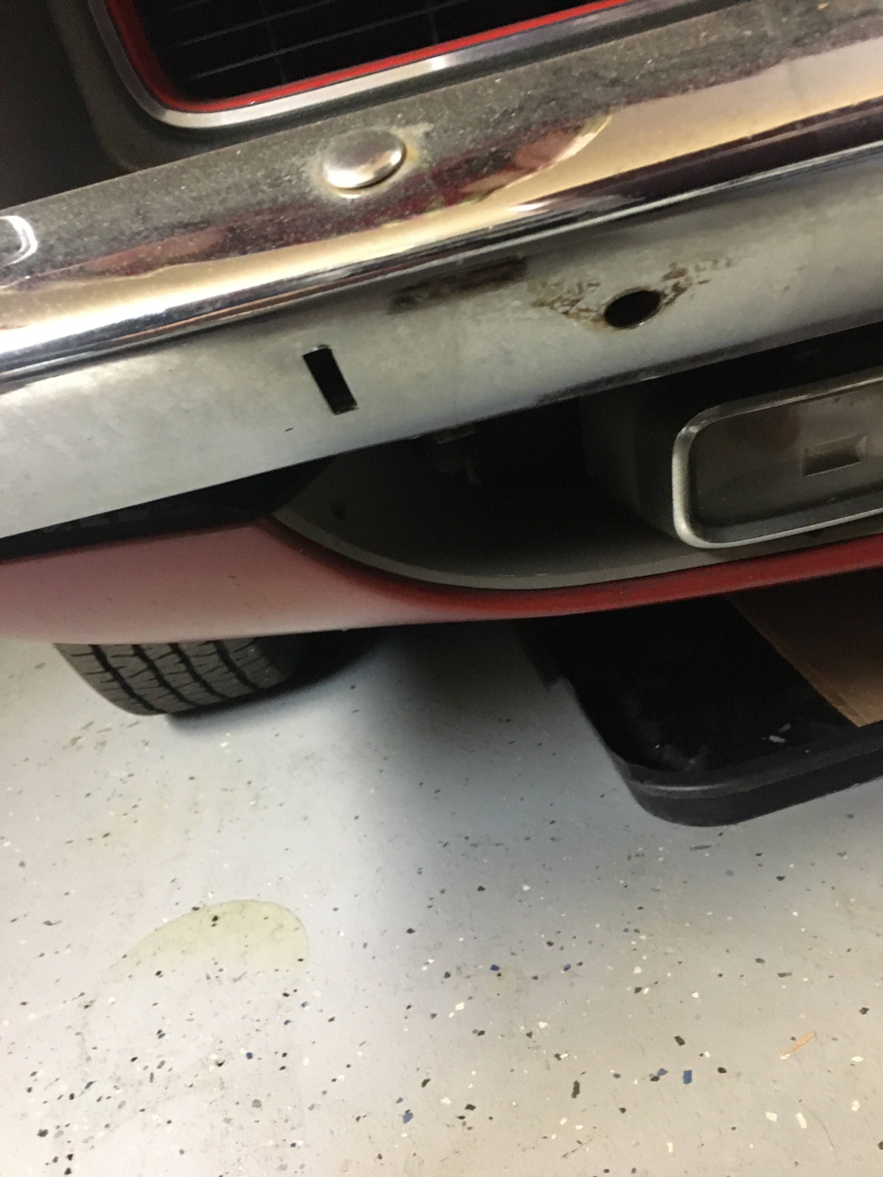

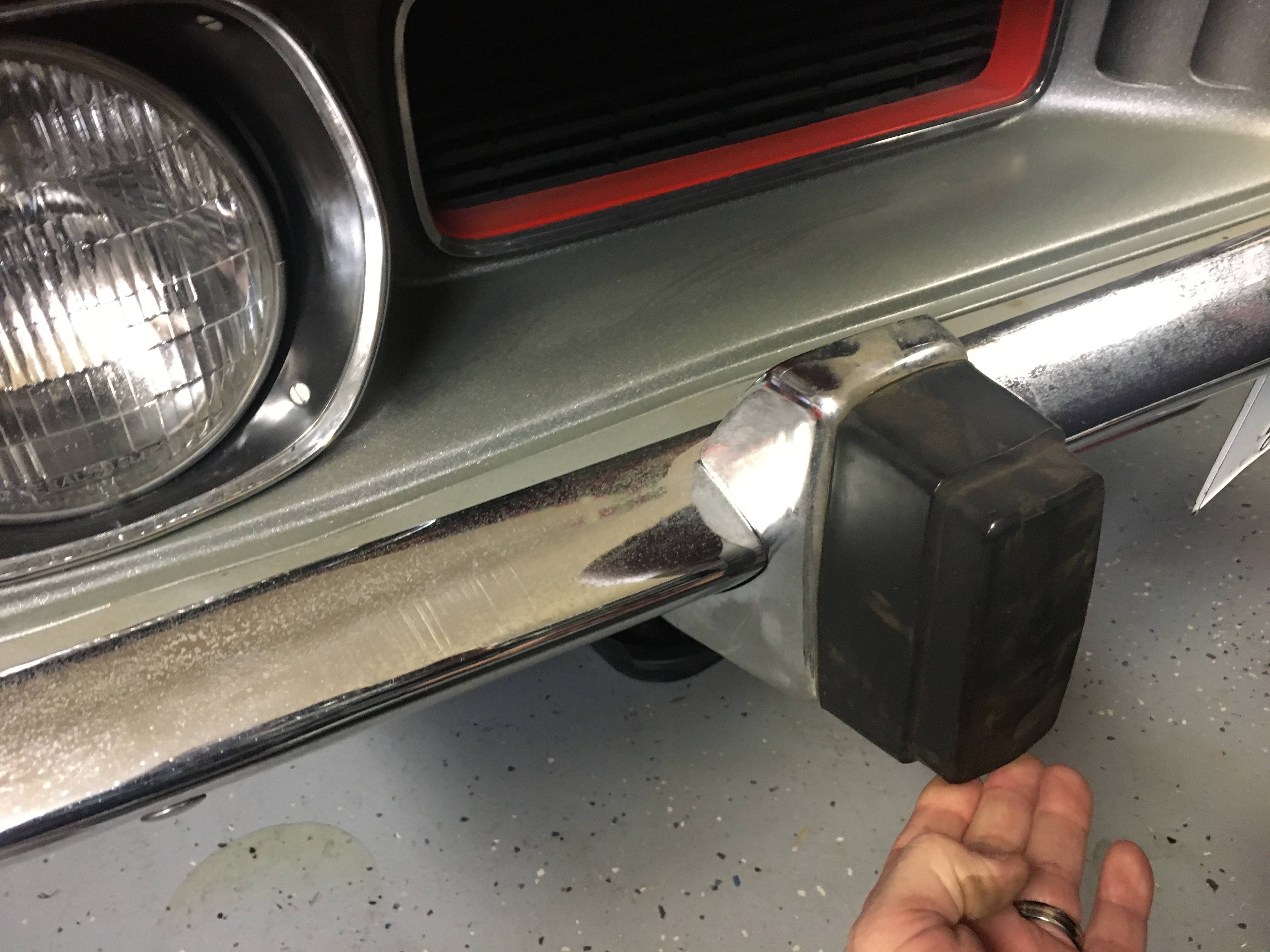

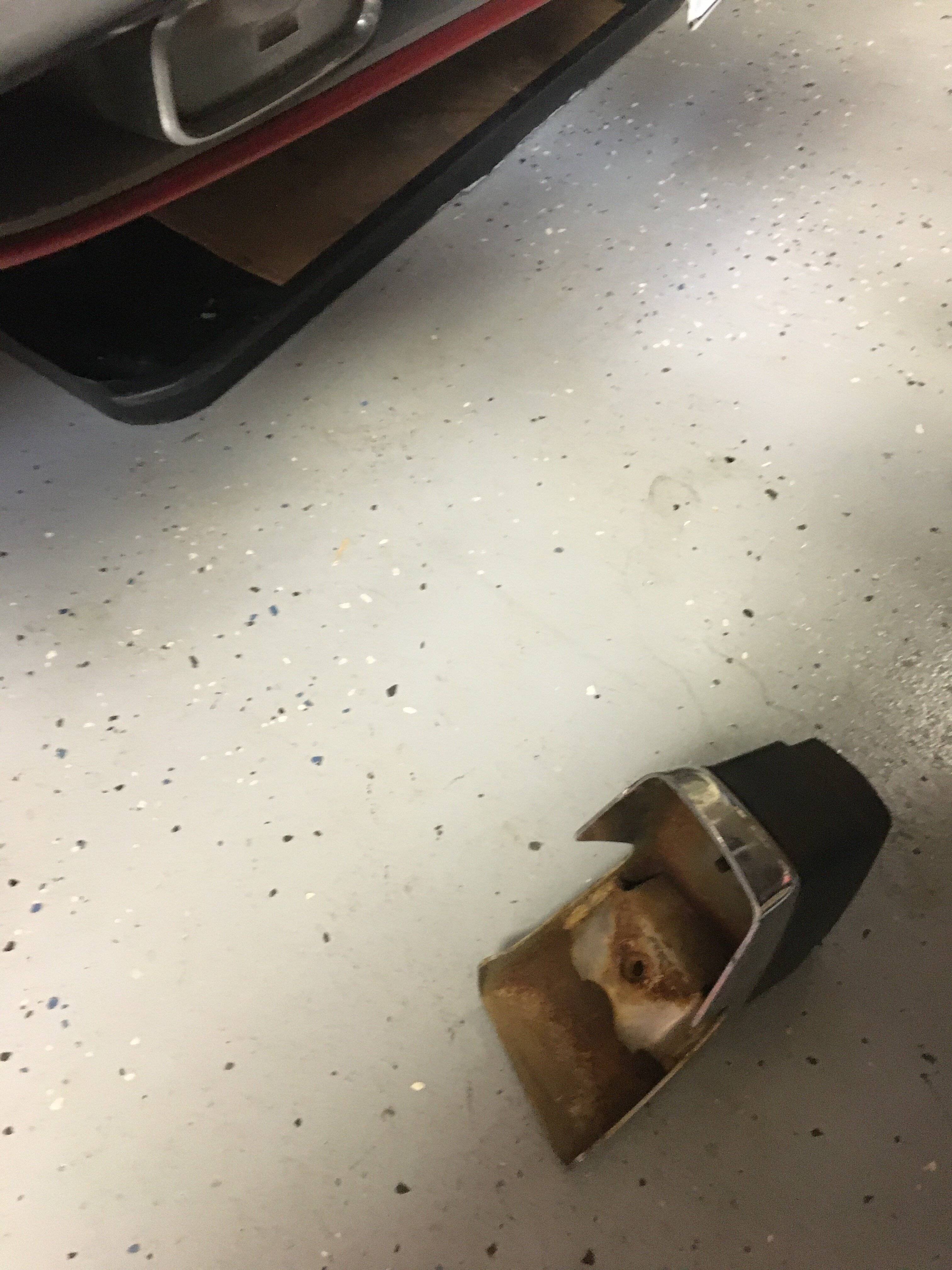

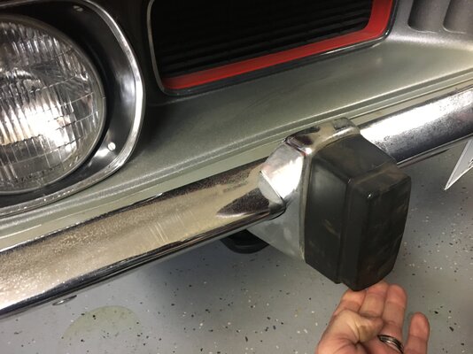

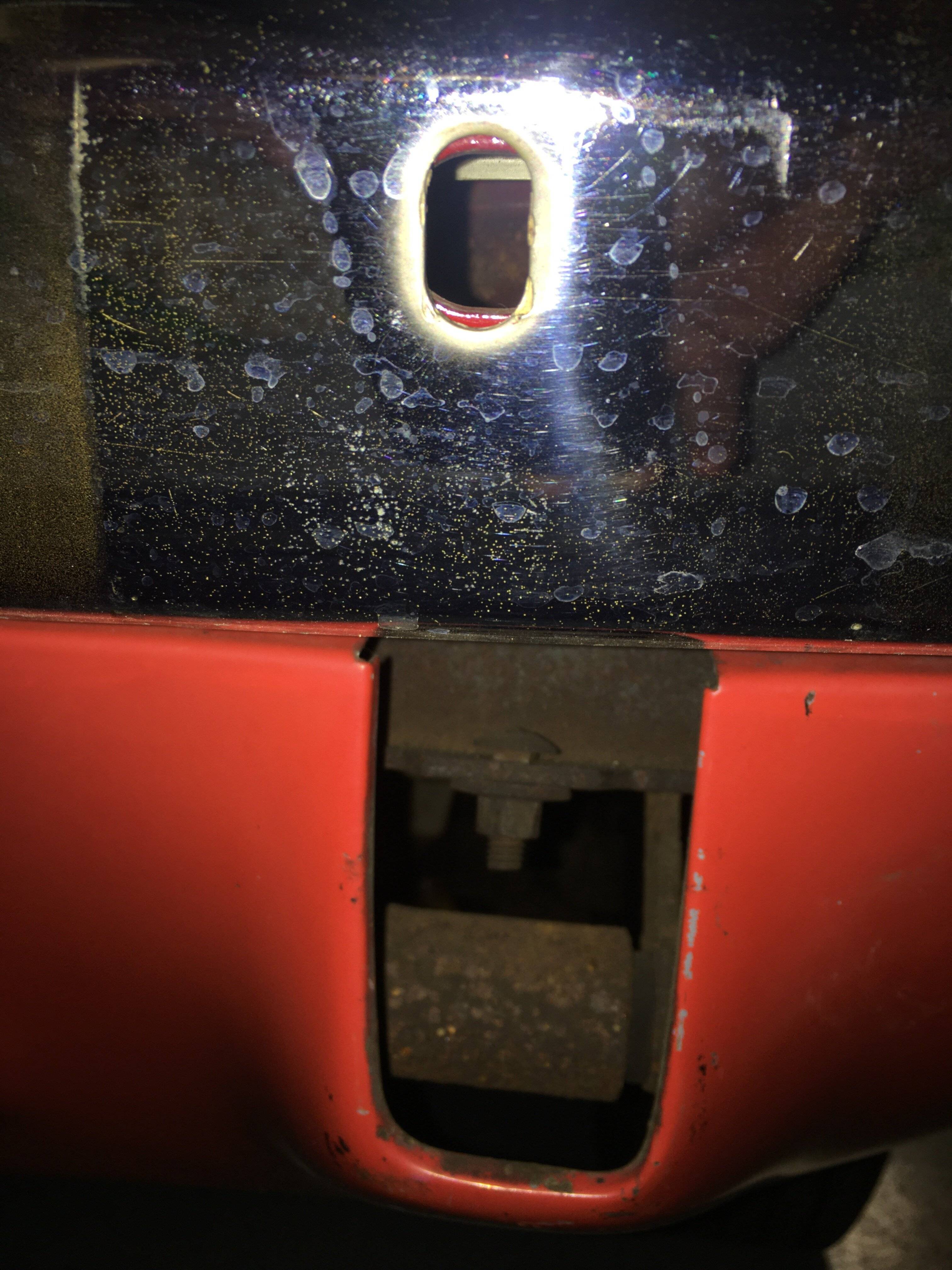

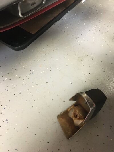

Here are some pictures off my 73 Cuda. Front one.

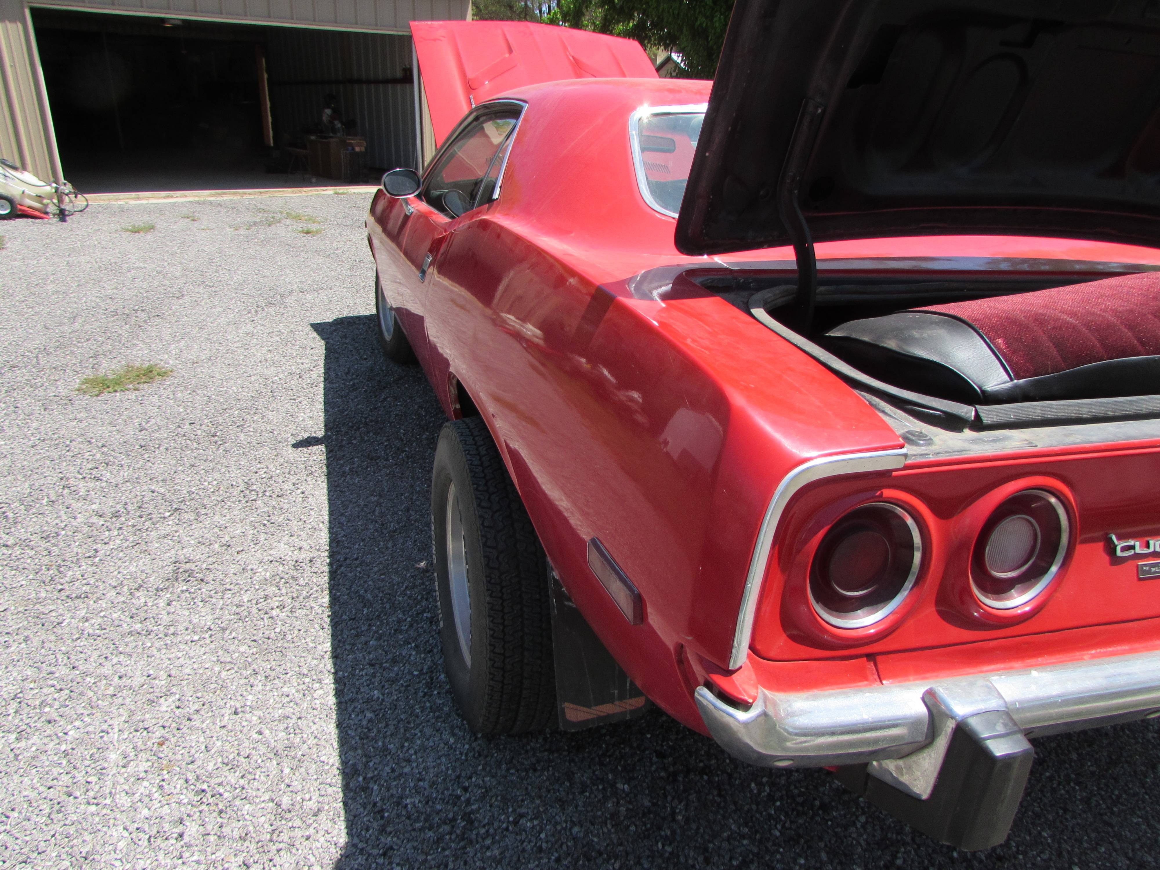

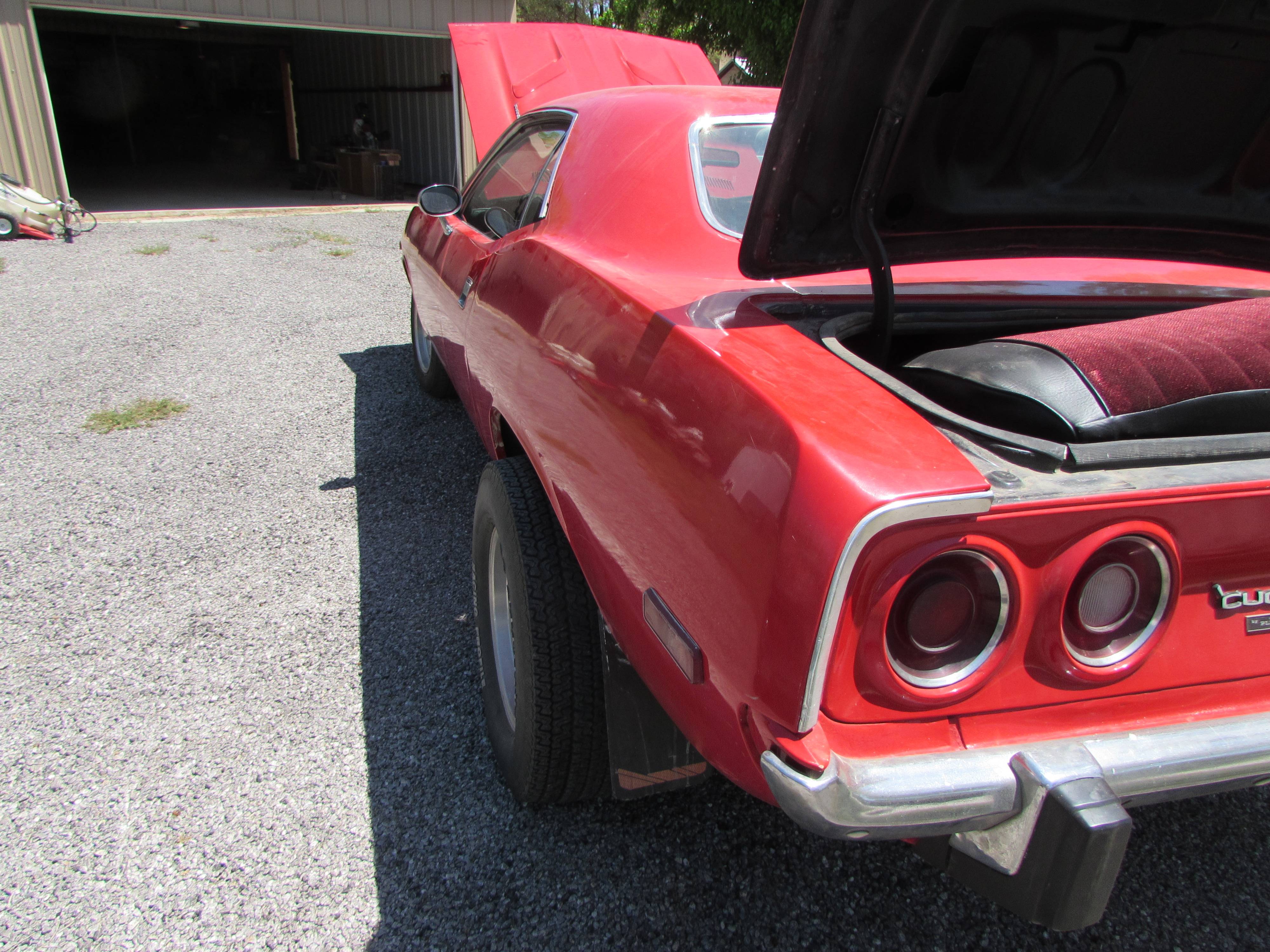

Here is the rear one.
