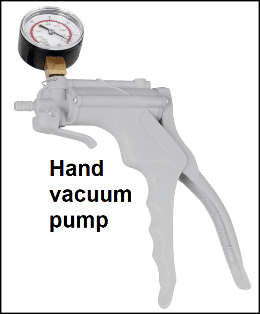

While a friend and I were carb adjusting to make my car idle nice he found that the distributor's plate wouldn't budge until 17.5 in/Hg of vacuum. When the distributor was rebuilt and tested advance would start at 7 in/Hg. The vacuum module/diaphragm is fine, holds vacuum no bleeding. The tool he was using is similar to the pictured one. The distributor is a Mopar electronic one.
That's the issue, why does it now take so much more vacuum to get the advance (plate) to start moving? Do those plates eventually bind through time? TIA, John
