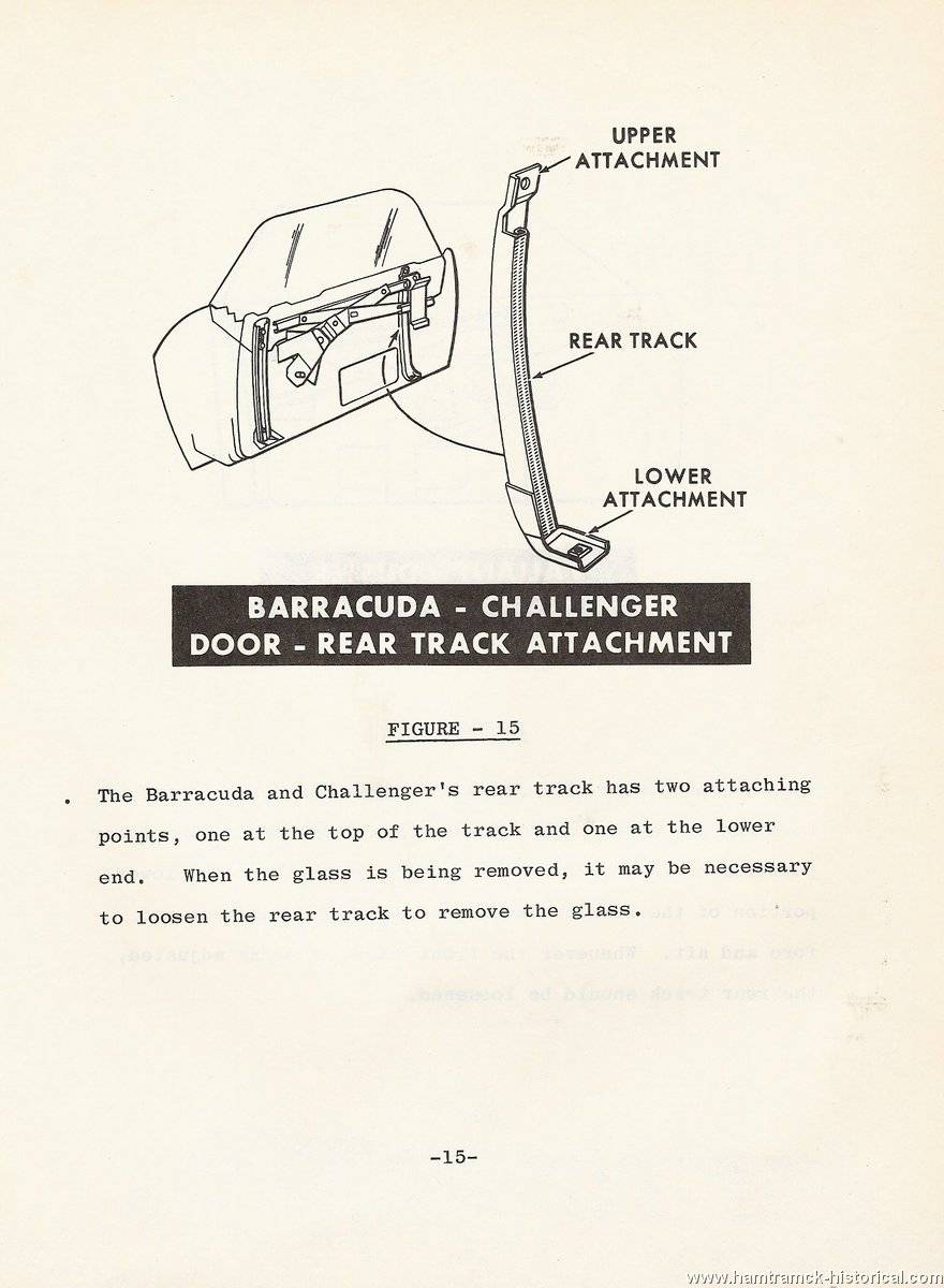

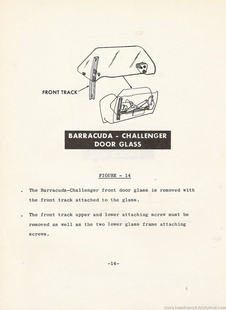

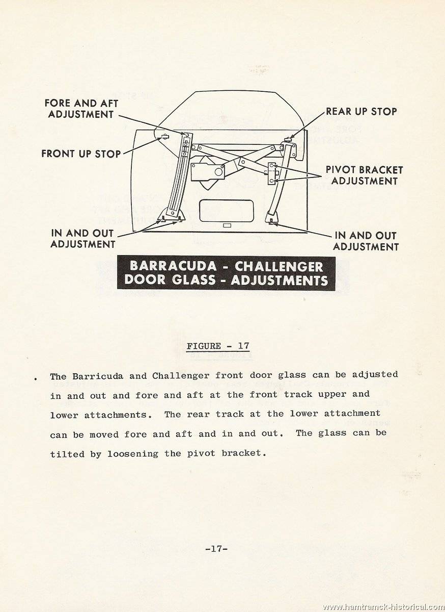

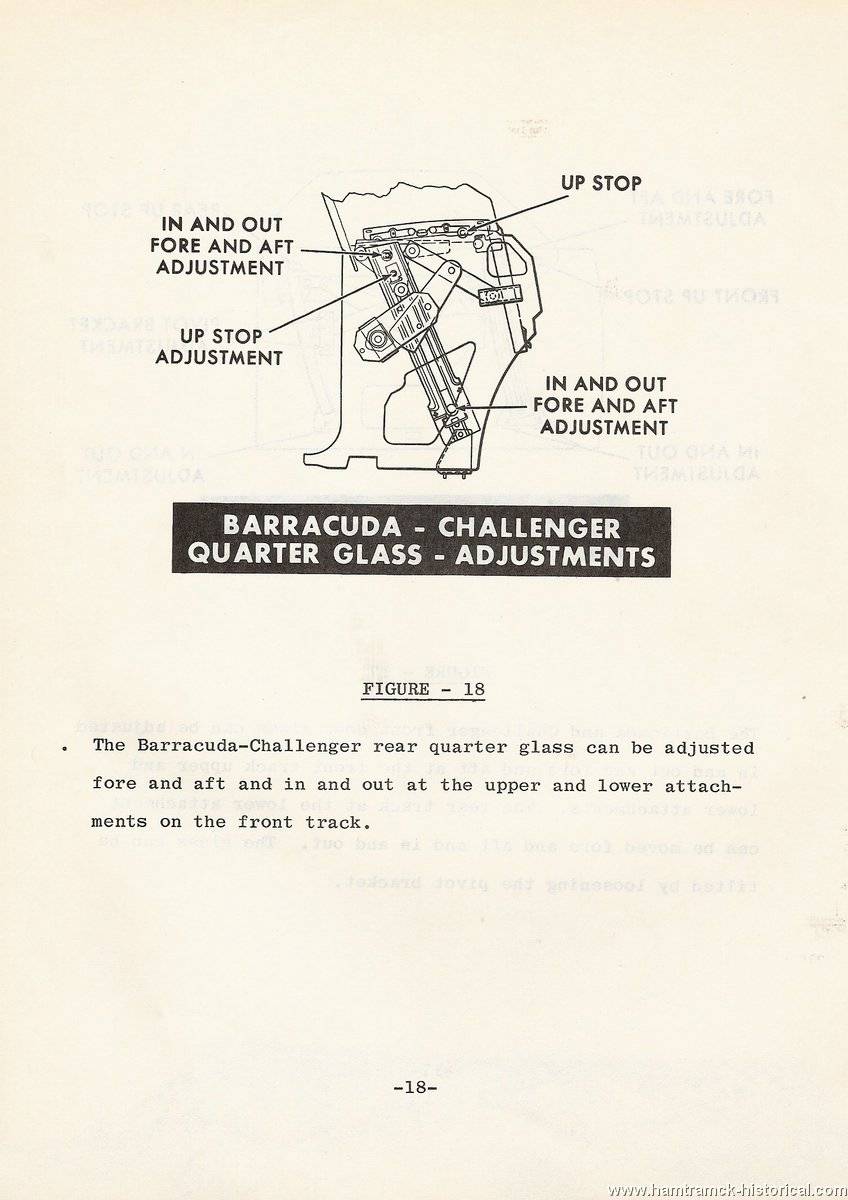

Thank you. Yes it is useful however I am still not sure what the pieces look like. So hopefully someone has photos of them on the glass and brackets

Ok hope this helps. if you need something use the search in the upper right. It's probably there. That's how I found this. took about 15 min.
