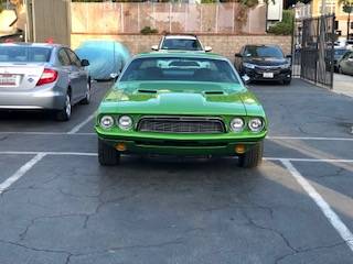

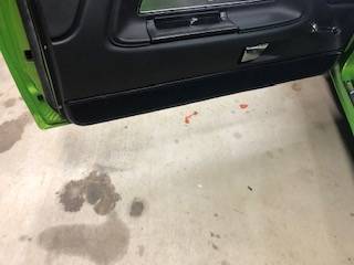

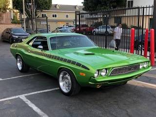

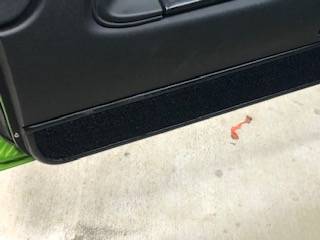

Well after many hrs of piddling around with it. Its in and fits nicely. Even added the carpet trims I've had laying around for years! Its really nice when after years of work to finally finish it. I know there is always something to do. Mine is done and I cant wait to turn the odometer around and around. I appreciate all you long timers helping throughout the process!
