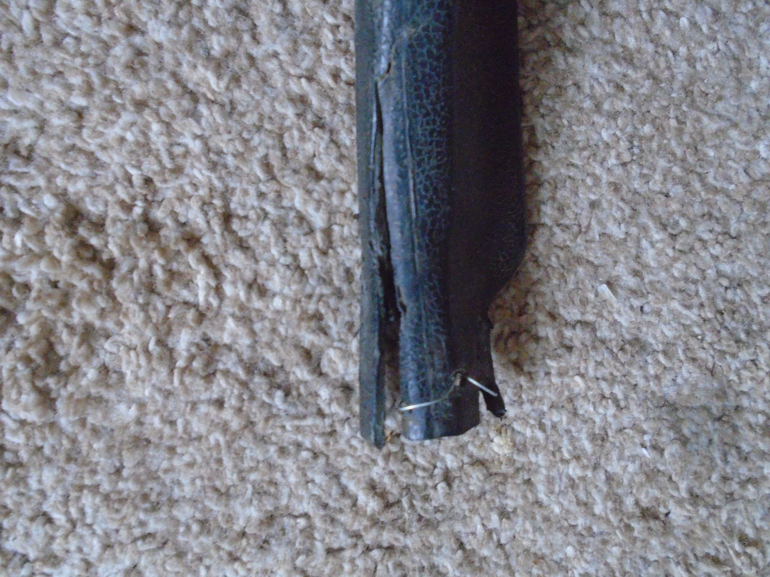

Door panel repair
pschlosser
Dec 8, 2022
681
263
Santa Rosa, California
What is the best glue to use on this kick panel repair? My attempts to repair in the past using PVC, model styrene and ABS plastic glues have failed miserably.

Thanks Moparlee. It looks like it might do the job for Pschlosser's panels. Good to know you have used it successfully.

I use some epoxy from believe it or not, from Harbor freight and it worked where the brand names fails. fix someone's fan shroud. It dried a semi transparent yellow. I'm like SOB! Maybe this will help.

I have also used the JB Weld Plastic Bonder with success on various plastics. I rough up the hidden back surface before applying and if it has stress, I may add some mesh and coat over it. Just some things I've done.

I used this stuff on several plastic repairs; it’s very strong and sets in minutes. It has the ability to flex a little, unlike most epoxies. It is expensive, but one order will repair several items, and has a good shelf life if you store it properly.
