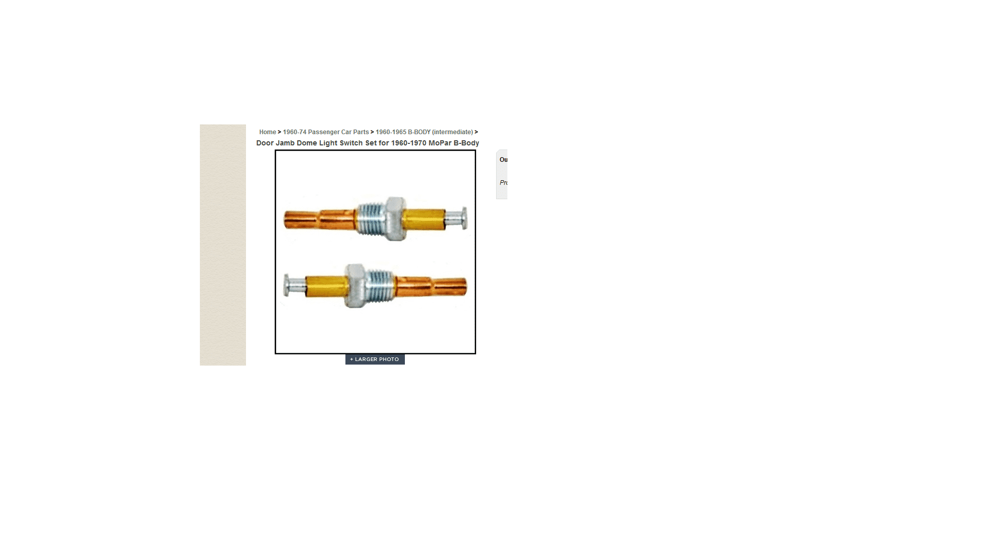

Hey guys..so for the longest time, I've not been able to put bulbs in my interior lighting, down at the corner of the convertible trim panels. I put a whole new rear light harness in a couple of years ago, thinking I just had a short somewhere and the lights wouldn't turn off when the door was closed. I had tested the door switches multiple times, each time they seemed to ohm out properly with my meter. Well, I finally gave up and let the shop do it and they found... BAD SWITCHES!! It turns out the switches (appeared to be the original factory ones) can fail internally, having a plastic slide insert (insulator) inside the switches, that can make them short to ground.. WHO KNEW? I attached a picture here for reference for the switches I'm talking about. These are not likely the ones they used, but they were able to find them close by at a local auto shop. FYI, don't trust your door switches...!! Even if you test them. they could still be bad!

Thanks for the alert. It's weird that your meter didn't detect the short though. A couple FYI's: Vans Auto sells reproductions and, I think, it was in 1972 that the E-bodies went from a 2 prong to a 3 pin switch.
