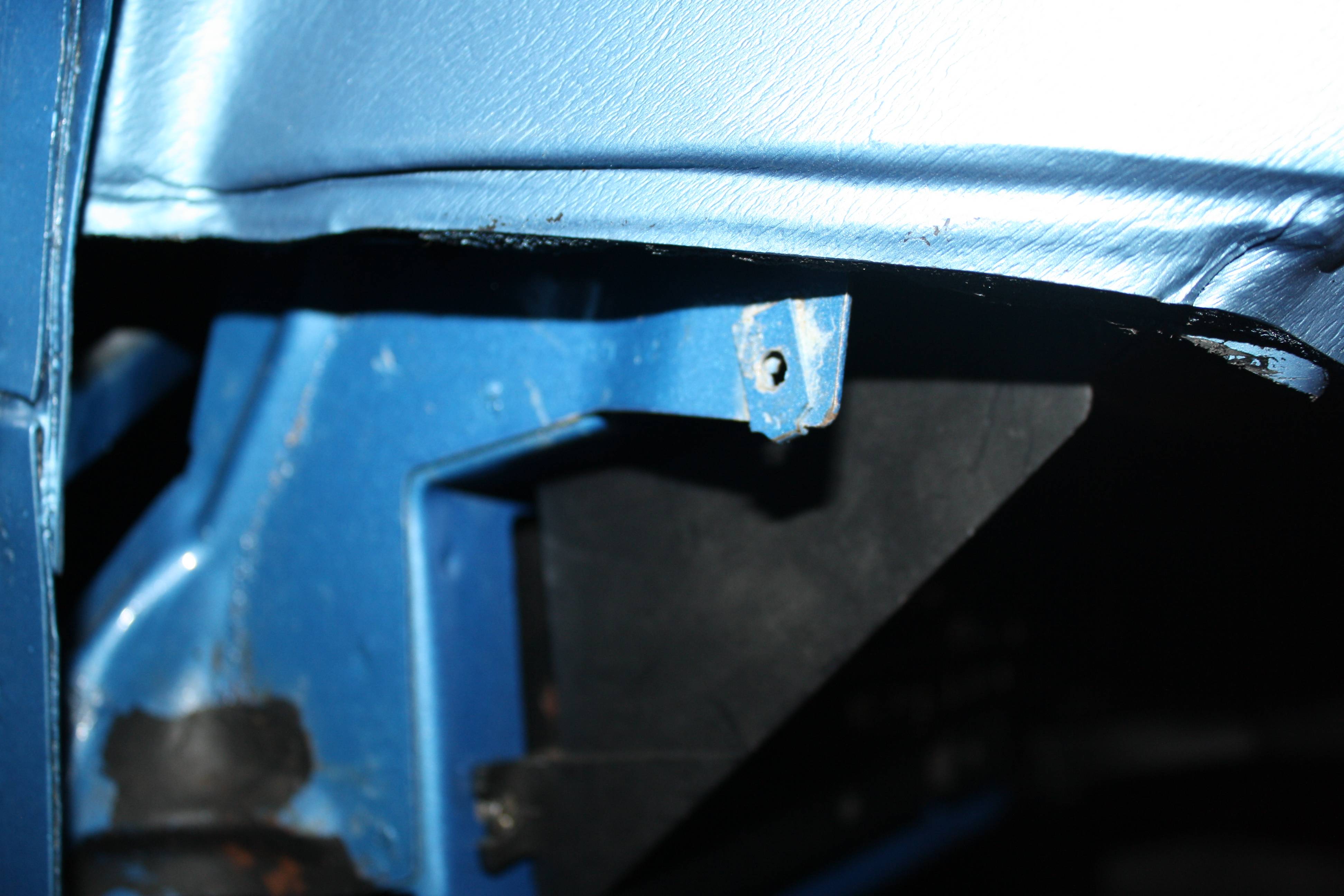

driver's side trim ,trying to install trim piece on my '71 challenger--original piece. there must be some sot of bracket that attaches to this boss--
michael bucklew
Aug 24, 2019
310
39
michael bucklew
Aug 24, 2019
310
39
follow up from post there must be some sot of bracket to attach to this boss--there is nothing for the side screw to go into and on the trim upper left, there is nothing to screw to

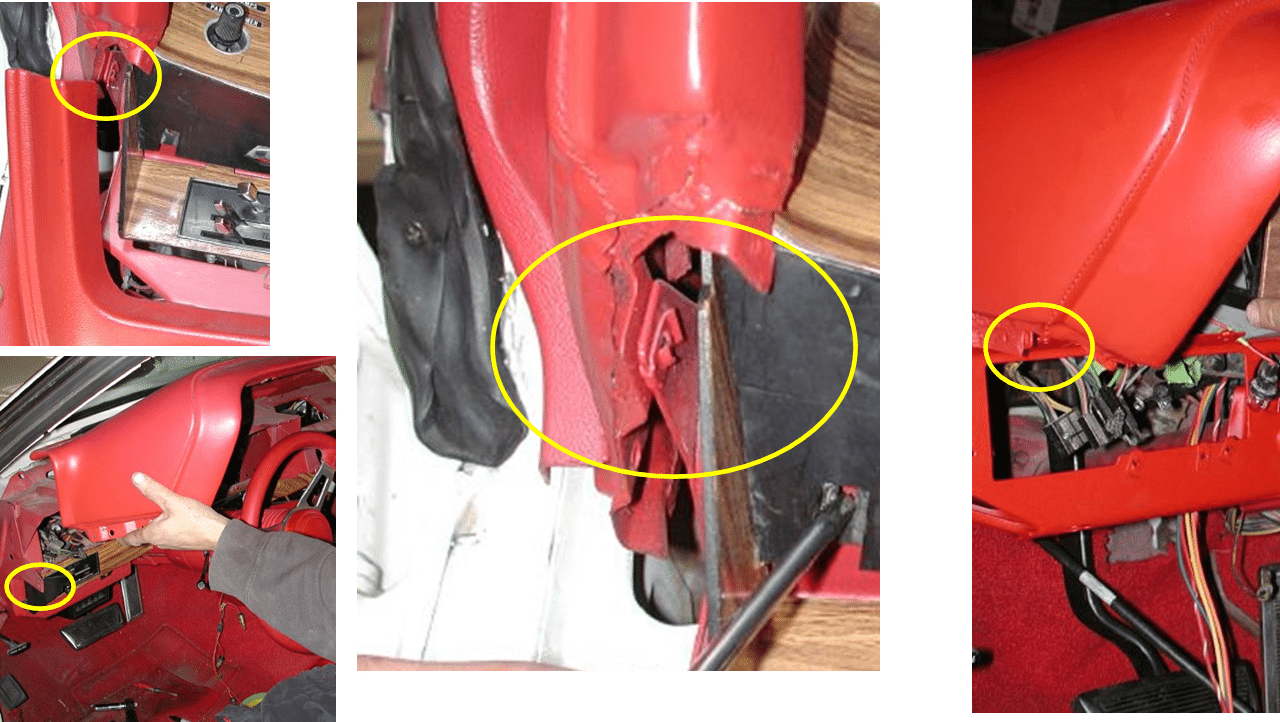

Maybe someone can elaborate on what attaches to this location. It looks like the dashpad's metal frame should attach there and then is covered by the plastic trim piece.
MoparCarGuy
Jun 28, 2020
717
612
You can see the dashpad's metal frame (with hole) in this video.
Go to 1:44 and again at 1:50.
michael bucklew
Aug 24, 2019
310
39
thanks. clears up the problem---the "new" dash pad, guaranteed to fit does not have the attachments and there is a large gap between dash pad and trim piece

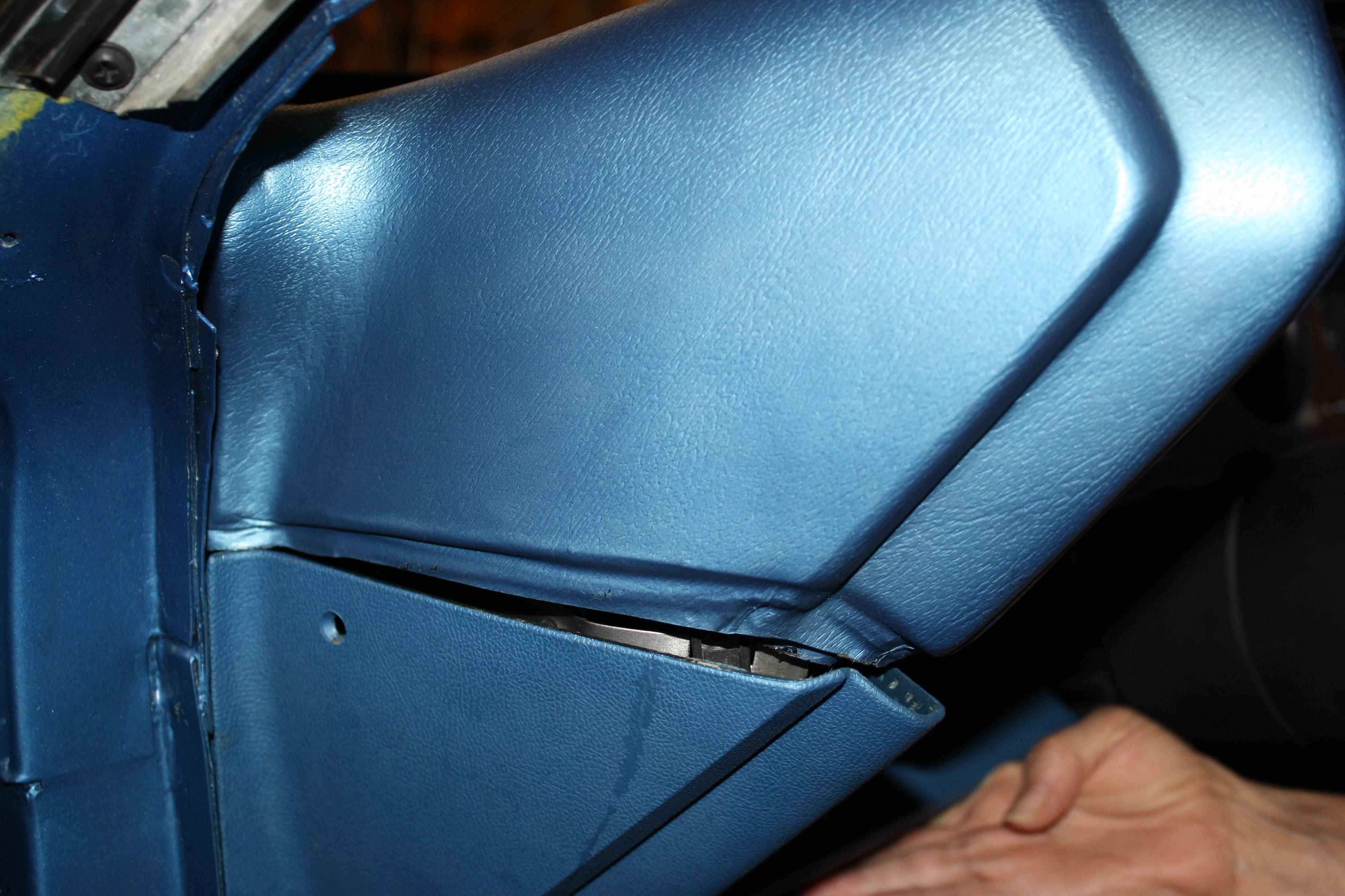

Post a pic of your trim piece. It may be the wrong year for your car.
challenger6pak
Feb 27, 2011
4,075
920
Take a pic of your trim where it is not fitting the dash. Take a pic from the side. We can figure it out if we can see it.
michael bucklew
Aug 24, 2019
310
39
missing the screw clips and as you can see it is a flawed piece--original trim---sent pic and email to classic ind., yet to hear from them. passenger side is a very good fit. the tim piece is in the correct position
