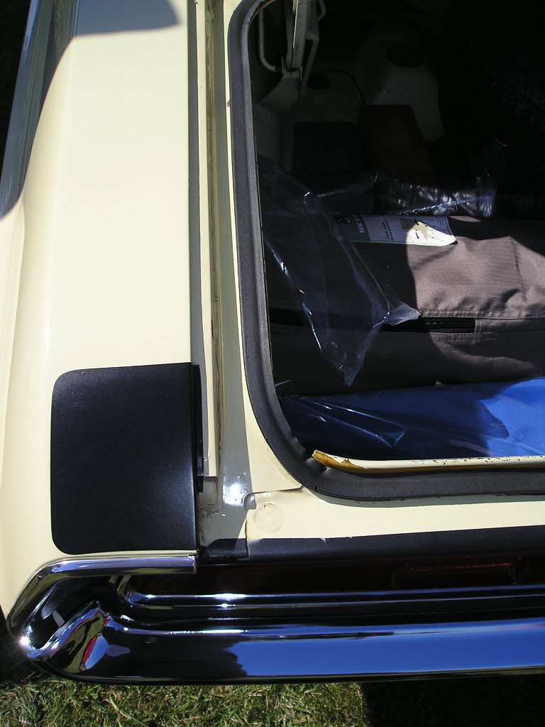

How the factory did it in the photos below. I'd try to reproduce what the factory did whether or not it's original.

It surprised me as well when I saw one years ago at a car show. Kinda makes sense though.

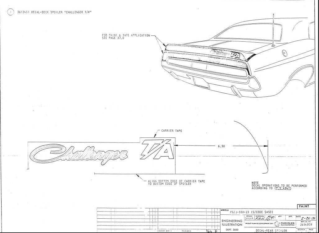

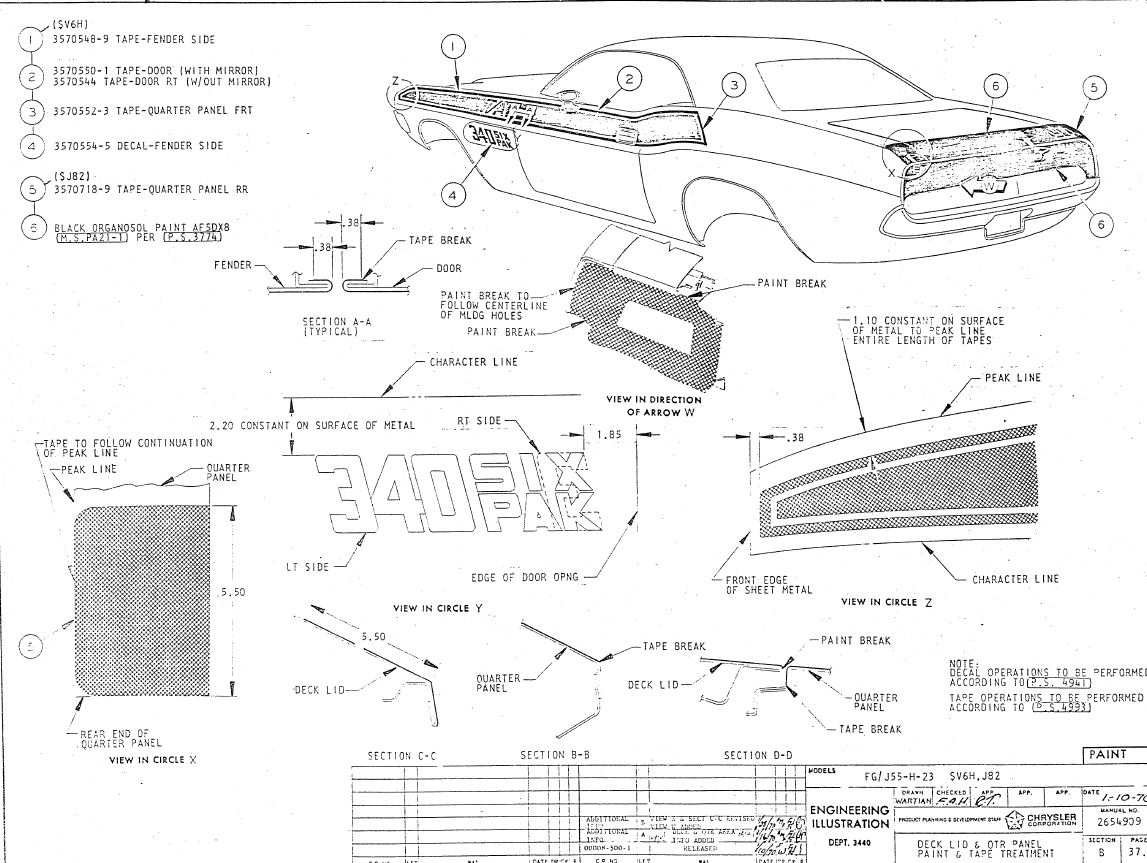

Look closely at the engineering drawing for the T/A Challenger decals & blackout paint. The quarter panel (Circled Item 5 and detail circle X) has a black decal, not paint. The decklid (Circled Item 6) has blackout paint. The painted decklid was not a full blackout under the spoiler. It was only to ensure that no body color showed between the spoiler and the moulding.

Note the second engineering drawing below refers to "FOR PAINT & TAPE APPLICATION SEE PAGE 37.0".
