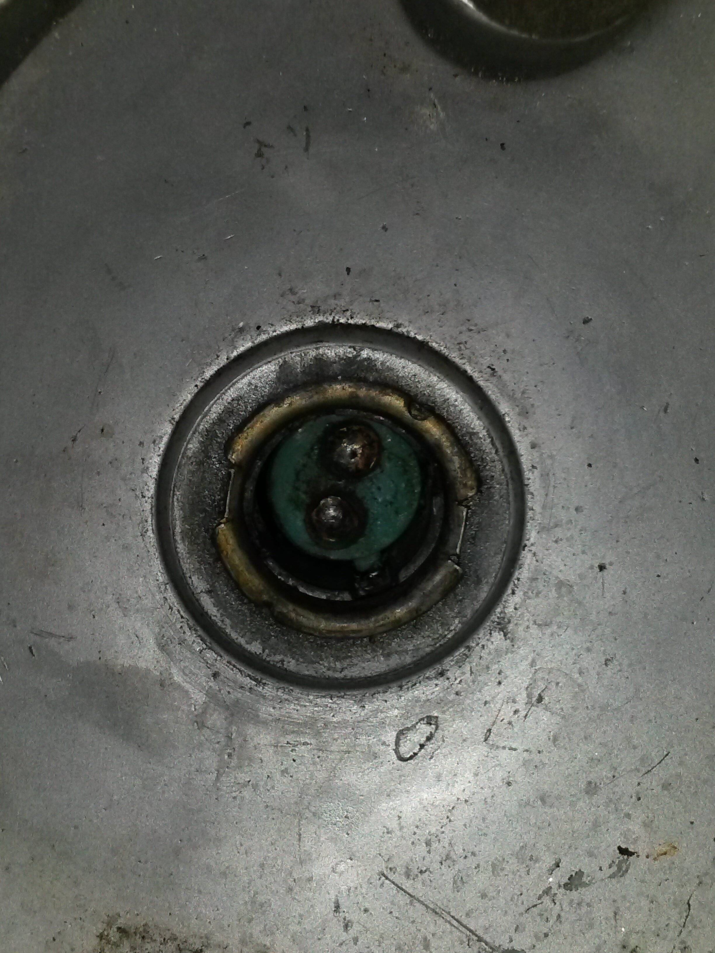

Hey guys its been 30 something years since i was running the streets of west texas cruising from the sonic down to the end of the drag chasing girls. I swear that when the parking lights were on the 2 lights in the front valance used to light up as well as the the side markers making for a cool look whist hanging out watching the girls drive by in their cutlass supremes etc. I put an american auto wire update harness in it. I know its only got the 2 pins and a single filament, but i swear that's what i remember. Now only the side markers light up when the switch is in the park light position. is it me or did the harness change this.

socket

Yes the front valance lights should be on with the park lights , you may have a ground problem due to corrosion between the socket & housing , a center punch peening the socket to the housing may restore the ground .
