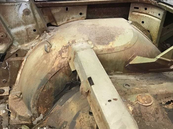

Looks like there is a cap over the inner wheel house to strengthen the structure. Attached is a picture of a 71 Barracuda wheelhouse.
